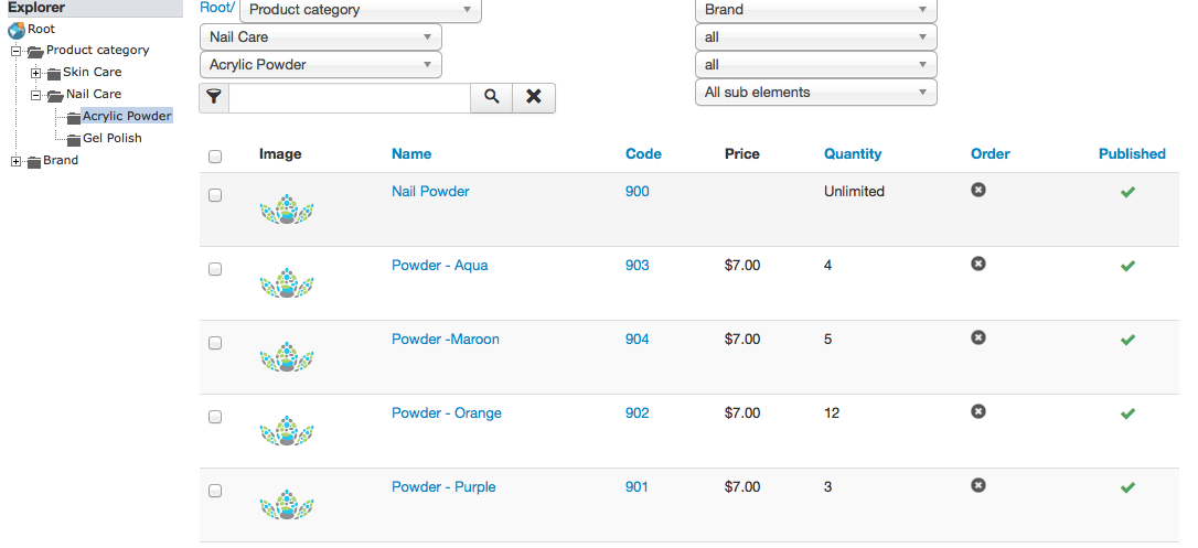

I have attached a sample csv of the best I have been able to come up with yet. You will see it creates the following:

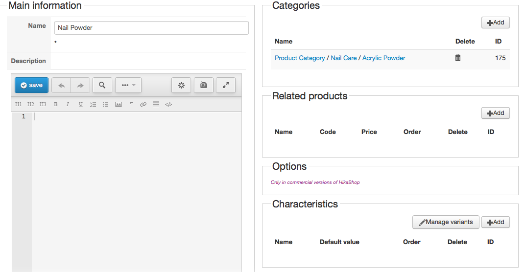

The main product and 4 variants for Gel Polish are created in the proper category each as a separate product, however on the product page the variants are not listed.
I attached screenshots showing the product listing and the main product page in the Hikashop backend.
Am I way off base on how this should be done? Is this something that should be handled by the options setting instead of variants or characteristics?

1. Yes, this can be imported automatically.
2. Which means that the problem lies in your CSV format.
You're actually pretty close of the solution. You're just missing the default value of the characteristic for the main product rows in your CSV. Specify it and after you import the CSV, you'll see that the characteristics do display for the product on the product page.

Thank you for your prompt response. I'm glad to know that I am close to the solution!
I think I understand your advice. However, what would I use as a default value? Choose one of the colors? or is there some other option I should use?

Yes, you need to choose one of the colors. The one you want to see pre selected in the characteristic dropdown on the product page.
