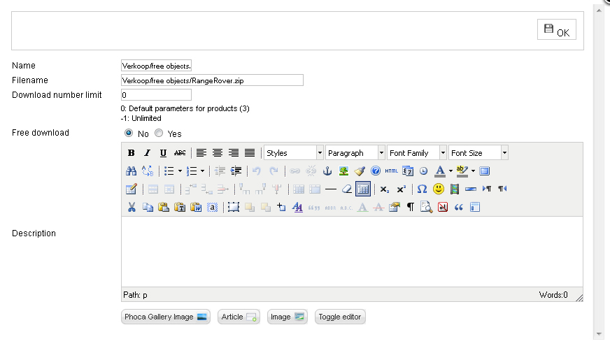

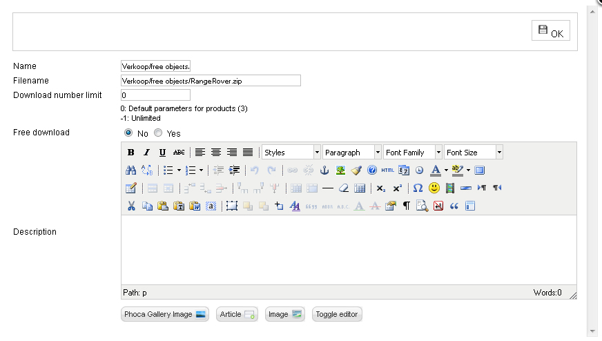

HI Jerome,
Thank you for your fast reply.
I added some screenshots.

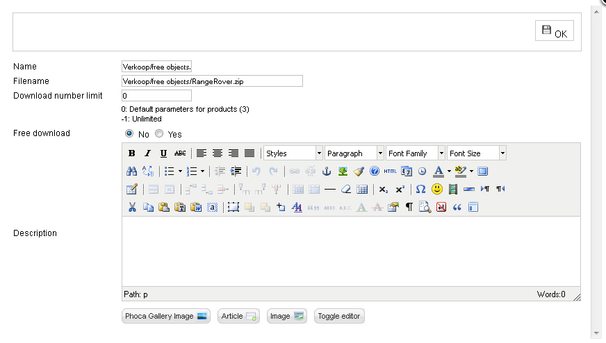

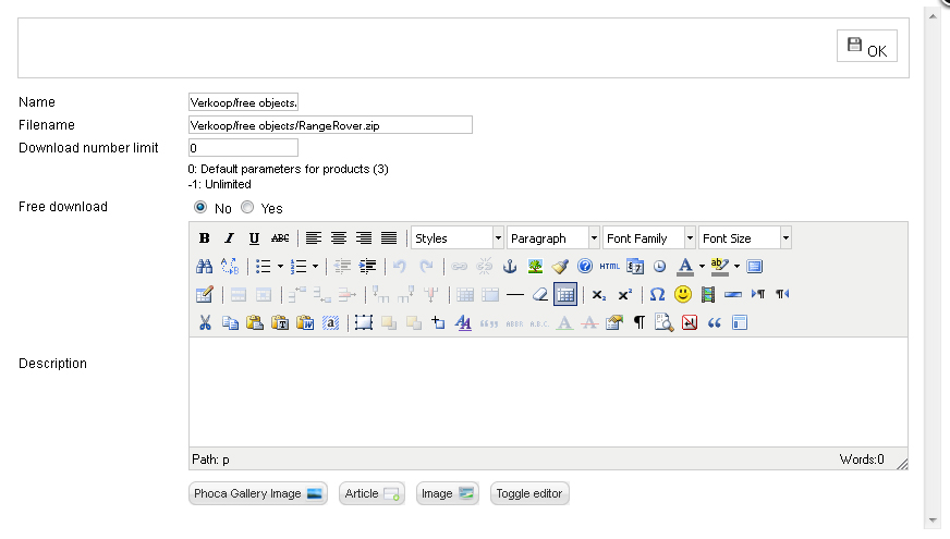

Old filepath.jpg shows the original path of the downloadable file.

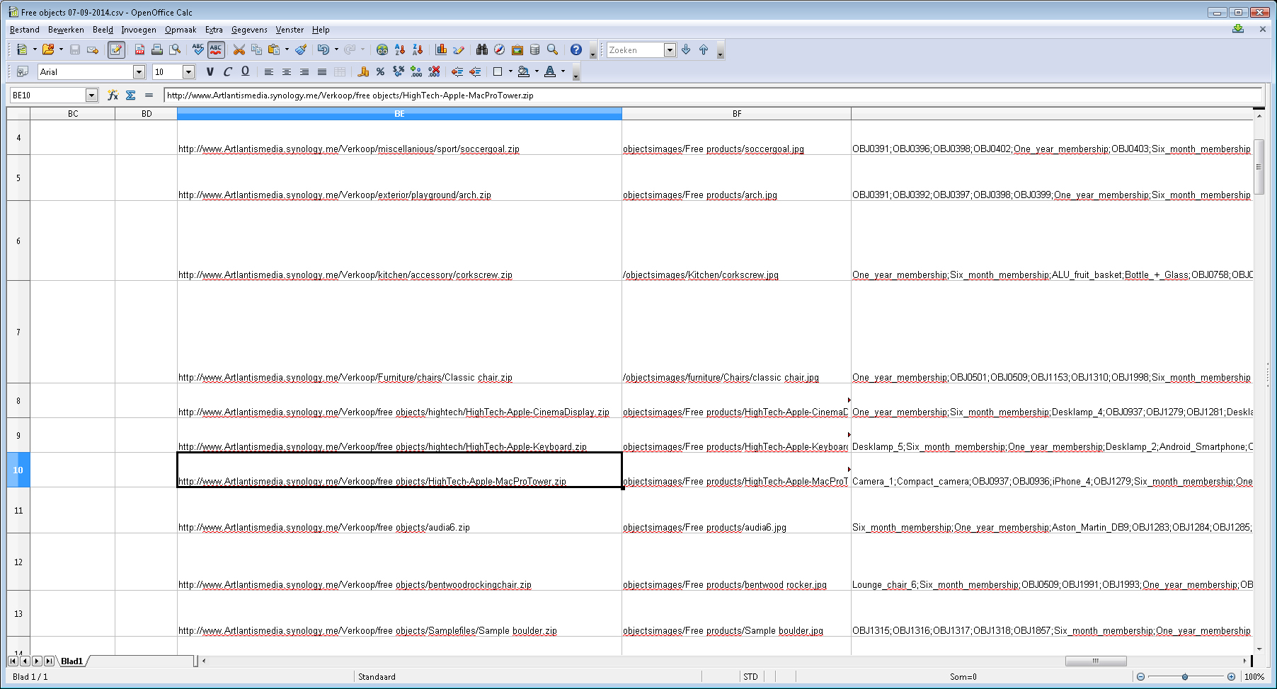

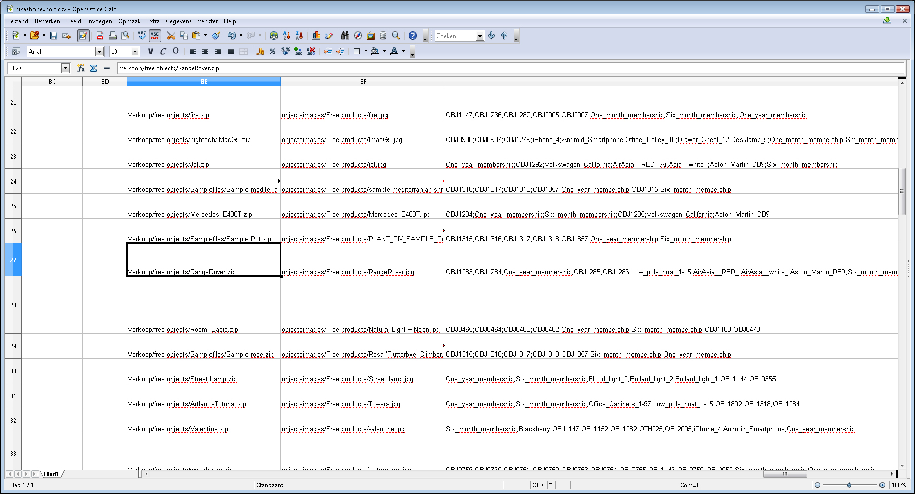

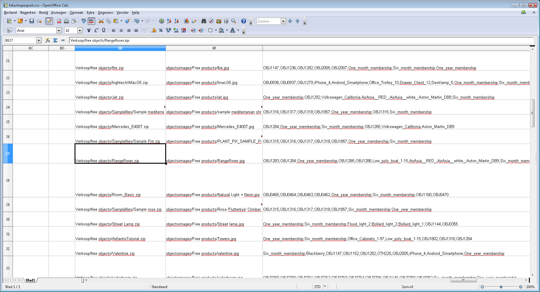

Old filepath in CSV.jpg shows the original filepath of the downloadable file as shown in the CSV file that was exported from hikashop.

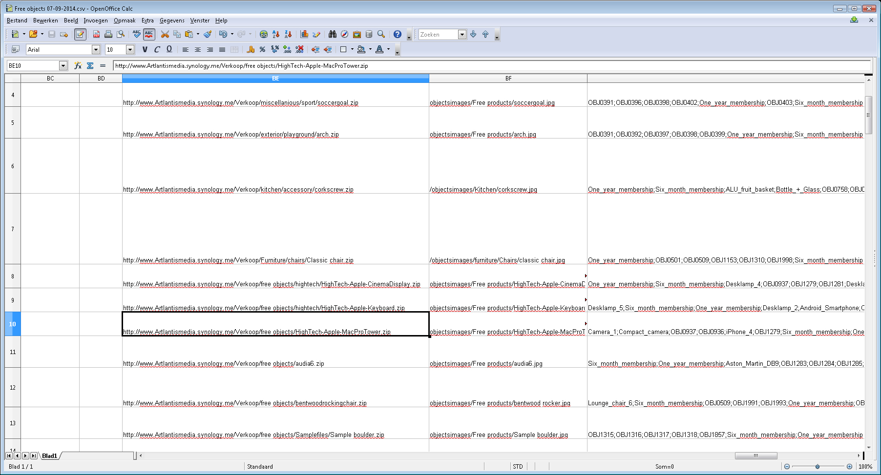

New filepath in CSV.jpg shows the altered filepath in the new CSV file.

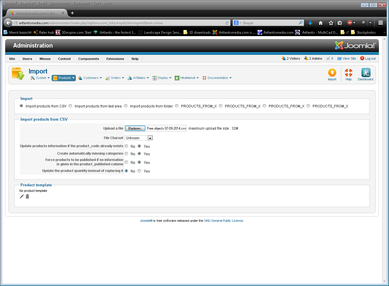

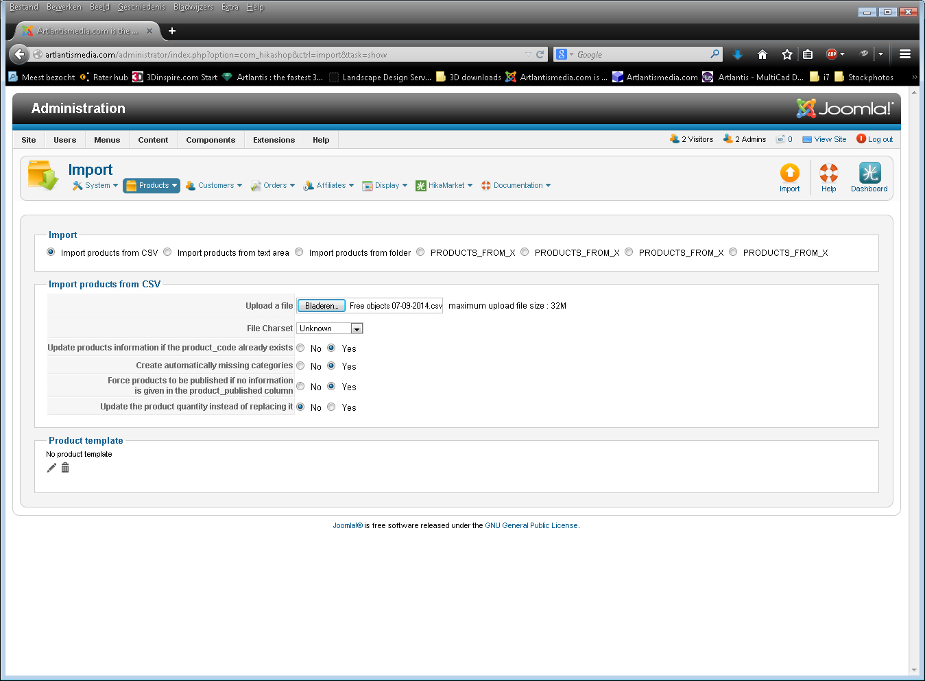

import CSV.jpg shows that I try to import the new CSV in hikashop.

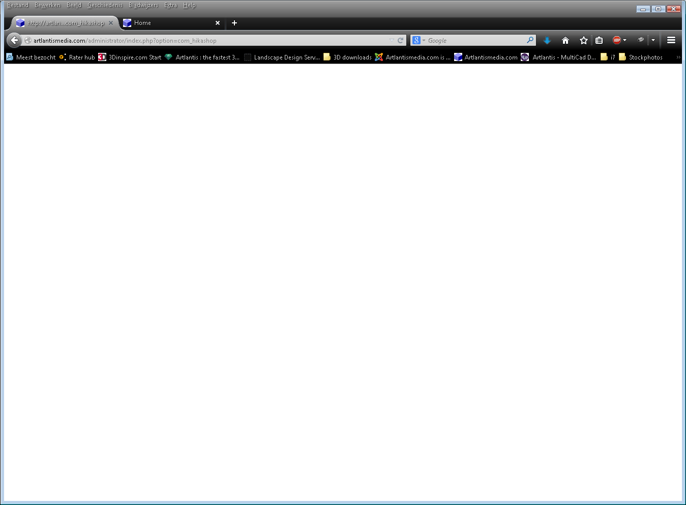

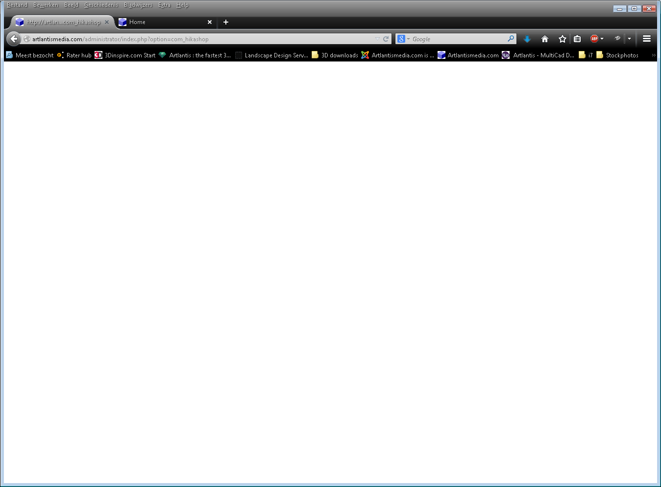

empty screen after import.jpg shows an empty screen. I can't tell you what happens here.
Downloadpath not changed.jpg shows that the downloadpath is not altered in hikashop

The files value in your new CSV is not OK for what you want to do.
What you did here is that you ask the import to download each file from your own website and put it directly at the root of your upload secure folder. And thus, that's why it crashes almost instantaneously as it tries to download all the files and that it quickly either fill up your PHP memory or time out after a few downloads.
Instead, you should enter only the new relative path in your CSV so that it updates the path of the files in the database and have the files moved manually via FTP to their new location in your upload secure folder.
