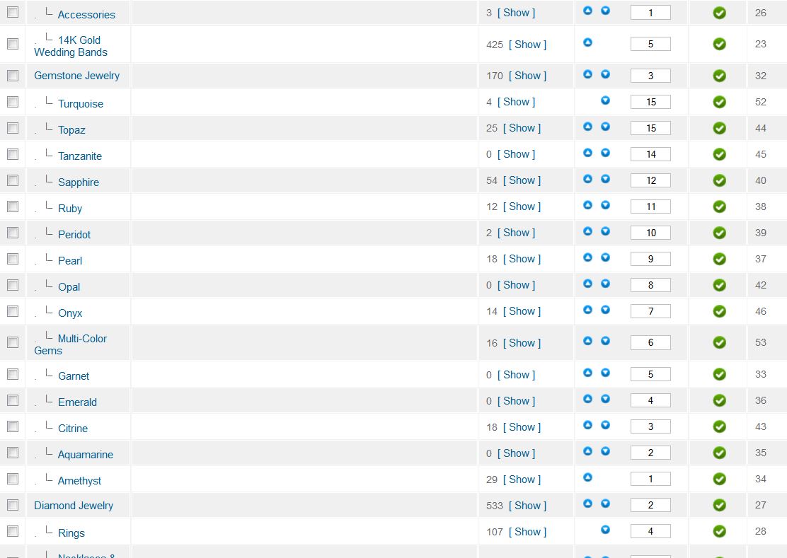

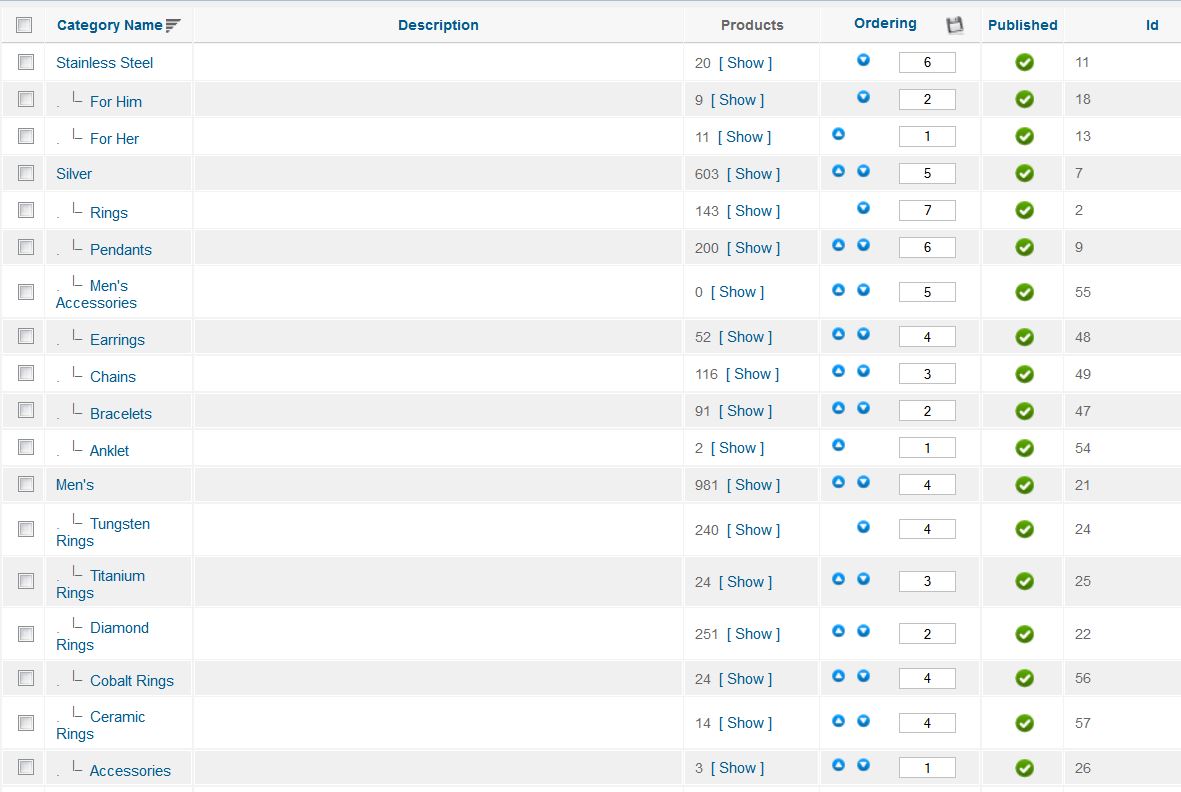

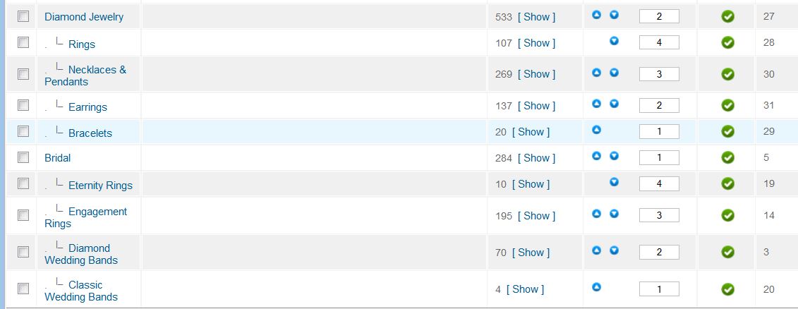

In your exported CSV, I can see the categories listed but it seems that the issue is coming from the link between the products and the categories which is missing in the hikashop_product_category table for some reason.
First, we need to make sure that the categories structure is correct. Could you go in the categories menu and do a screenshot from that ?
Then, if the issue is just with the link between products and categories, you could export a CSV file of your products in VirtueMart (I guess with CSVi) and just keep the product SKU column and the category column, rename them to product_code and categories via Excel and import the CSV in HikaShop. That way, it will link the products with the categories.

Attached are the images of the VM Categories per your request.
I can export -"product SKU column and the category column, rename them to product_code and categories via Excel and import the CSV in HikaShop "

I was more thinking about a screenshot of the categories listing of HikaShop than VirtueMart.
