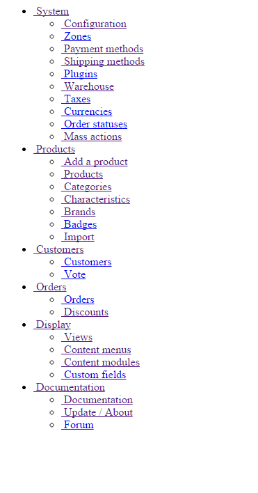

Regardless, when I hit the EXPORT button now, nothing happens and the page does not display correctly. See attached image for what I see when I hit EXPORT.
Any thoughts? Thank you in advance for your help.

Go to Global configuration and on tab Server change Error reporting to Maximum.
Save the configuration and try export again.
Do you see any errors?
Don't forget to change Error reporting back to None.

Server error logs state
20141115T122606: www.iheartsin.com/administrator/index.php
PHP Fatal error: Allowed memory size of 33554432 bytes exhausted (tried to allocate 524288 bytes) in /hermes/walnaweb01a/b1414/moo.marcosisoncom1/iheartsin/libraries/joomla/database/driver/mysqli.php on line 806

CLOSED. It was a memory allocation issue on the server. Just asked the host to increase memory.
