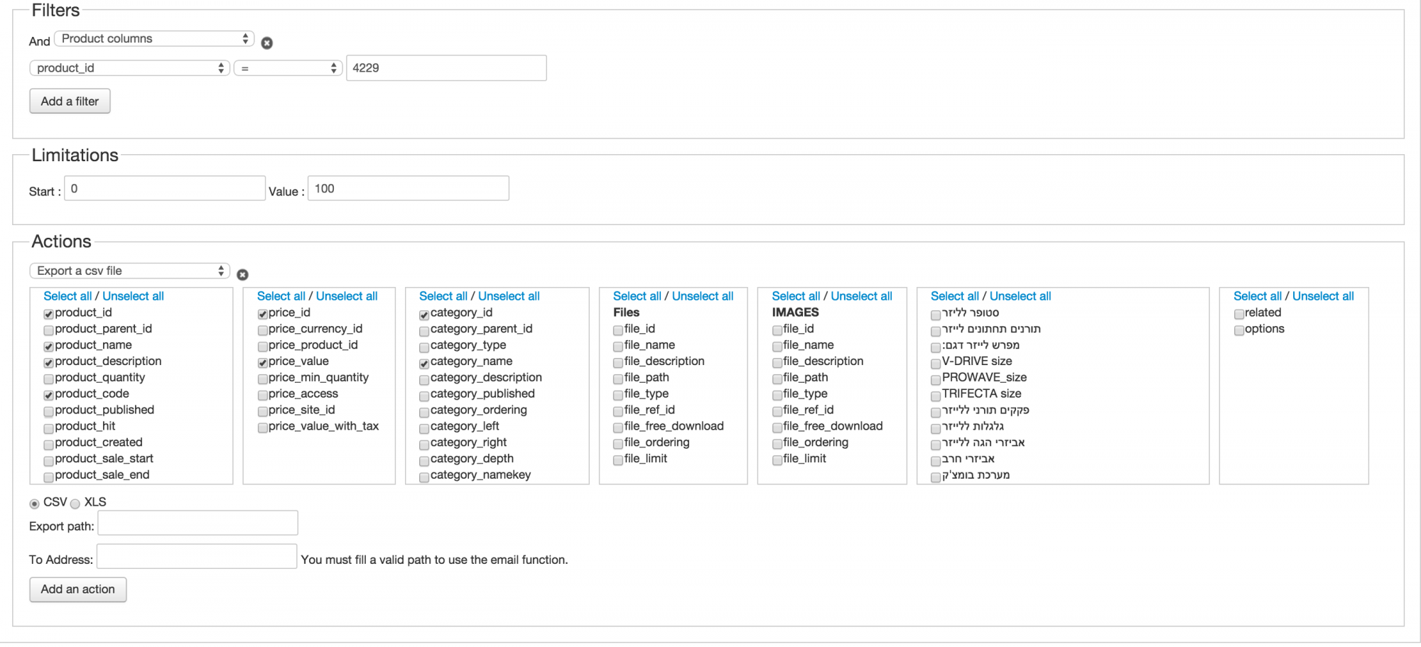

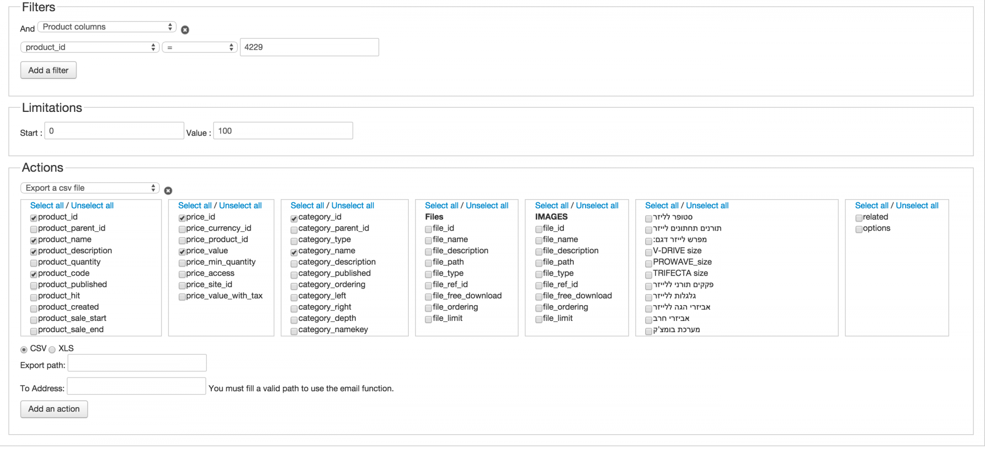

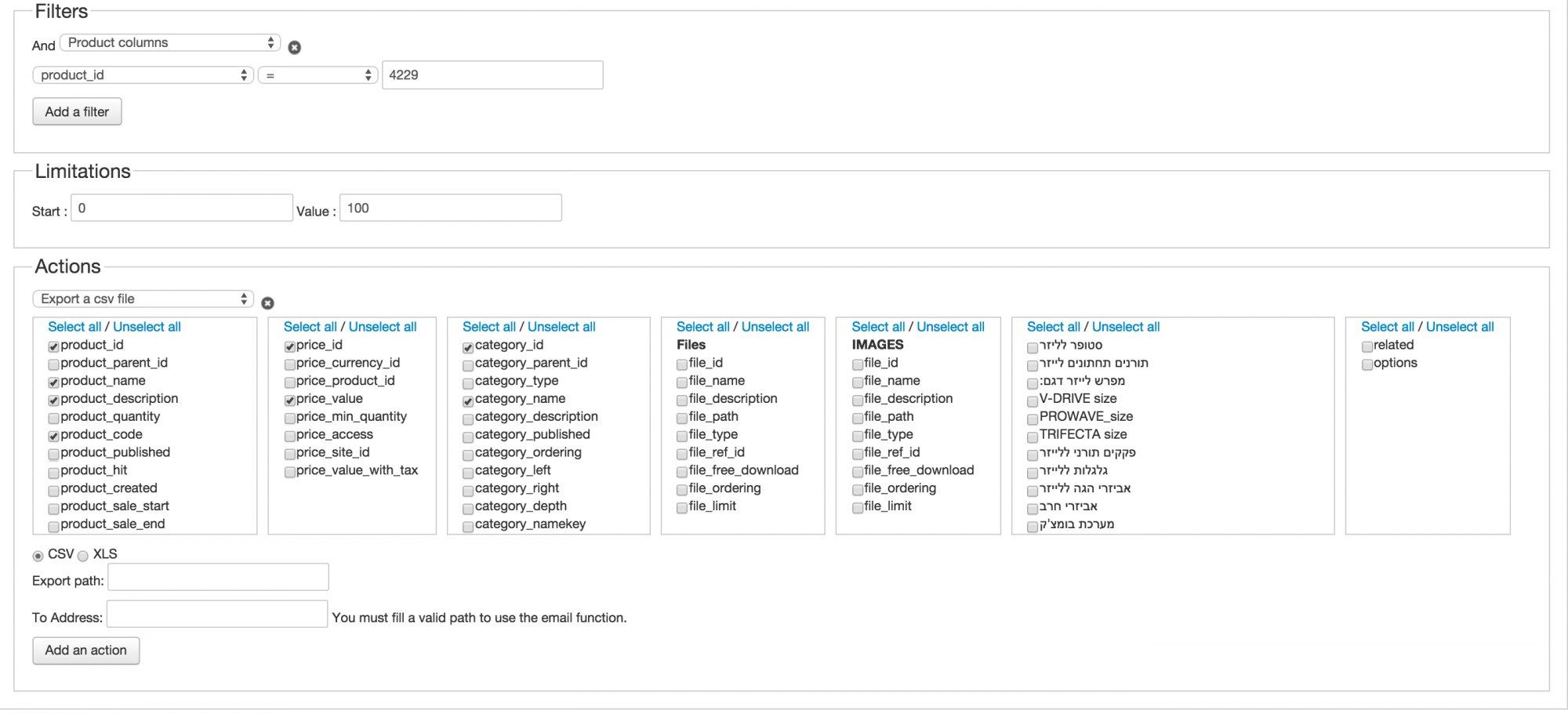

I have export a product with Characteristics via cvs with product code. (Attached is an screen shoot image with the way i am exporting the product via mass action.)
Here is the text result (attached a csv too)
"product_id";"product_name";"product_description";"product_code";"catlog_number";"price_id";"price_value"
4229;"Name1";"";"mhTop_2643";"";16590;40.00000
I still can not change the price within a product with Characteristics
Please advise

Please do not create a new thread for the exact same problem.
I already gave you an explanations for the error message ; if you do not understand it you can just say and we will reformulate it.
1. If you need the product to be a variant so ; don't try to replace an existing product which is a "main" one.
2. ok
3. There is no product code in your CSV ; how did you changed it ?
I can only recommend you to use a mass action and not use the import system.
The import system has been made to import ALL information of a product ; it means that you need to import a complete and full CSV containing ALL columns of a product ; the kind of CSV you can retrieve by performing an export.
The CSV you're trying to import is highly uncompleted ; it can't be imported due to the too many missing data.
Please use a CSV in a correct formating, using coma or semi colon as separator and using double quotes for string encapsulation.
So, you need to use a mass action.
www.hikashop.com/support/support/documen...massaction-form.html
