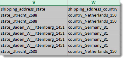

When I look in the csv file from the mass action export is see that the states and country names are not the real names. It looks that name used in the database is shown. See image.
Is this normal?

These are the values stored in the #__hikashop_address table, so the mass action is get this value directly from Database.
You can potentially use a regex in order to keep only the middle part (the english name).
For that you can edit the file "plugins/hikashop/massaction_order/massaction_order.php" and in the function "onProcessOrderMassActionexportCsv" add:
		foreach($params->elements as $i => $element){
			foreach($element->address as $j => $row){
				if(isset($row->address_state)){
					$row->address_state = preg_replace('#^[^_]*_#','',$row->address_state);
					$row->address_state = preg_replace('#_*[0-9]#','',$row->address_state);
				if(isset($row->address_country)){
					$row->address_country = preg_replace('#^[^_]*_#','',$row->address_country);
					$row->address_country = preg_replace('#_*[0-9]#','',$row->address_country);
after:
$params = $this->massaction->_displayResults('order',$elements,$action,$k);

Hi, I am looking to export the shipping address details via mass action and found this thread wanting the similar information, however when entering the change some of the exports still have underscores and there are now no spaces in 'United Kingdom' and also underscores in some of the 'state' export as well.
shipping_address_state shipping_address_country
New_Jersey United_States_of_America
Lisboa Portugal
Leicestershire UnitedKingdom
Hampshire UnitedKingdom
Hertfordshire UnitedKingdom
WestMidlands UnitedKingdom
Middlesex UnitedKingdom
London UnitedKingdom
Kent UnitedKingdom
Dorset UnitedKingdom
WestYorkshire UnitedKingdom
Manchester UnitedKingdom
Cleveland UnitedKingdom
Zagreb Croatia
Rhondda_Cynon_Taf UnitedKingdom
Is there an easier way to export shipping addresses as they are laid out in the 'order'? this is needed for a new bar code system introduced by Royal Mail in the UK to be printed on to address labels.
thanks

Please try that code instead:
					$row->address_state = preg_replace('#_*[0-9]$#','',$row->address_state);
					$row->address_state = str_replace('_',' ',$row->address_state);
					$row->address_country = preg_replace('#_*[0-9]$#','',$row->address_country);
					$row->address_country = str_replace('_',' ',$row->address_country);
We don't have ported this modification on our end yet, but it is on our todo list.

Hi, Works for some but not others and now leaving numbers on the end... see below.
order_id shipping_address_state shipping_address_country
18223 New Jersey 429 United States of America 22
18224 New Jersey 429 United States of America 22
18225 New Jersey 429 United States of America 22
18296 Lisboa 300 Portugal 17
18306 Leicestershire 414 UnitedKingdom 77840086
18307 Hampshire 411 UnitedKingdom 77840086
18309 Hertfordshire 412 UnitedKingdom 77840086
18310 WestMidlands 104986208 UnitedKingdom 77840086
18311 Middlesex 135968147 UnitedKingdom 77840086
18312 London 414 UnitedKingdom 77840086
18313 Kent 413 UnitedKingdom 77840086
18314 Dorset 409 UnitedKingdom 77840086
18315 WestYorkshire 76284918 UnitedKingdom 77840086
18316 Manchester 415 UnitedKingdom 77840086
18318 Cleveland 200498208 UnitedKingdom 77840086
18319 Zagreb 108 Croatia 5
18320 Rhondda Cynon Taf 419 UnitedKingdom 77840086
18321 Devon 408 UnitedKingdom 77840086
18322 Aberdeenshire 402 UnitedKingdom 77840086
18323 Hampshire 411 UnitedKingdom 77840086
18324 Berkshire 111061387 UnitedKingdom 77840086
18325 Dumfries and Galloway 408 UnitedKingdom 77840086
18326 Hampshire 411 UnitedKingdom 77840086
18327 94 China 4

Just to clarify a bit the situation, we will not use that code when we will implement that feature.
That code is a temporary code to manage that situation, but the final code will use database queries to get the desired data from the zone table.
Here is a new version of that temporary code, not tested.
					$row->address_state = str_replace('_',' ',str_replace('state_','',preg_replace('#_[0-9]*$#','',$row->address_state)));
					$row->address_country = str_replace('_',' ',str_replace('country_','',preg_replace('#_[0-9]*$#','',$row->address_country)));
