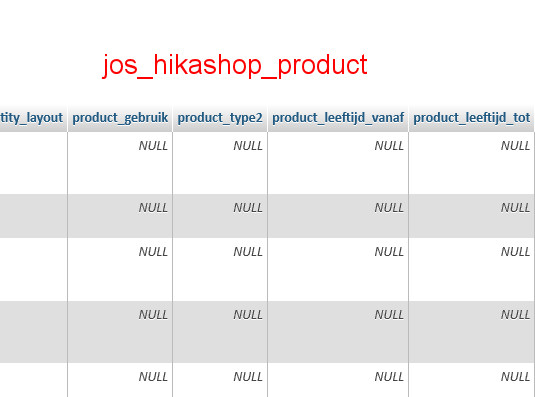

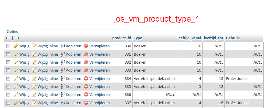

I am working on a website with Joomla 1.5 and VM 1.1.9 that will be transferred to Joomla 3.3 and Hikashop. I have installed Hikashop on J1.5 and import VM products in Hikashop.
VM has some special custom fields in the product. I have made these fields in Hikashop, so in the database they exist (now). See pictures.
Question: How can I import the VM custom fields in to Hikashop database?
MySQL request – how?
There exits also an jos_hikashop_vm_prod – I think this one is important.
11 years 7 months ago #188746
That's right, the best will be to perform a MySQL request directly.
You can use the table "hikashop_vm_prod" which make the link between the "virtuemart_product" and the "hikashop_product".
So you can use an "UPDATE" query to update the "hikashop_product" table from data coming from "vm_product_...." with a inner join on "hikashop_vm_prod".
Something like:
UPDATE #__hikashop_product AS hkp
  INNER JOIN #__hikashop_vm_prod AS hkvm ON hkp.product_id = hkvm.hk_id
  INNER JOIN #__vm_product_type_1 AS vmp ON vmp.product_id = hkvm.vm_id
SET
  hkp.hk_customfieldkey = vmp.vm_customfieldkey
(where you will replace the two fields in the "SET").
  • Posts: 41
11 years 7 months ago #189283
Thanks Jerome,
I think this is the solution. But my knowledge about MySQL is little, so I have to search someone to get this done. I get errors and that's because I do not exactly know what I am doing.

  • Posts: 41
11 years 7 months ago #189360
Hello Jerome,
It worked. I have tried replacing #_ for jos_ but I also did not understand completely the rule:
SET
So I also changed this and the database is complete!
