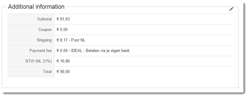

I have this strange thing.
I have a massaction event that exports to a csv and after that immediately changes the status of an order to "naar verzender". The problem I'll describe is not related to the status name, because when I user canceled instead of "Naar verzender" it also happens.

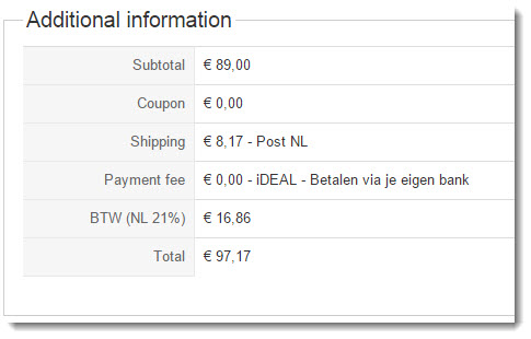

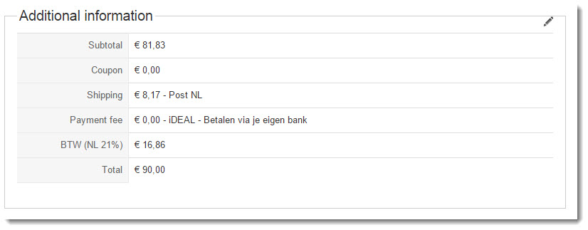

When the massaction event has run the prices of an order when I click on an order via Orders / Orders. have changed. I can't find any algorithm what has changed but the prices aren't right anymore.

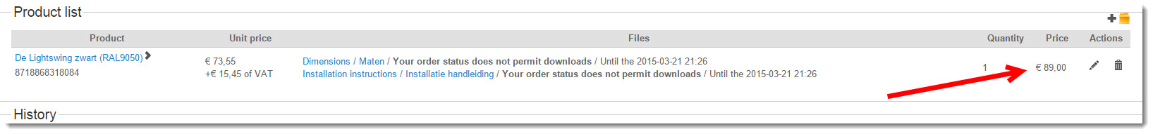

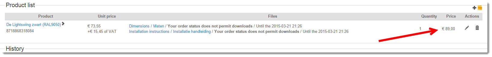

In this picture you see a price of 81.83, but when you look at the productlist of that order you see that it should be 89.00.

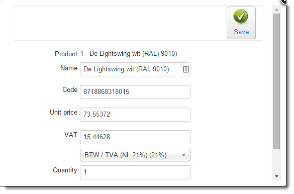

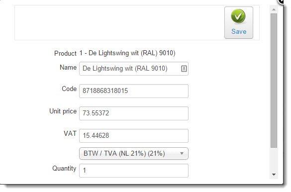

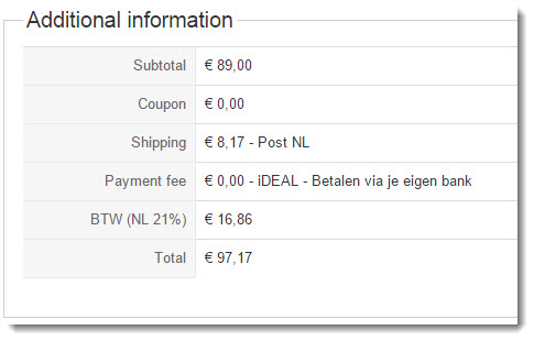

When I click on the edit mode of the product list and press save.right away the prices in the upper right corner change again to the correct ones.
It doesn't happen if you just export to a csv, it only happens with the combination, so right after the export a status change.
In the beginning I thought that it had to do with the changes I made to massaction.php, but we have set the original massaction files back and then it also happens.
Can this be explained?
Kind regards Wilfried
