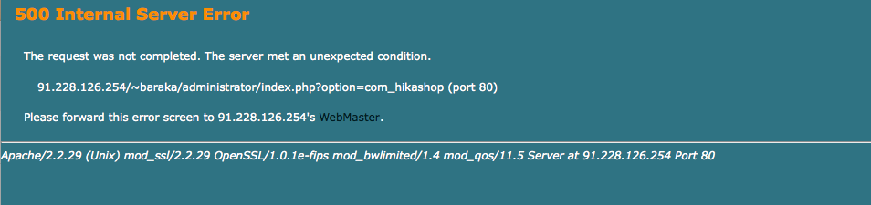

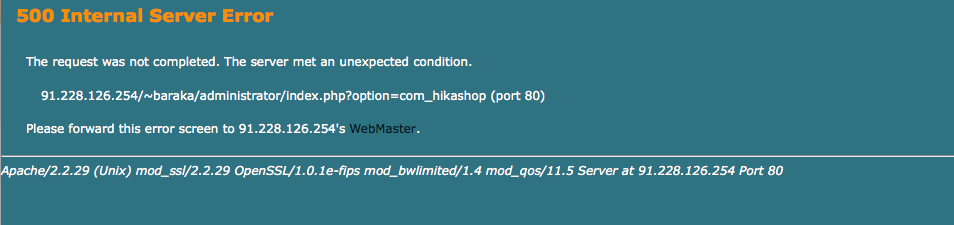

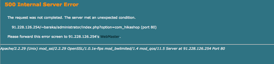

I login to admin panel -> extensions -> hikashop -> import -> choose csv -> import
and I get a server error, please take a a look at a the screenshot.
any ideas?

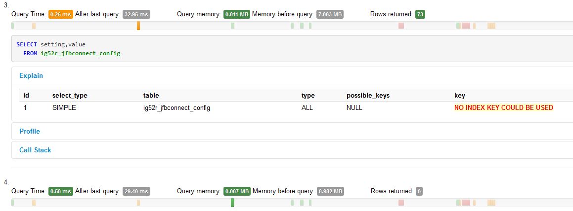

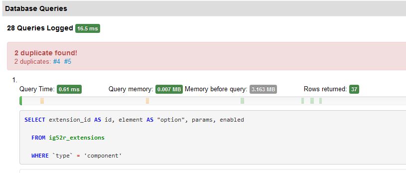

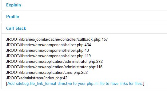

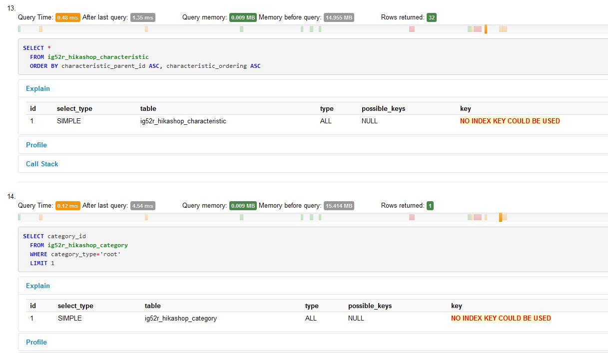

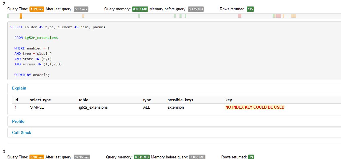

please find attached the file I try to upload.

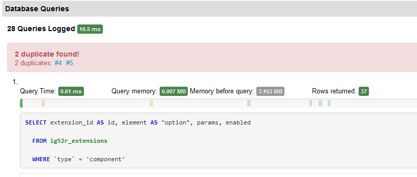

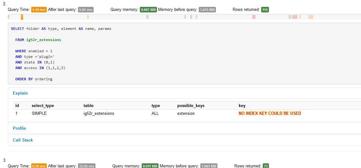

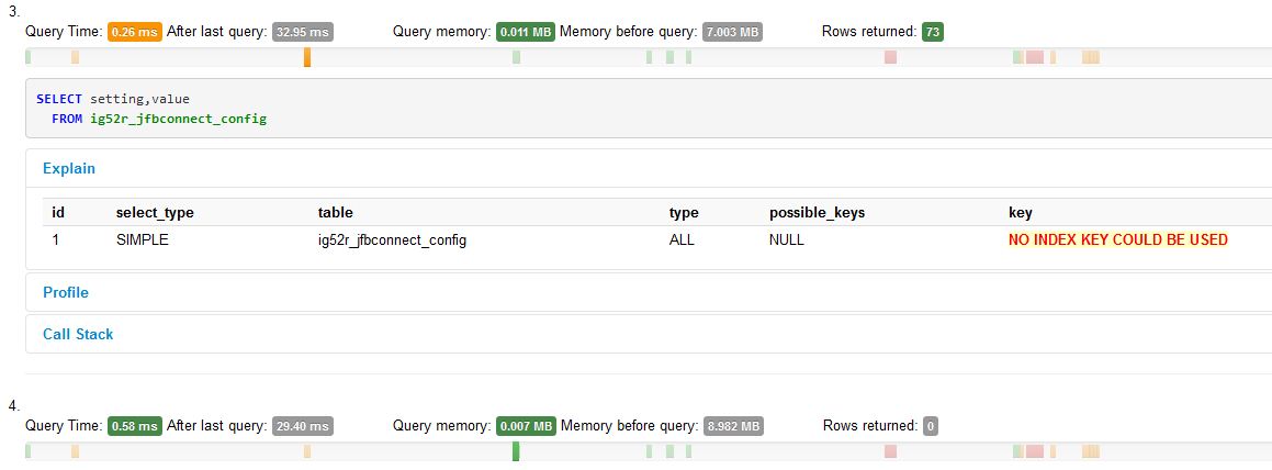

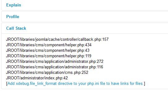

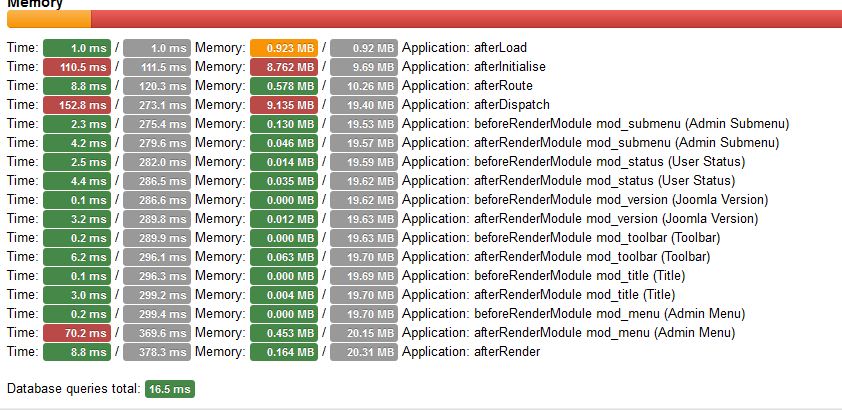

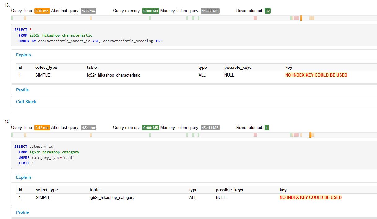

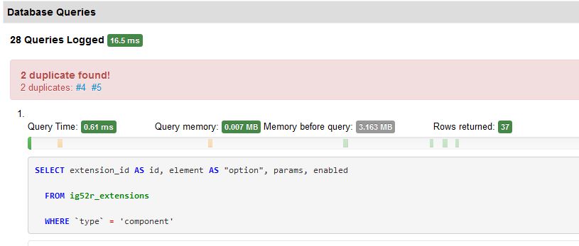

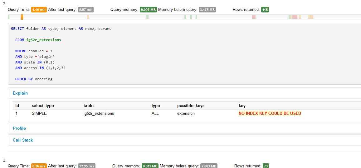

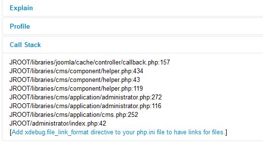

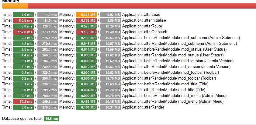

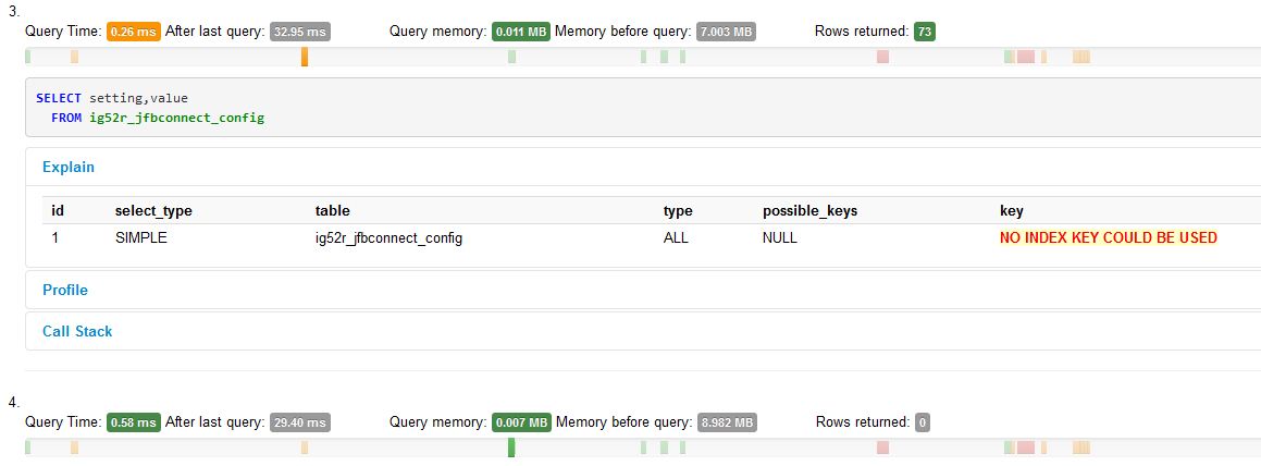

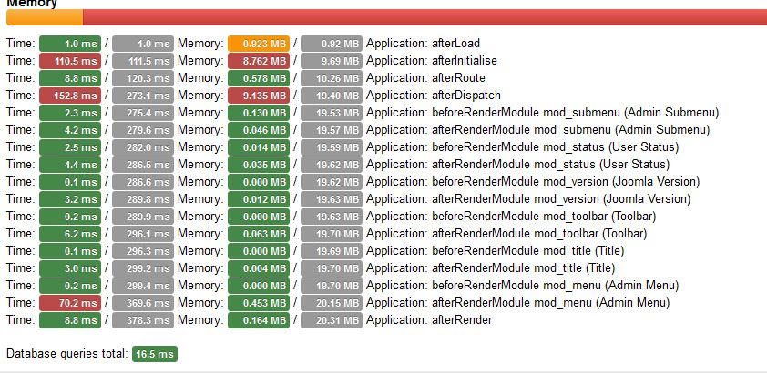

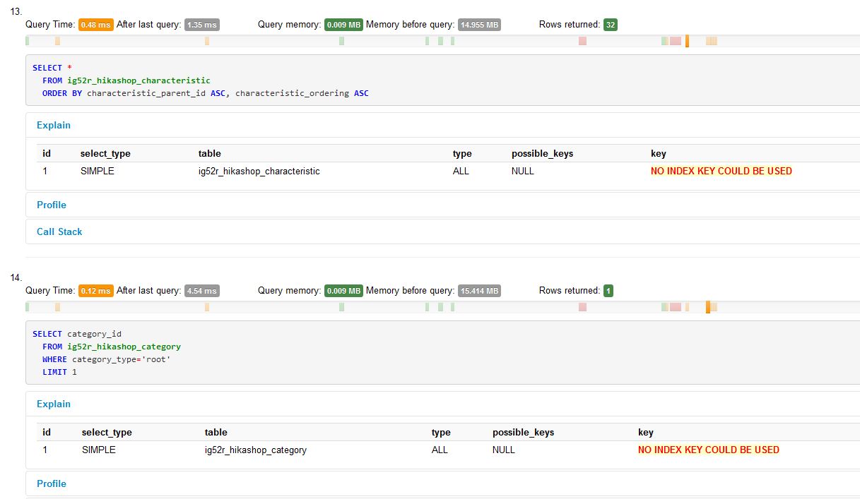

about the debug, I have attached some highlights in my opinion, it's pretty long.

11 years 3 months ago #202756
The 500 error comes from a limitation of resources of your web server which doesn't give enough time to the import process to do the import.
The best would be to manually upload your product images in the upload folder of HikaShop ( images/com_hikashop/upload or media/com_hikashop/upload based on your version of HikaShop (you can check it in the Files section of the Hikashop configuration page)) and then only have the name of the images in the "images" column instead of the URL.
That way, HikaShop won't have to download the image of each product and will directly link the image in the upload folder to the product. That will be tremendously faster and should hopefully avoid the problem.
