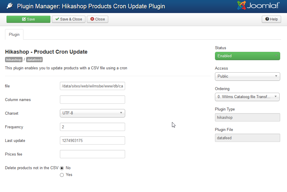

I don't know the code ... I just setup the Hikashop products cron update plugin (see image attached)
the file-box contains "/data/sites/web/wilmsbe/www/db/cataloog_import_ok.csv"
So I'm guessing the code is yours ...
The error I'm getting now is this: "Could not find the file /data/sites/web/wilmsbe/www/db/cataloog_import_ok.cs"
I hope this gets solved quickly ... pressure starts to build B)
Importing the file through the regular channels works fine and the file (extension .csV) is in the place mentioned ... somewhere the V gets dropped and then the file can not be found ...
