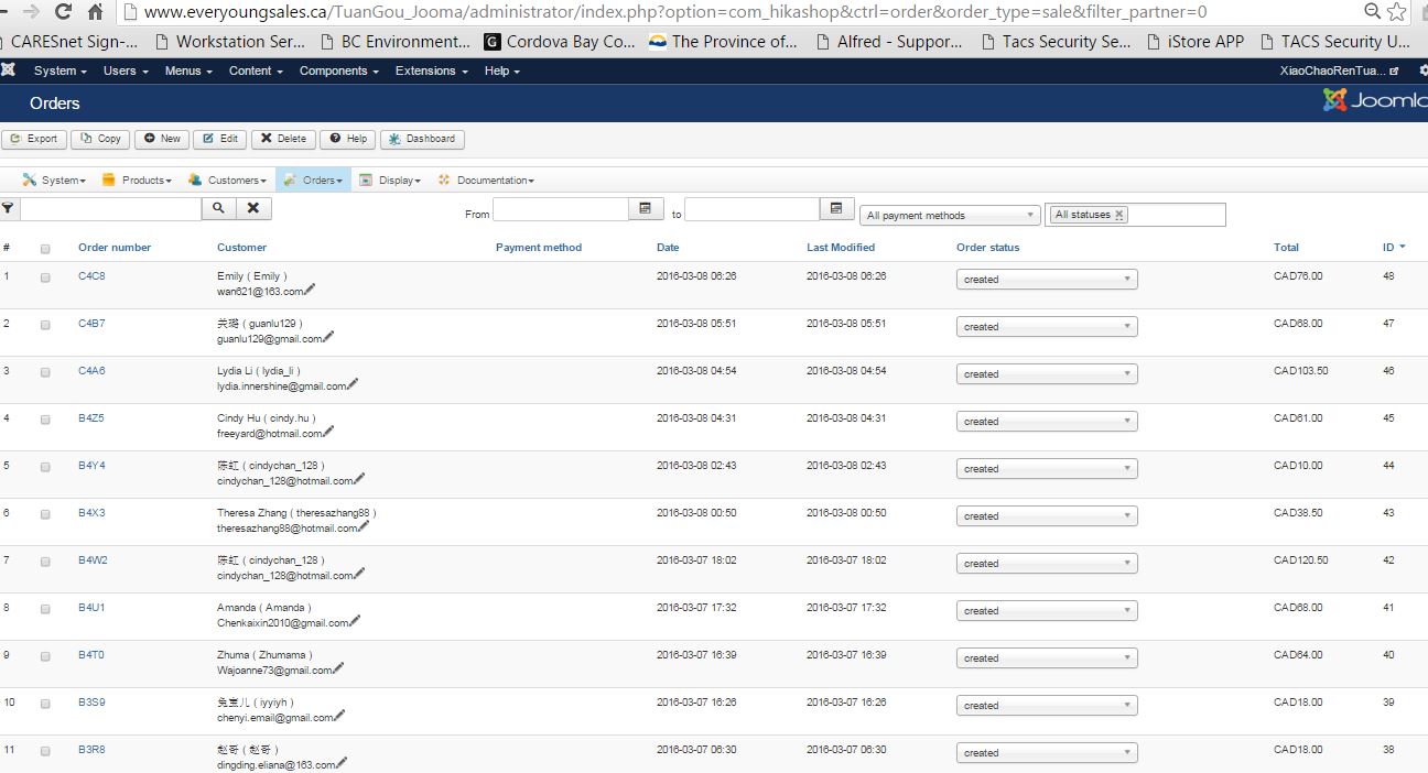

  • Posts: 8
10 years 6 months ago #232522
Thanks for quick response.
I got same issue using mass action or using Export function.
Orders are displayed correctly on the page, but the unicode data was not correctly exported.
Please see attached.

  • Posts: 86104
  • Thank you received: 14203
10 years 6 months ago #232576
I've opened the CSV on my end and it displays just fine:
take.ms/dcEma
So the problem is actually with how you're openning the CSV.
Please make sure that you're openning it with the UTF8 encoding and it should display fine.
