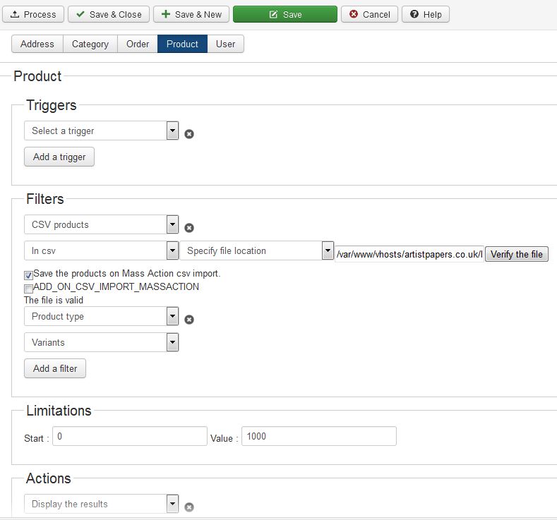

I am trying to add GTIN to my products. I have added a custom field product_cust_gtin to the product database and have a csv file with columns product_code and product_cust_gtin. There are 676 rows in my csv (676 products) which are all variants and I have a header row with the field names.
I have setup a mass action with the csv filter to import the file. When I run it just 73 of the rows import correctly, 20 rows say product not found (even though some of them exist) which leaves me with nearly 600 rows that just don't import.
For some rows to import but others not suggests a problem with the csv file but it looks fine to me ( attached ). I have tried with and without quotes round the text fields but get the same results. I have also attached screen shot of mass action settings. What could be going on here?

Everything seems to be correct, the csv file is well formatted and the mass action settings seems to be as they should.
You have to check the option "ADD_ON_CSV_IMPORT_MASSACTION" in order to add not existing products.
If that does not help, please try to update with the latest version from our website (still 2.6.3 but with some fixes).

9 years 7 months ago #261297
I see that you have a "product_type" filter on the "variants".
Maybe it's related with your "partial importing" issue ?
  • Posts: 250
  • Thank you received: 7
9 years 7 months ago #261346
Sounds possible doesn't it but I tried it without any filters and still only about 80 of 600 items updated.
There is an issue in that some of the products in the spreadsheet aren't in Hikashop, so I get some "products not found" messages. I can imagine that might break the import but it doesn't give any indication that it has failed and it should be able to cope with that really.
