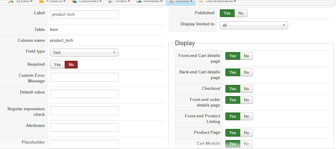

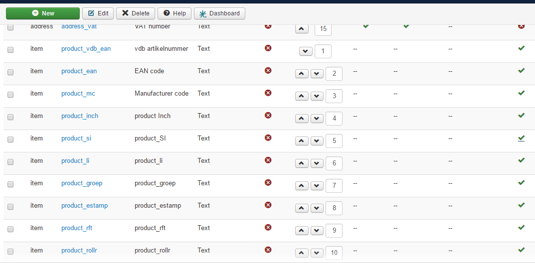

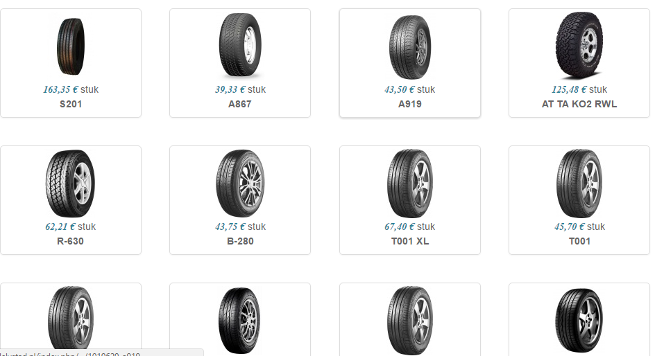

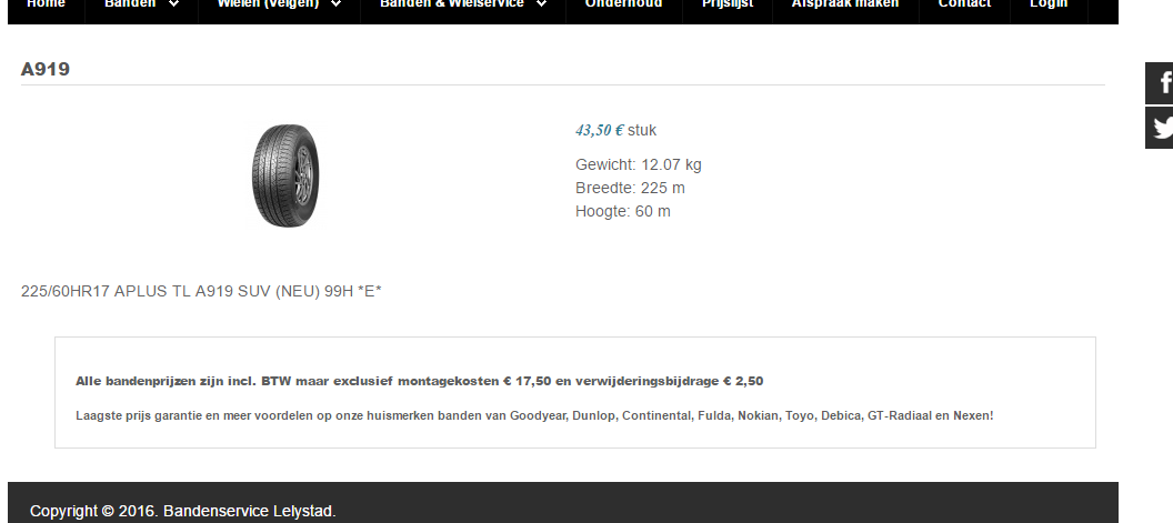

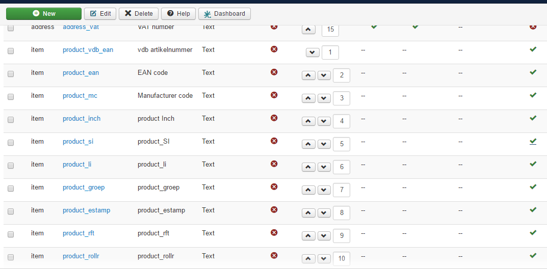

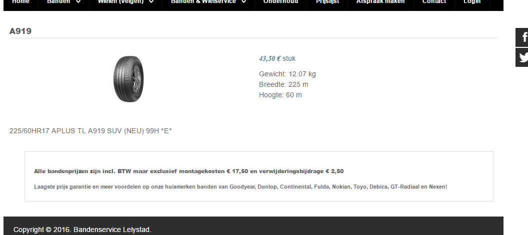

  • Posts: 30

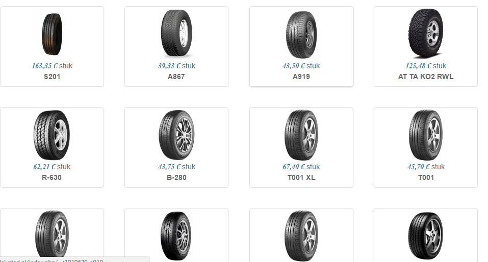

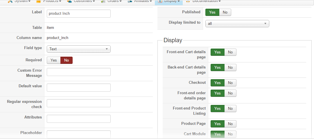

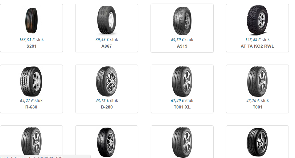

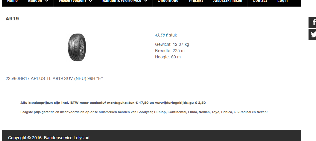

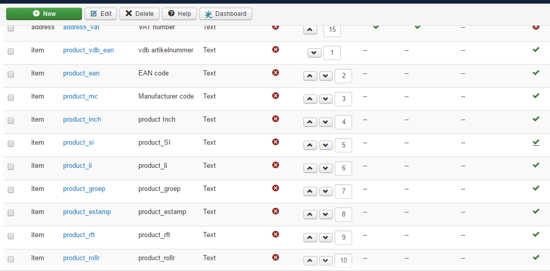

9 years 8 months ago #257569
As attackments the printscreens of the product overview, product detail page, backend of custom fields and 1 custom field with settings
  • Posts: 86104
  • Thank you received: 14203
9 years 8 months ago #257586

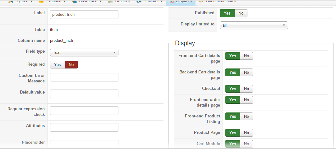

Thank you but unfortunately that doesn't help.
Could you provide a screenshot of all the settings of that product_inch custom field and a link to the product page where it should display ?
Could you also provide a screenshot of the settings of that A919 product ?
Also, if you switch to the default template of Joomla, do you have the problem too ?

9 years 8 months ago #257963
Hallo,
It was indeed my template that was messing up the custom fields.
