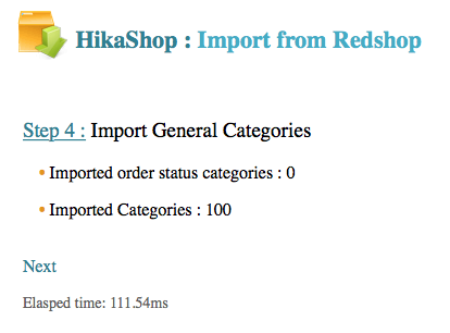

I made the tax ID change you suggested and all went well till I got to Step 4 and then the import stop. No error message, it just shows the Imported categories and provides a Next Step Link. When you click on the Next Step Link, it looks like it is running a process but it gets stuck at this point.
I hope this helps....Please see attached image.
Scott
