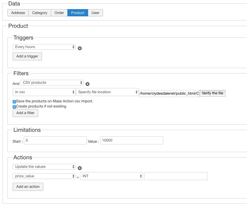

I am trying to upload prices via a CSV using the mass action tool. However I have found that the prices are displaying on the front even thou they appear for each variant in the backend.
I am using mass action but I believe I need to setup an action but I am unsure how to do this. I have read the documentation but I don't understand it enough.
Do I select an action 'update the values' then select 'price_value' But I don't know what it is equal too and what else I need to add?
I have attached a screenshot of my setup so far.

Hello, I have updated my hikashop with the latest version but I don't understand what it has meant to have fixed? I am still receiving the same problem. Was my action settings correct from before?

Mohamed performed some tests using a similar CSV file.
He detected an issue in the Mass Action import system and after a deeper investigation we saw that because there was no "product_parent_id" in the CSV, some algorithms in the mass action system were skipped.
So we changed things in the system to load that information if it's not present and with that patch the CSV were correctly read.
Without the patch you need to add a column "product_parent_id" and specify the id of the parent (which is "0" when you are not using variants).
Afterwards, because you now have a rule to set a product price, it can generate a side effect.
I would more commend you to have a non obtrusive action like "display the result".
