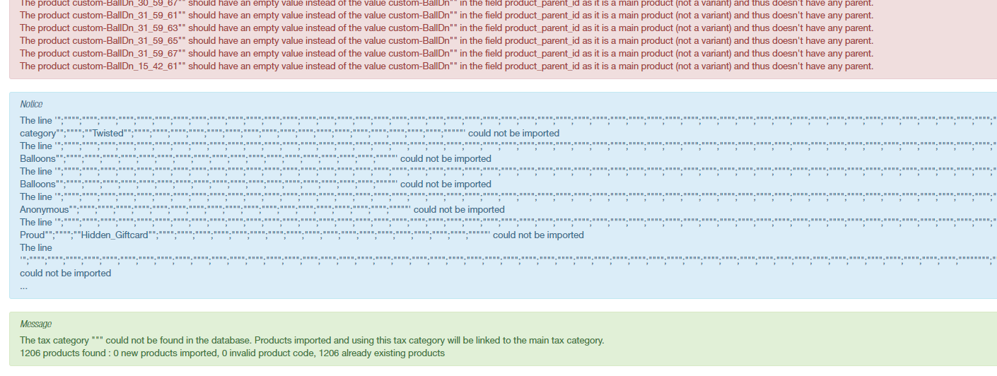

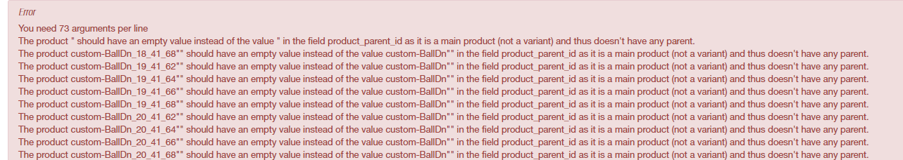

-- Error-message(debug-mod must be tuned on) -- : You need 73 arguments per line
@support, @forum,
I did a export of ONE product (checked the product and selected export).
Generated the hikashopexport.csv
I updated 4 variants (record numbers #29251, #29275, #29283 & #29291) with Image file paths and names in the csv file, saved it.
Ran the import, and error message "You need 73 arguments per line" came up.

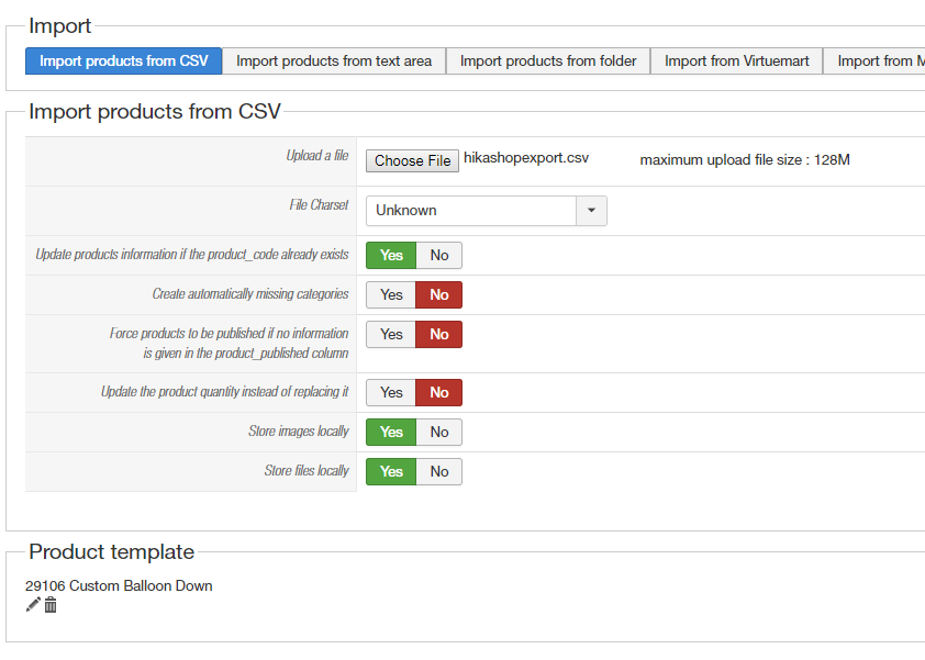

Have attached the csv file, and 3 screen shots with the config for the import and error messages.
I read the doco and that didn't help, has there been a change in the 3.4.1 version ?

It seems that your CSV editor added some double quotes around all the elements of the CSV and it messed the CSV file itself.
I would recommend to do the export again, open it with libreoffice / openoffice's calc and modify it there.
Also, you can remove all the category lines that are not useful since you already have all the categories in the shop.

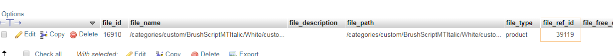

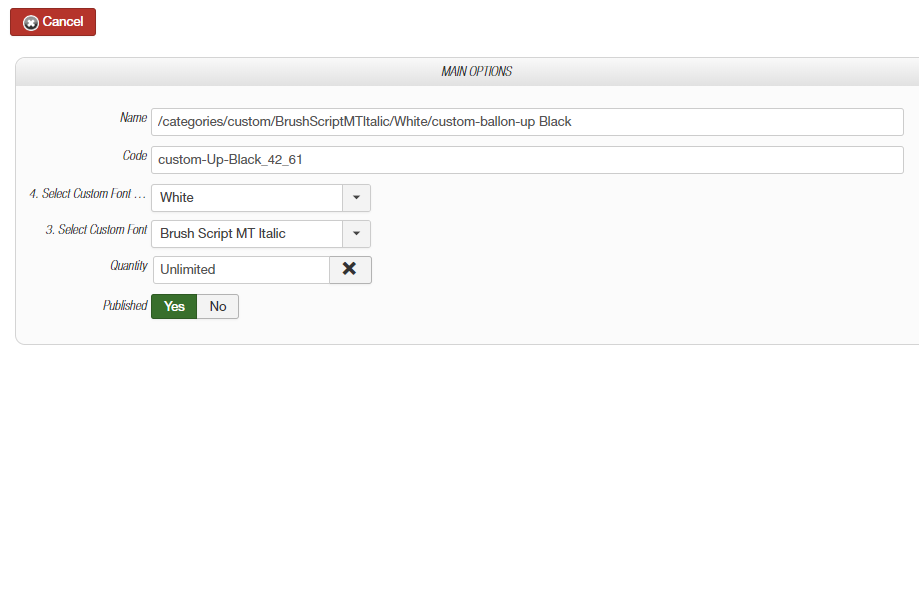

Also, why does the import put a name (truncated image name) in the Main Options name of the Variant when the import file has "" in the csv field?
I have attached the csv file, look at product_id 39119, then look at the attached screen shot of the Variant after the import, and last image is of the hikashop_file dataset and what it puts in there. It also replaces name also with a truncated image file name.
I have wasted hours today, deleting and rebuilding the database in phpmyadmin.
I have 34 more imports to do, I just want it to work, if I say "" in name field or something, thats what I would like.
Is there a patch needed to fix this, or some code replace you want to send me ?

Regarding the name of the variants being filled automatically, that's a side effect of the capability HikaShop has to generate products from images in a folder automatically. In such cases, there is no name given and the name is automatically filled with the name of the file used to generate the product.
To avoid that, you can change the line:
if(empty($product->product_name)){
to:
if(empty($product->product_name) && $product->product_type != 'variant'){
in the file administrator/components/com_hikashop/helpers/import.php
We'll do that change on our end too for the next version.

Also modified the code when using another product as the template. It used the name of the product and places it in all the variants names.
$product->product_name = $this->template->product_name; to
$product->product_name = "";
MSF

However that change is not correct as it will have side effects you don't want. For example, if you try to duplicate a product with the "copy" button on the products listing, the product name won't be copied over if you do that modification.
Instead, it will be better to change the line:
if(empty($product->product_name) && !empty($this->template->product_name)){
to:
if(empty($product->product_name) && !empty($this->template->product_name) && $product->product_type != 'variant'){
The following user(s) said Thank You: markfell
