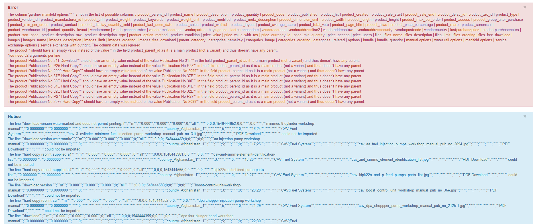

However I have very little experience of CSV files and when I alter the id's in the file so they no longer clash it no longer imports without a lot of errors, see attached. With this CSV the products don't come over at all but the categories has been messed up as shown in capture2

After you do the expor,t you want to:
- open the CSV with Excel, or even better, libreoffice calc.
- remove the product_id column
- remove the lines to generate the category tree at the beginning to only keep the first line with the column names and the product lines.
Normally, the categories are linked by their names not their ids so even if the ids are different, if the names are the same, the import system should be able to attach the products to the corresponding categories on the new website.
