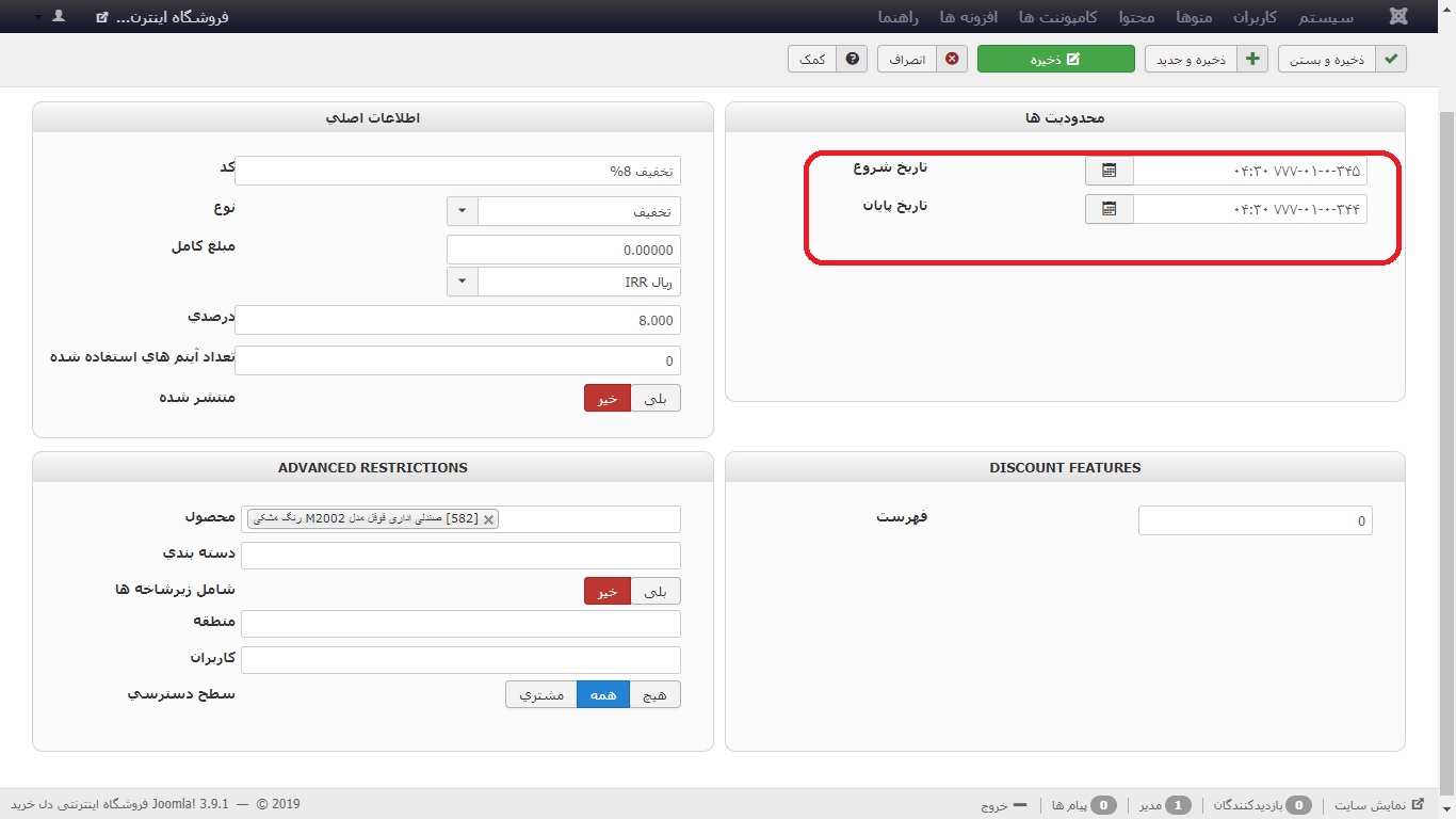

7 years 1 month ago #309953
Hello
I have attached a sample output report for Persian. Before downloading, I set the report settings to utf8.
I also included some images from the report page and a discount code.

Regarding the date selectors in the discount edition and report edition, I don't see what is wrong.
Please understand that I can't read persian and I don't know how the Hijri Shamsi calendar works, so I'm a little lost.
Could you provide more information? What should be displayed there ?

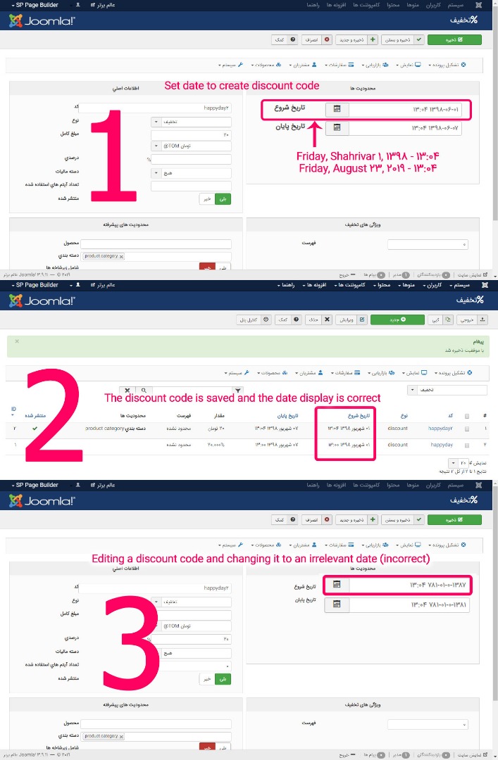

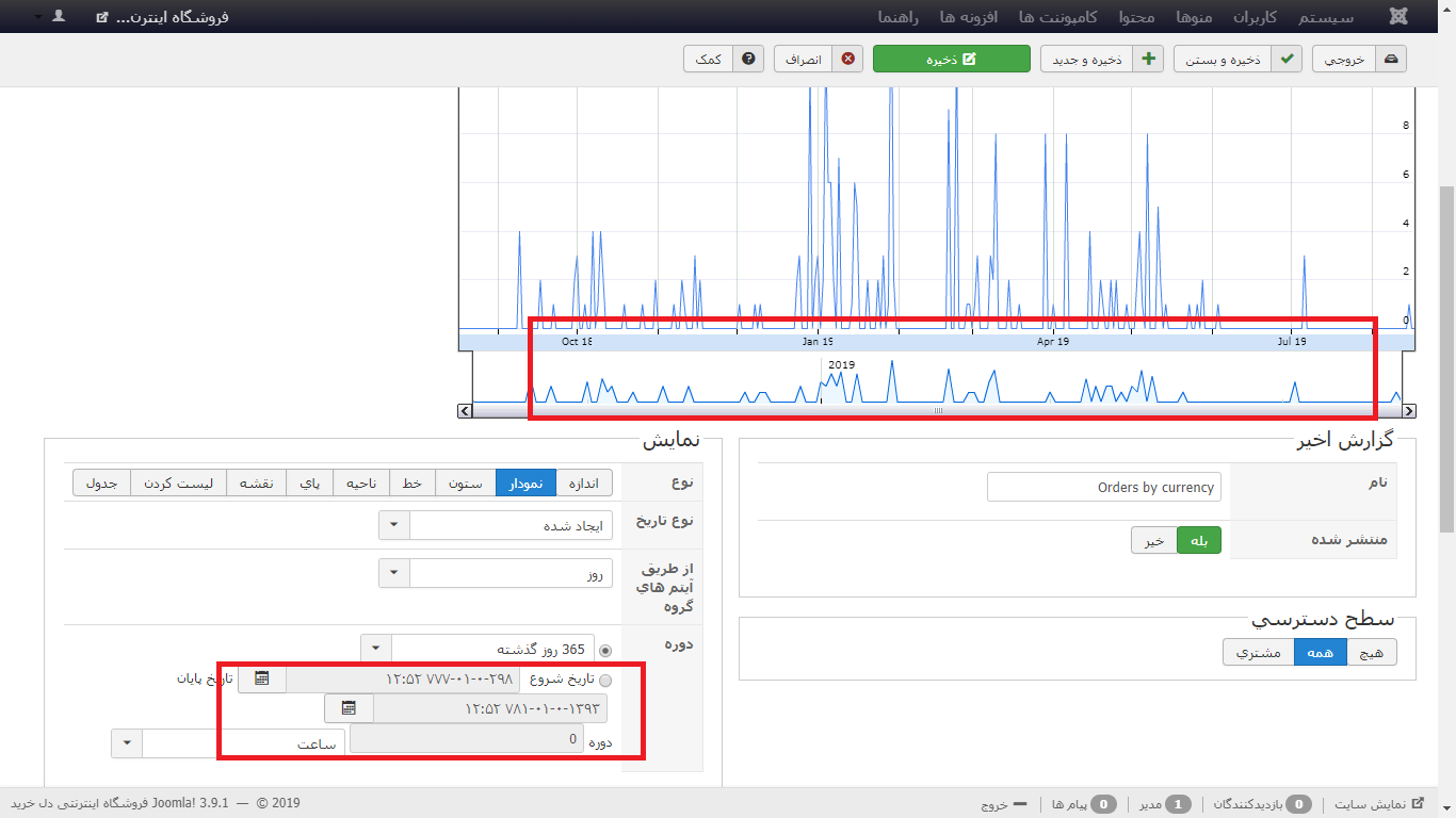

7 years 1 month ago #310147
Hello.
Yes! Sure.
I think about the discount code with the image I have attached and the description on the image so you can see what the problem is.
There are two problems with the reporting section.
1- In the charts, the date is displayed in AD. (Not Farsi)
2- In the settings section of the report, there is a Persian date, but it is displayed incorrectly. (Like discount code)
But let's put everything in CSV in the next post.
