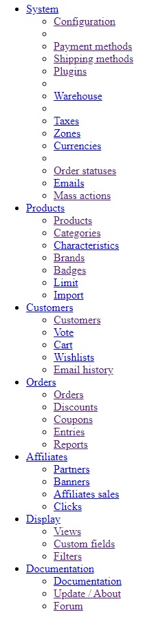

Also, when I am trying to export via products listing, I am getting a tree menu.

In fact, the issue you describe with the CSV export button on the listing, indicates that you have restrictions in place on your hosting which are too low to be able to do this process.
