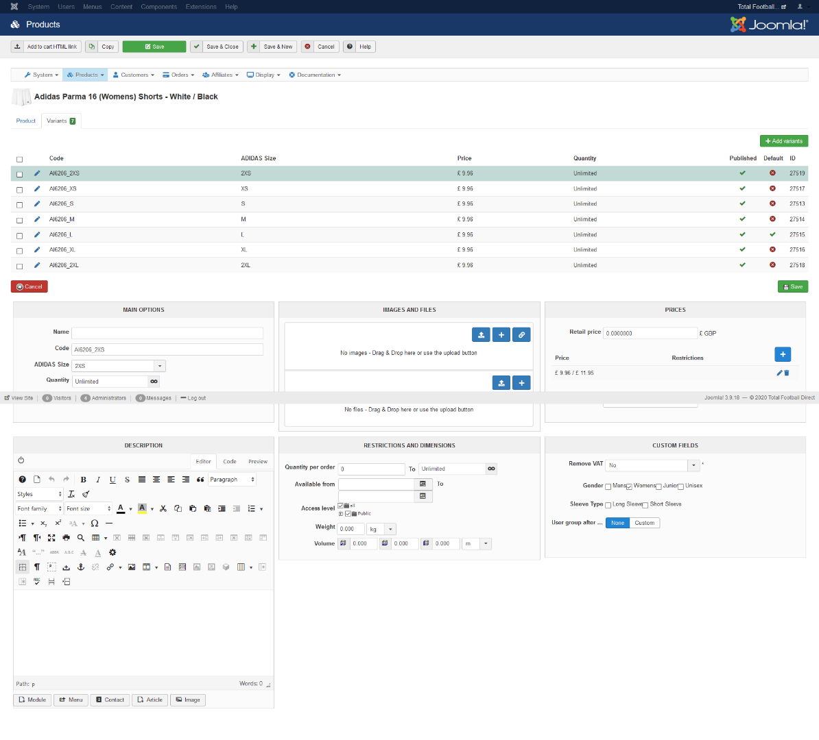

Hi.
I'm trying to update the prices of variants via CSV
product_id product_parent_id product_code product_published product_type price_value price_currency_id price_min_quantity
70 0 FT7257 1 variant 18.75|15|14.0625 GBP|GBP|GBP 0|7|14
So there are 3 different price proints. This works fine for the master product, but the variants are missed. Is there a way to make that work please?
See attached example.
Many thanks.
Last edit: 6 years 3 months ago by grayt7. Reason: adding extra info

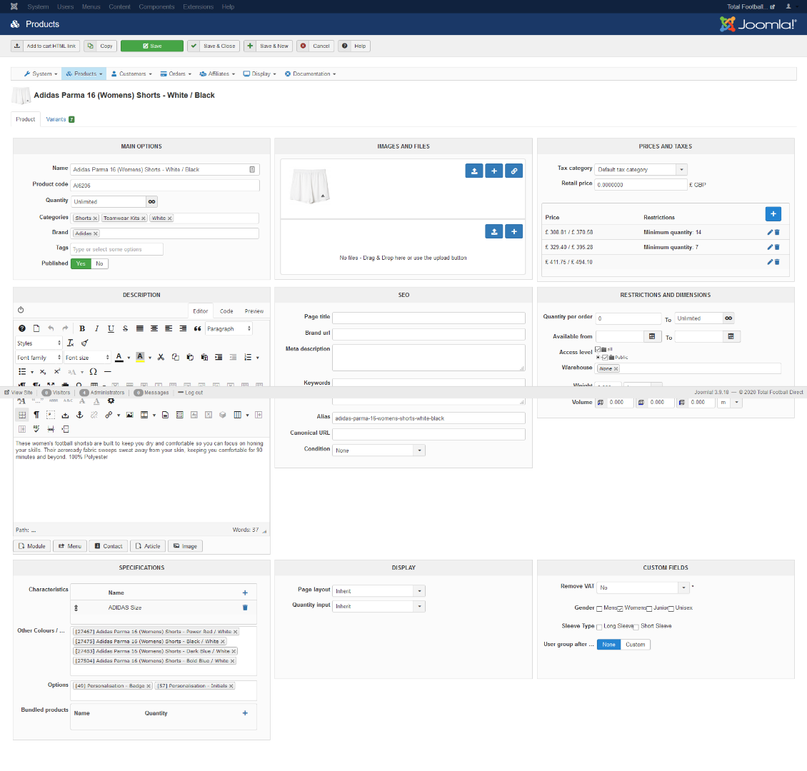

  • Posts: 376
  • Thank you received: 7
6 years 3 months ago #318173
HI Nicolas,
The latest CSV attached (which also does NOT work)
1 Has a row for each variant.
2 The variants have different prices. There are 5 different price points each have different prices over 7+ and 14+ of quantity.
3 Before the CSV was uploaded neither the main product or the variants had price points of buying 7+ or 14 + products.
4 After uploading only the main product picks up the different price points. The Variants still remain the same with no different prices or price points.
This STILL doesn't work. No matter what I do I cannot get the Variants to have different price points for buying different quantities. I have a spreadsheet with 35000 products and variants to update. But just doing 1 doesn't work.
