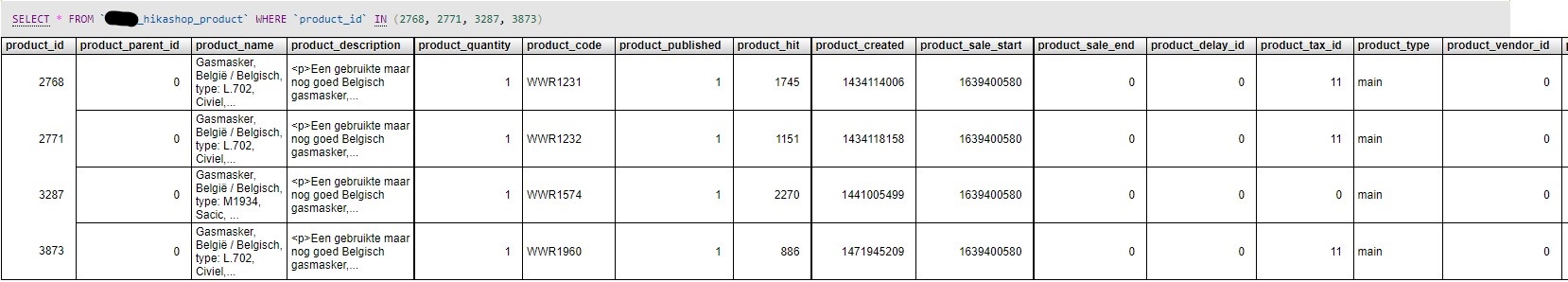

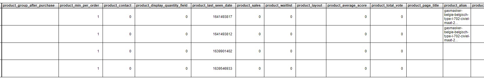

Now I have compared the products in the database that are and are not visible in the frontend. And what is striking is that the products where a save action still has to be performed, lack the "product_alias".
So is there a Mass Action that can be performed to fix this?

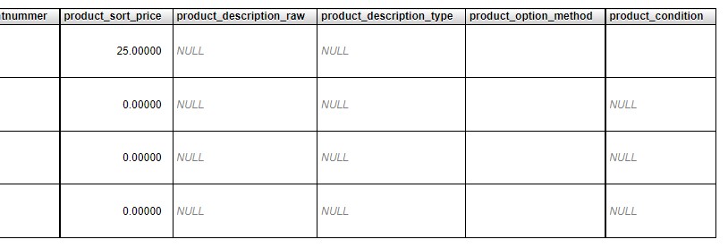

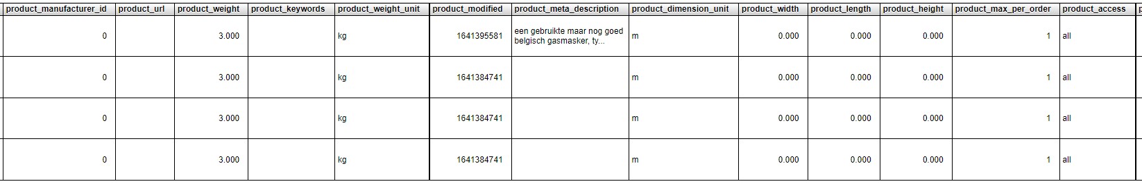

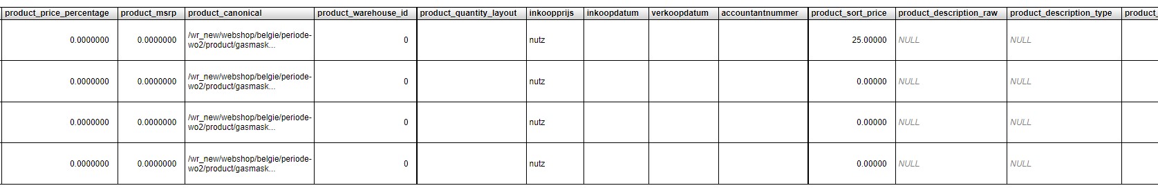

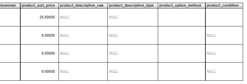

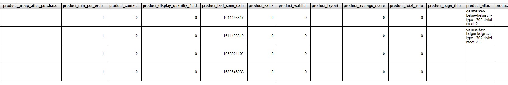

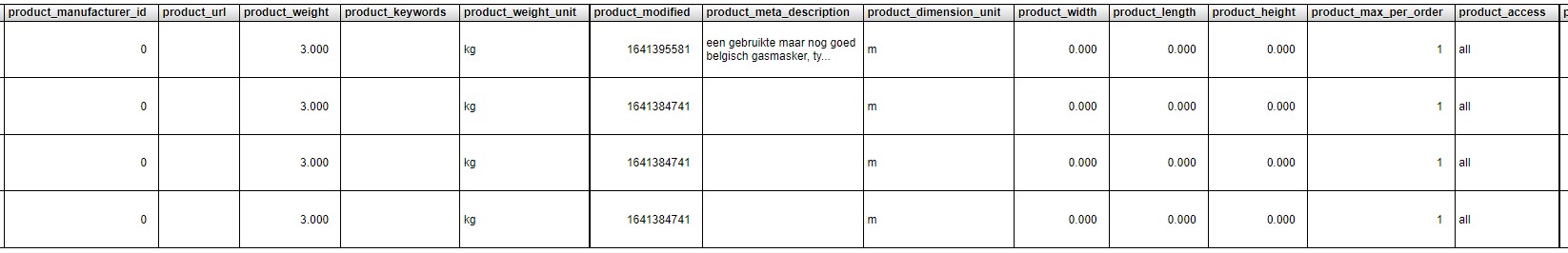

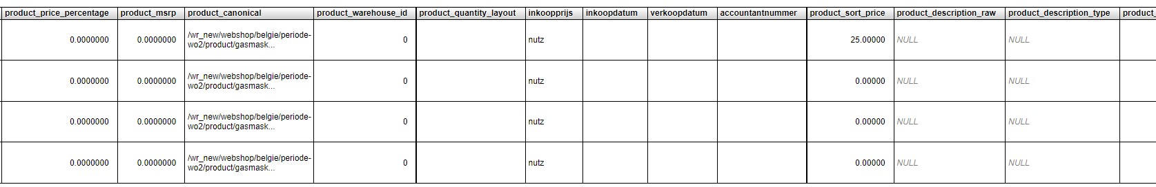

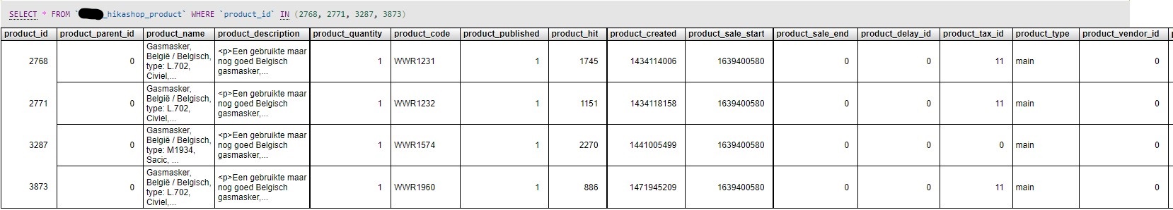

  • Posts: 34
4 years 8 months ago #338396
Hi Philip,
I just ran the test, adding the product_alias directly in the database (via phpmyadmin) to a non-worked product.
This has been successful!
After adding a product_alias to a non-working product, it is immediately visible in the frontend of the website, and works perfectly!
So I still need something like a Mass Action to fix this problem.
I've added a screenshot of the product details. This from a few even products.
Thanks!
