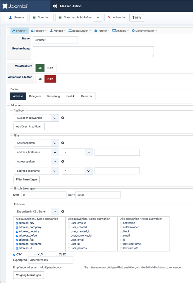

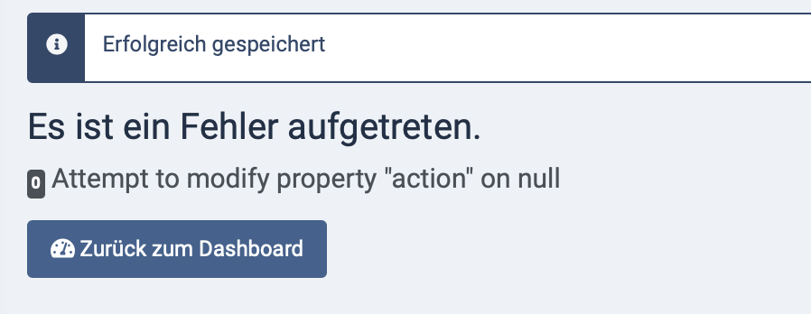

-- HikaShop version -- : 4.7.0

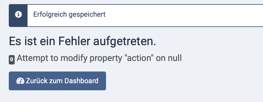

-- Error-message(debug-mod must be tuned on) -- : Attempt to modify property "action" on null
I try to export the users as CSV and get the error message:
What am I doing wrong?

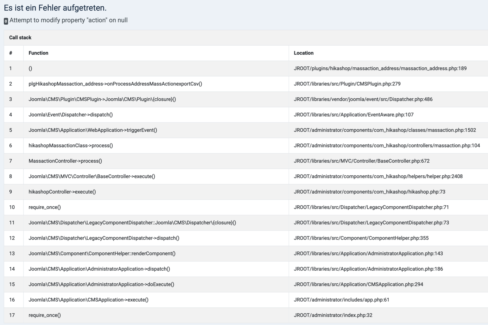

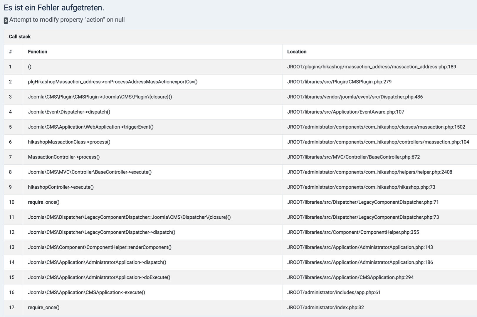

3 years 8 months ago #348011
Here the screenshot
  • Posts: 86102
  • Thank you received: 14203
3 years 8 months ago #348013
Try changing the code:
$params->action['address']['address_id'] = 'address_id';
			unset($action['formatExport']);
			$params = $this->massaction->_displayResults('address',$elements,$action,$k);
to:
in the file plugins/hikashop/massaction_address/massaction_address.php
That should hopefully fix the problem.
Please let us know how it goes so that we can include the fix on our end for the next release of HikaShop.

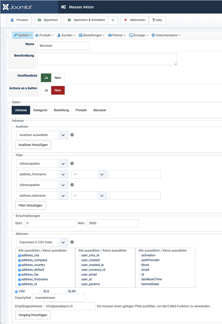

We got your accesses. However, I'm not able to login to your backend with the backend access. You didn't provide the URL of the website, so I assumed it was for paradepot DOT ch. But maybe it's for another website ? Or maybe there is a problem with the user account permissions ?
  • Posts: 86102
3 years 7 months ago #348325
Thanks ! I was able to found the issue and add a patch. There are no warnings anymore on your website. We'll include the patch on our end.

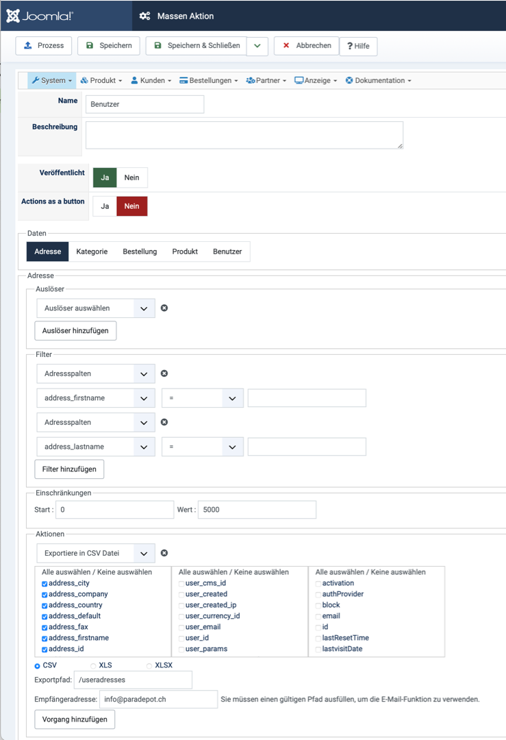

For next time, please try to be more careful with the information you provide to a support (us or someone else):
- in your mass action you had changed the selected columns to be exported compared to what you had in your initial screenshot, and that's why I couldn't reproduce the problem, nor understand why you were getting these warning messages, which should be impossible with the way you had configured the mass action in your first message.
- when I tried to add debug code with your FTP access, nothing I was doing was outputting anything. After a few tries, I understood that the files I was modifying were not used by your website. I was about to message you to tell you you provided the wrong FTP access. Just in case, I checked the folders of your FTP access and I found the "new" folder with the files of another Joomla website. And there, when I was modifying things I was able to see the changes on your website. Please mention that information when you provide the FTP access to someone in the future, unless it's obvious that the files are directly visible.

I checked on your website but it works fine for me on your website :
i.imgur.com/9N52XNQ.png
Can you double check the CSV file ?
I can see you had forgotten to specify the extension of the file in the mass action. Maybe that's why ?
