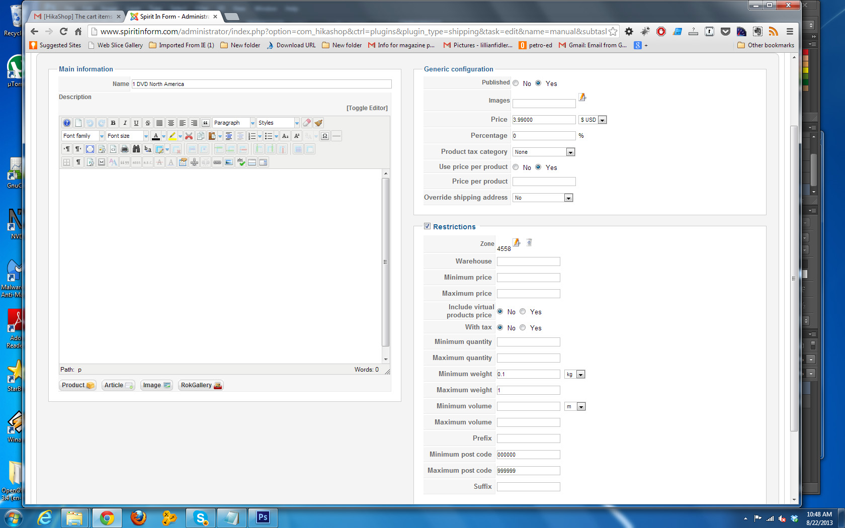

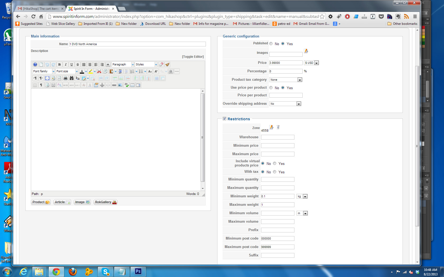

  • Posts: 18
12 years 9 months ago #120032
I updated but I get the same error, just different wording. I don't understand. I'm choosing 1 DVD with a weight of 1kg. The shipping methods are two, one for north america and one for international and the shipping method for one cd for each is based on the weight of 0.1 kg minimum to 1 kg maximum. I'm getting this error also before the system knows which shipping address I'm choosing. If I go further and sign in or create a new account, the shipping calculation is done correctly however.

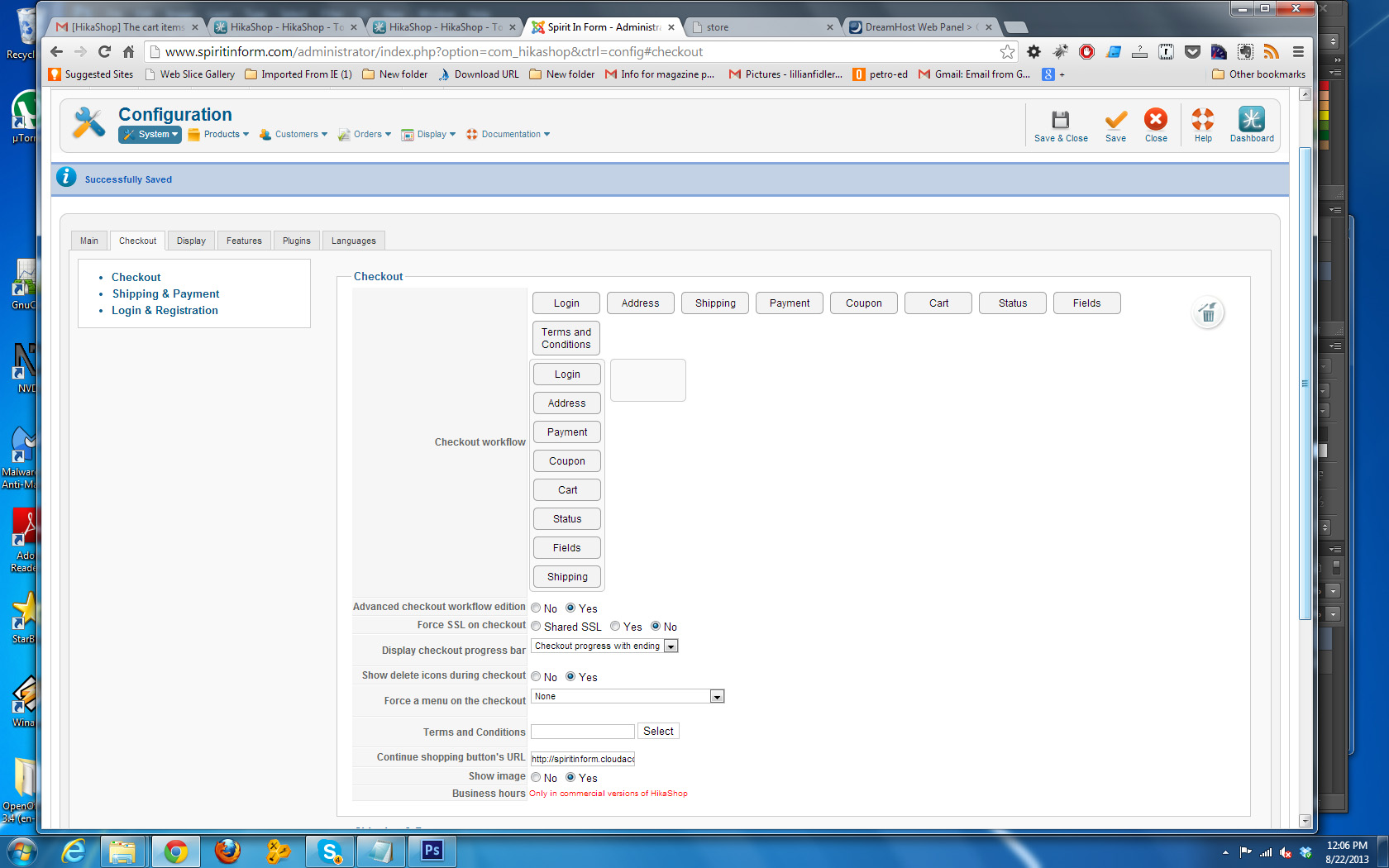

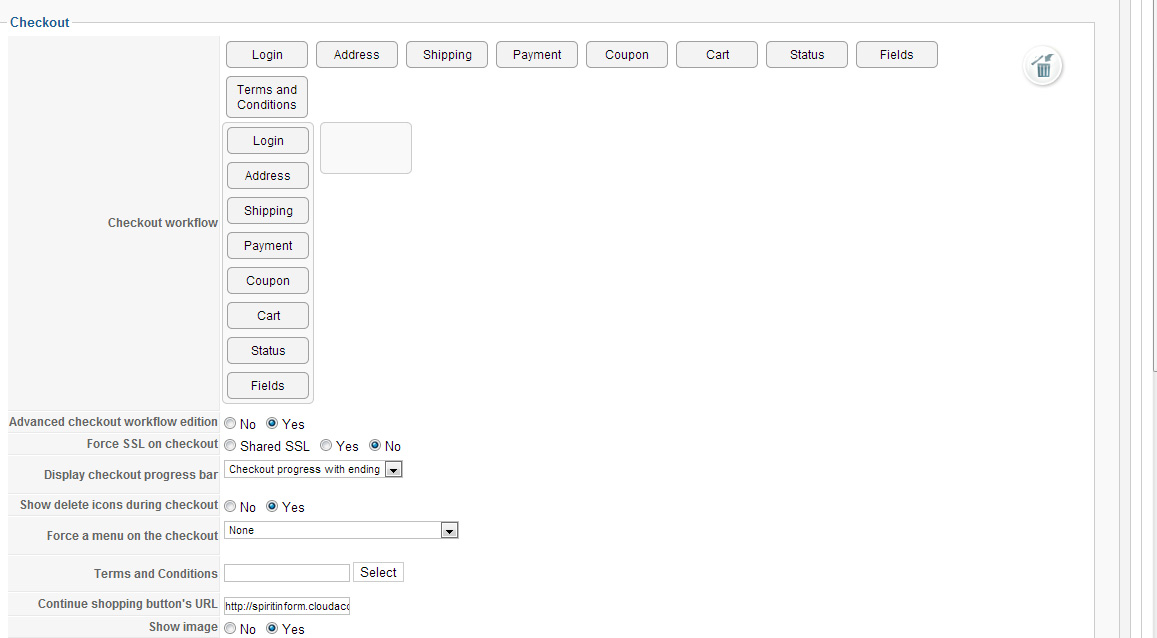

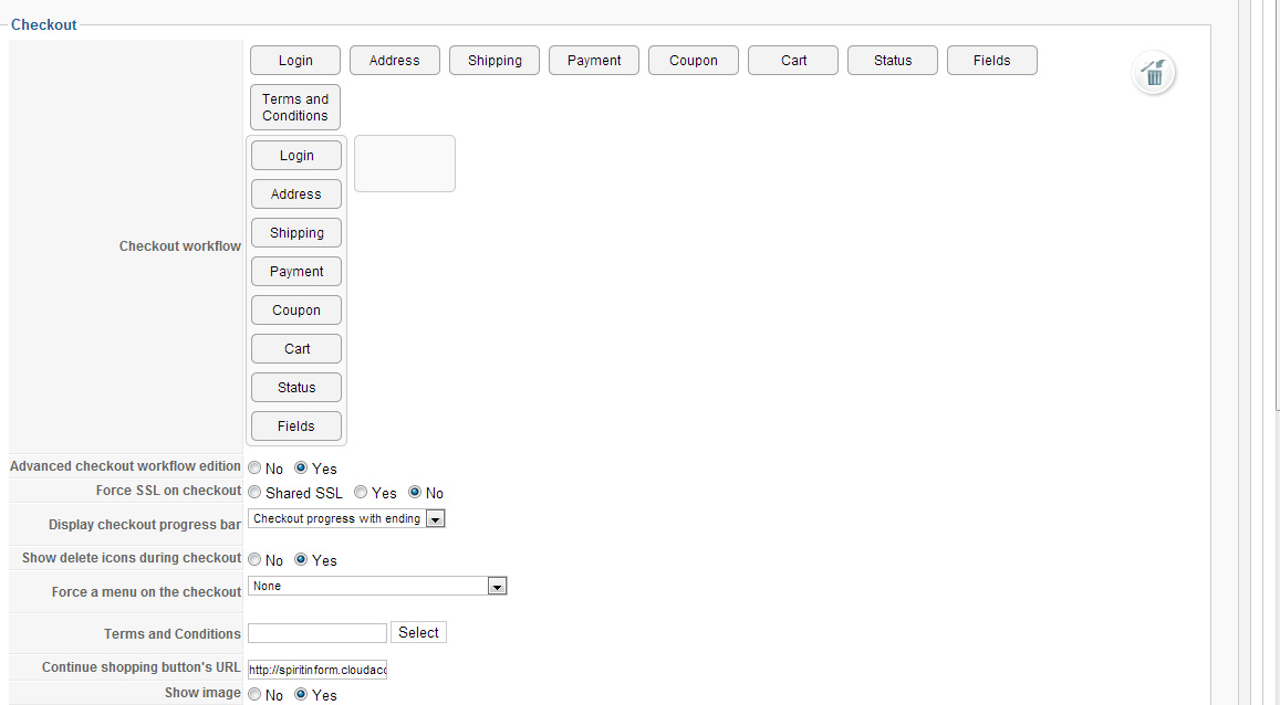

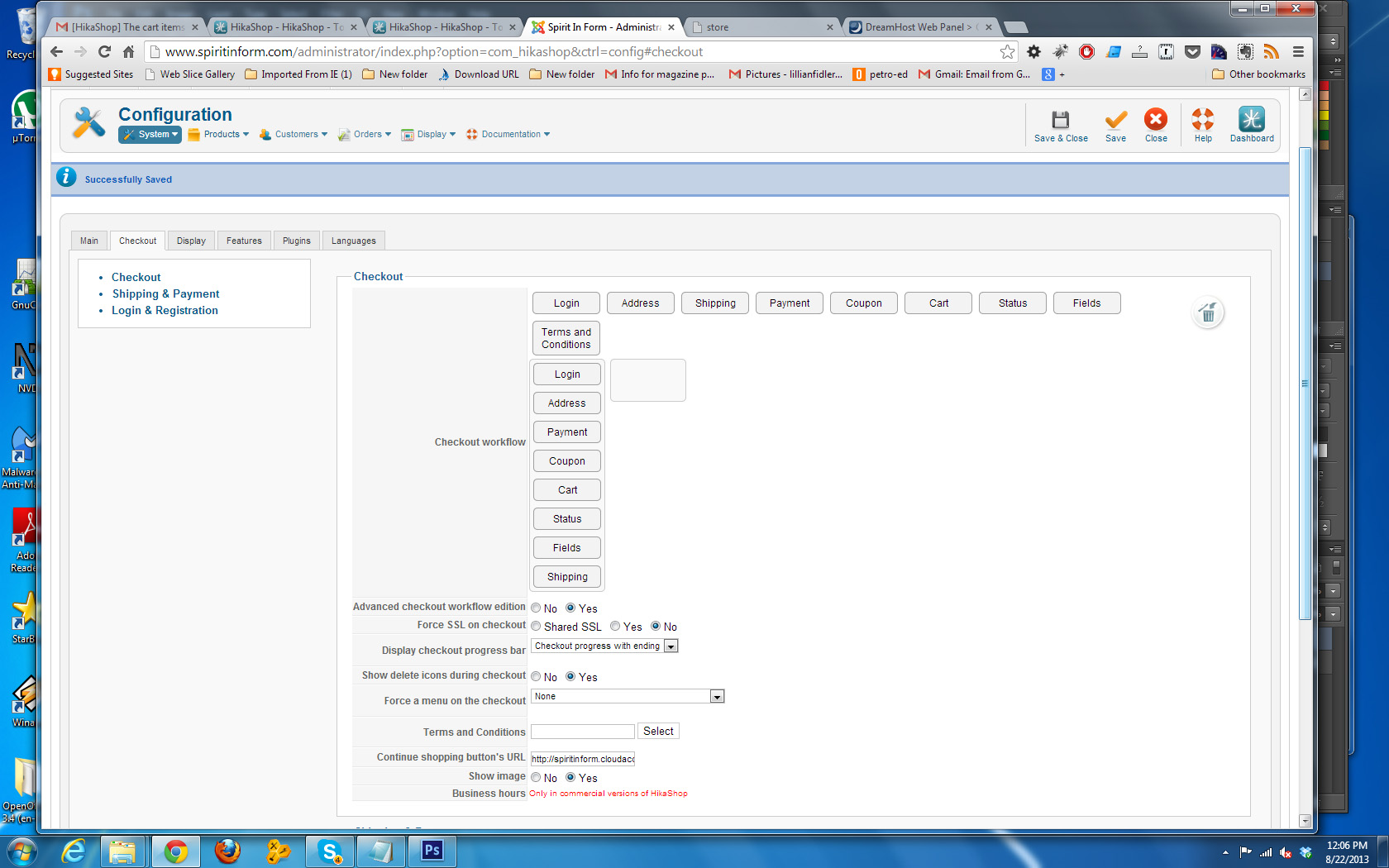

  • Posts: 18
12 years 9 months ago #120058
I tried chaning the weight, but nothing changed. I tried moving the 'shipping' in the workflow, but it wouldn't move, it kept bouncing back to where it was. Maybe I'm doing something wrong. Anyway, I've attached the screenshots of the workflow and the shipping method. thank so much!
  • Posts: 2334
  • Thank you received: 403
12 years 9 months ago #120076
I think you were trying with the shipping box at the top, try with the one on the left.

  • Posts: 18
12 years 9 months ago #120079
Hi There, it's definitely kg... I changed the shipping but could only put it at the bottom, can you have a look at the attachment and let me know if this is ok? It's still showing the error though... thanks so much!
