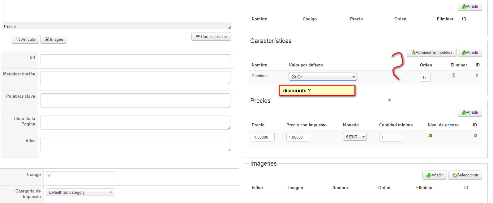

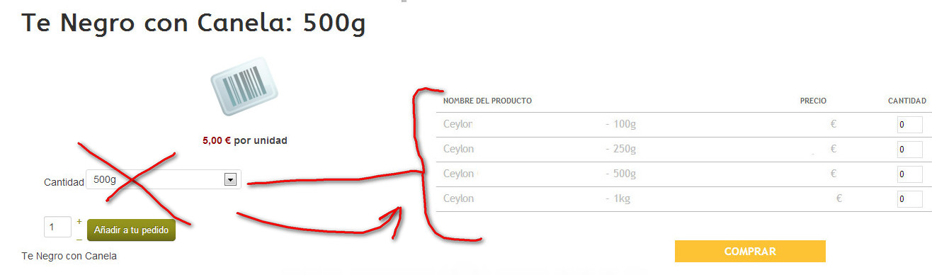

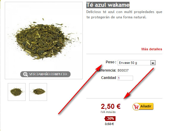

I'm doing tests with HikaShop for a coffee shop and have a question:
I can not find how to set different prices for container-Weight
I created items with different weights and prices
then in the main article, as I put these articles options but does not go as I want, as attached example has to leave. I can help
would have to come out as the image "precios2" different prices according to quantity
thank you very much

13 years 1 week ago #120469
I think that the solution will only be to set different prices regarding your product variant.
You'll be able to do it by using the "manage variant" button through your product page.
Hope this will help you a little.

13 years 4 days ago #121499
The issue is that you created several products and then added each one as an option of the product.
What you need to do instead is to create only one product with a characteristic containing all the quantities and then add that product as the option of your main product. Here is an exaplantion with an example of what to do:
www.hikashop.com/support/documentation/i...ct-form.html#options

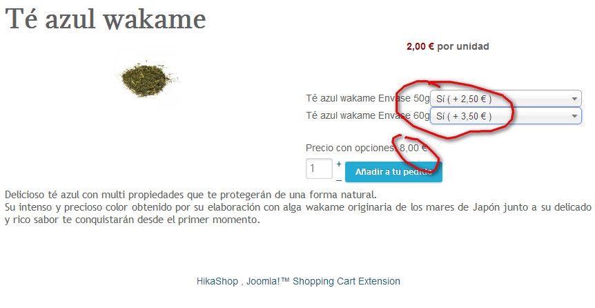

The ejemplot they have is to put the same add with the same price but if the accessories are always a different price there is an easy way to create items with different prices, according to the weight.
according to the image they send
article 1
100 GR € 1
200 GR € 2
300 GR € 3
each item has a different price, can not find how to do it easy and fast.
regards

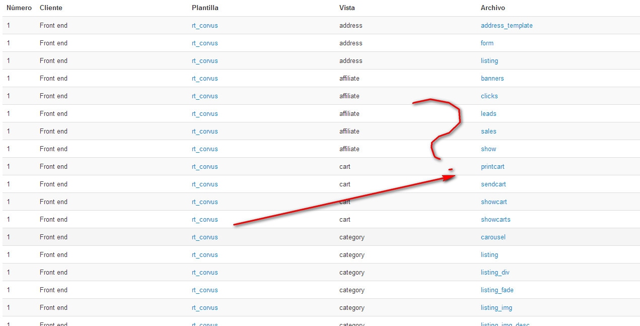

12 years 11 months ago #123814
You can change the view, sort table. Deputy example
You can override the view in "Display > Views".

12 years 11 months ago #125519
For the characteristics, if you want to set different prices for different variants of the product, you need to click on the "manage variants" button of your product edition page and then edit each variant to set its price.
And as Jerome said, if instead you want to add a discount, you can do that via the menu Orders>Discounts

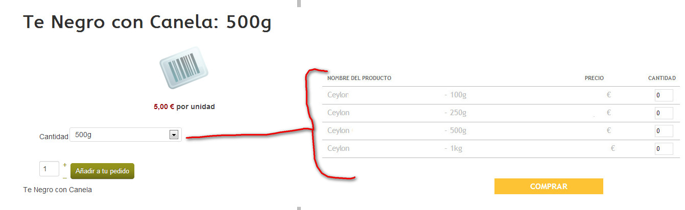

Thank you very much for your help
have not I seen the menu orders, discounts. I estava looking at items.
the design theme, according to the attached image, I'm interested in the view table format, with all the options on one screen, you may have to schedule or if you have to schedule it can be adapted? be wanting to know price
attached as quit now, and as would have to leave, with all options on the same screen
regards
  • Posts: 86095
  • Thank you received: 14199
12 years 11 months ago #125592
You can change the "Characteristic display method" option of the configuration of HikaShop to "List" in order to have such display.

12 years 10 months ago #126622
We have a nice online documentation which will help you to find easily the options.
www.hikashop.com/support/documentation/5...ig.html#main_product
Characteristics selection method : You can choose between three possibilities for the characteristics selector: 1/ a dropdown for each characteristic 2/ radio buttons for each characteristics 3/ a 2D table layout where you will have a characteristic options as rows and another as columns with one radio per possibility. Note that this third option only works with 2 characteristics per product. If a product does have a different number of characteristics, they will default to the dropdown display.

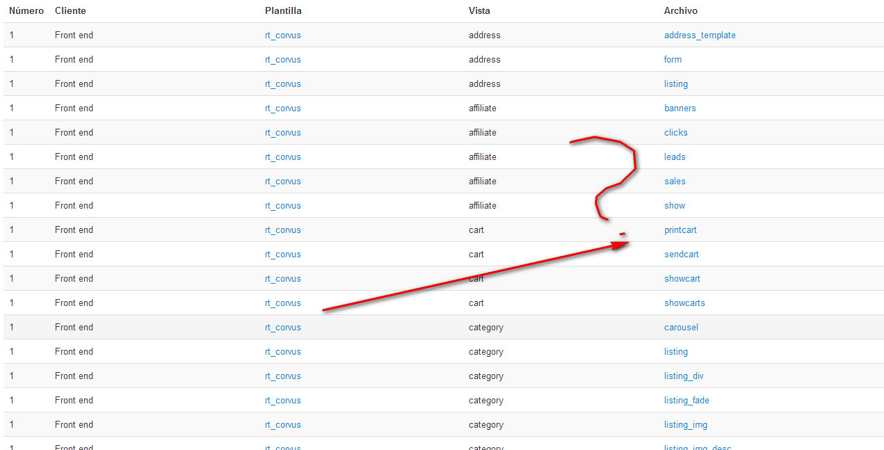

12 years 10 months ago #127720
I could help.
I can not find where to configure the screen article view tables (items with options) attached image.
I have proven in
system / settings / products / features selection method (tables)
can be done by changing some other option? or must be programmed?
in each product will be more than 5 options
thank you very much
12 years 10 months ago #127743
I do not understand anything of your last message...
Nothing at all...

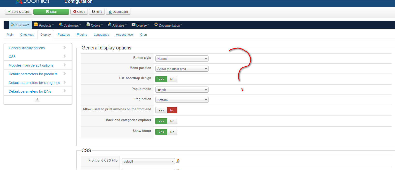

  • Posts: 23
12 years 10 months ago #128620
Hi Jerome
The problem is I do not understand the answer REF.126622,
I can not find where are the screens to configure the view (REF.125548 image)
has to come out like the picture, with 5-8 items in one screen.
thank you very much
12 years 10 months ago #128659
HikaShop configuration > Tab "Main" > section "Product".
