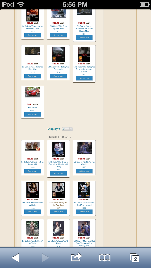

On the frontpage of the shop are double images. However, they are not visible in the back-end. Any idea what's going on? :unsure:

12 years 11 months ago #122106
12 years 11 months ago #122114
Ok,
I think that you'll just have to delete the content module which have the ID number 125 through "Hikashop->Display->Content modules".

12 years 3 months ago #158029
Thanks to edit you product listing menu via HikaShop > Display > Content menu.
Then for the option "Associated modules..." click on select, disable all the associated modules, click on "OK", then save the menu options, and the duplicated content should have disappeared. :)
