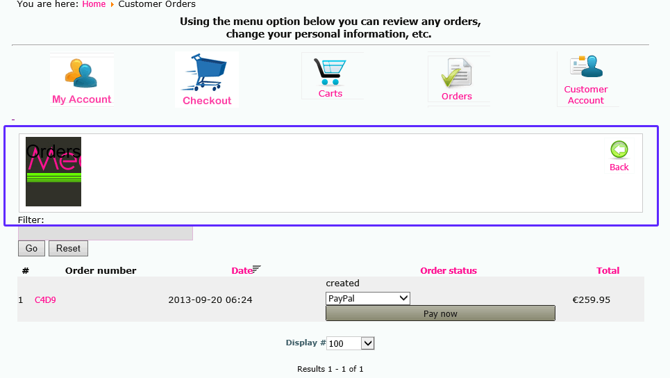

Customer Orders Screen
  • Posts: 38
12 years 11 months ago #124483
- index.php?option=com_hikashop&view=order&layout=listing
I wish to remove the area enclosed in the blue box as the display looks bad and I don't want the back button. I wish to have my own menu system based on the menu options available in the Hika section of the Menu Item Type.
I will want to remove this section from all possible choices listed.
Is this possible and if so what do I need to do?
Many thanks
Last edit: 12 years 11 months ago by fireballxl5. Reason: wrong image
12 years 11 months ago #124510
You have to override the view "order | show".
  • Posts: 38
12 years 11 months ago #124512
I'm sorry but I have no idea what you mean when you say;
- You have to override the view "order | show".
12 years 11 months ago #124657
To override a view, you have to go through the menu Display > Views, then in the listing select the view to edit, and edit the HTML code.
In your case, and as Jerome said, you have to edit the view "order / show".
Here is more documentation about how to customize the layout:

12 years 11 months ago #124720
I just checked, and the link is a valid one.
Thanks to try again.
