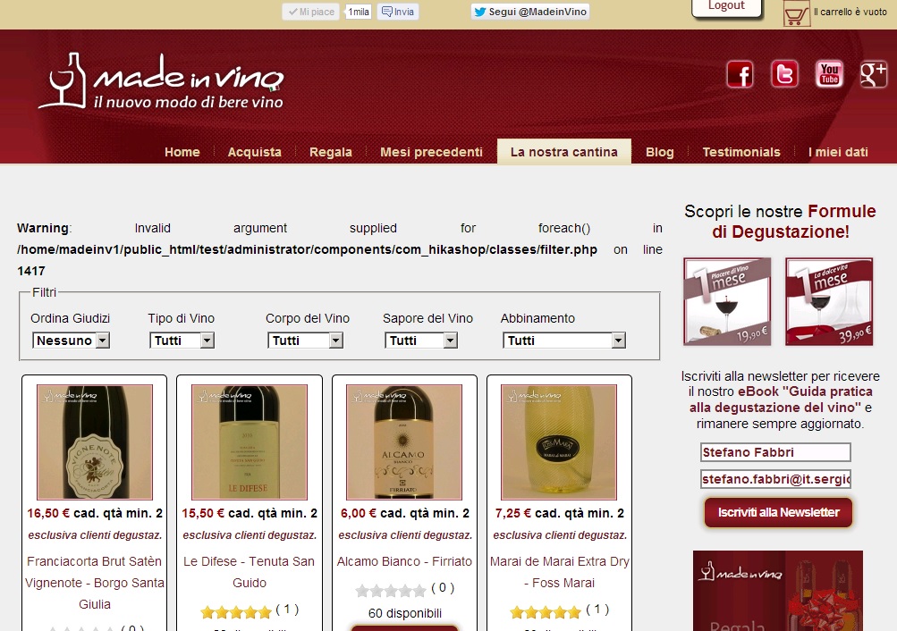

Hello
I am installing the new release in my test Environment. In production www.madeinvino.com I have the versione 2.1.2.
With this new release there is a warning when I open the product page.
Warning: Invalid argument supplied for foreach() in /home/madeinv1/public_html/test/administrator/components/com_hikashop/classes/filter.php on line 1417
Is something connected with this release? Could you fix it?

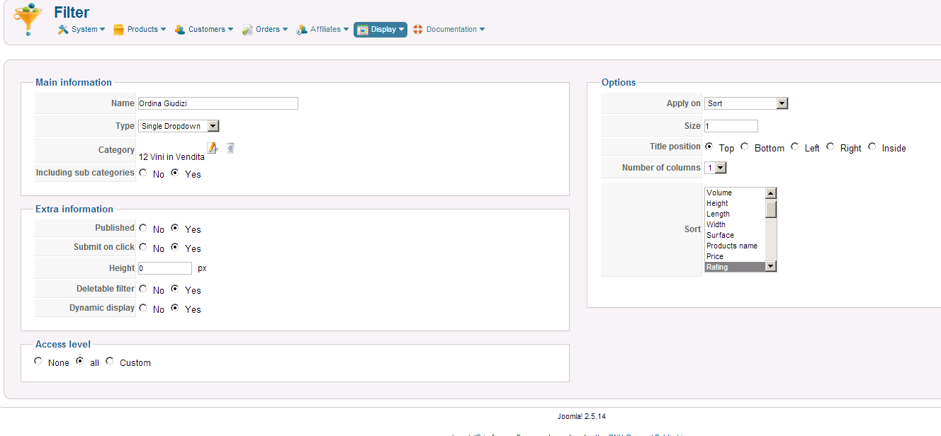

12 years 11 months ago #124860
It looks like you have a sort filter but without a sort value.
Can you tell us more about your filter (sort) configuration ?
  • Posts: 184
  • Thank you received: 4
12 years 11 months ago #124888
you are right, is something related to this sort filter.
Some products haven't the rating.
If I disable this sort filter the warning disappears.
Could you fix it?
