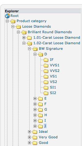

trying to work with exporter... It appears I am getting only two columns in the excel file (tried CSV, same also). See the excel file I have attached.
I have attached a screenshot of the categories created that I am trying to repeat....
It does not make sense to me that the categories are 4 deep yet the excel spreadsheet has it two deep only and throws categories underneath everything....

12 years 11 months ago #125346
It's normal, the export is correct.
Ex of a category tree:
Main
- Category A
-- Category A-1
--- Category A-1-a
- Category B
-- Category B-1
In the file it will look like:
parent_category, categories
,Main
Main, Category A
Main, Category B
Category A, Category A-1
Category B, Category B-1
Category A-1, Category A-1-a
Via this two columns, we can have unlimited number of subcategories.
We only attach the sub to the main, the sub of the sub to the sub, etc..
