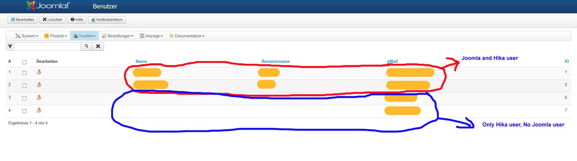

EDIT: No Joomla user is created but Hikashop user are created. Without name just with e-mail.
EDIT2: The Hika part of the registration is Ok. All data are there. By the Joomla part, name and username is missing and that's for sure the reason why the Joomla user will not be created. After registration no error message appears but the screen stay on an empty content page with this URL: www.wp11204424.server-he.de/index.php/co...kashop/user/register maybe there should be another button which is not shown???

What about my problem? It's really urgent, the site shall go online. Everything is ok so far beside the login/register problem. It can't be a big problem because the Hikashop user is created just the Joomla user not. As you can see in the screenshot it is most likely because the username and name of the Joomla user is missing.

Yes if there is no username in the HikaShop user list, it means that you have an HikaShop user but not a Joomla one.
It is the "guest checkout mode", where we do not create a Joomla user.
