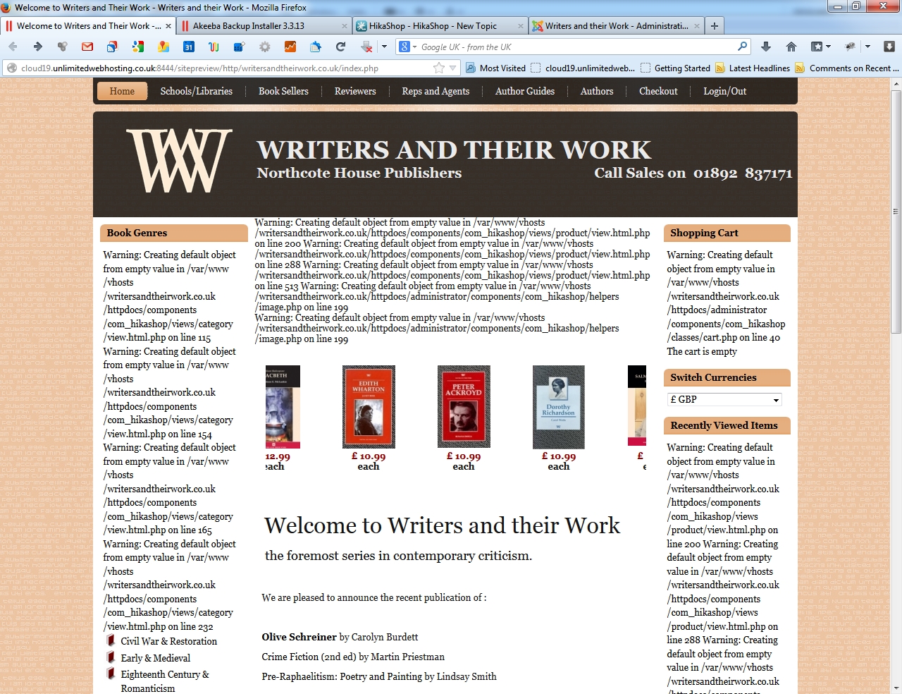

I have just restored my site to a new host and their is issues when i preview the site. The actual site is still running on the old host at the moment. Attached is a screenshot of the errors which mostly point to view.html.php file.

12 years 11 months ago #125924
HikaShop 1.6 was not PHP 5.4 compliant so it will display warning notices.
You can update HikaShop yes. You can also deactivate the PHP notices which should be disable in production mode (much better).
It is not real errors, just warning notices ; it does not generate any kind of problem instead of display something in your page.
