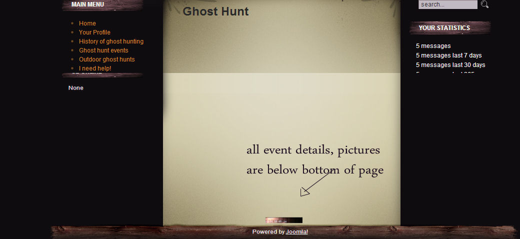

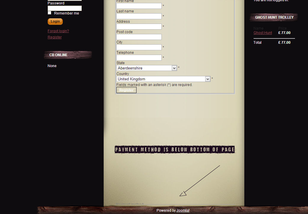

Hi Everyone
I have a big problem which i will try to explain the best I can.
Once you click on a product a page loads which should display all the information etc. On that page the title of the product loads correctly at the top of the page as it should but all the remaining information including photos are BELOW the bottom of the page, if you look at the photos attached you will just see the picture of the product.
2. Also on the checkout page the registration part loads correctly and in the correct place but once again the "payment method" etc loads below the bottom of the page as you can see from the photos.
Can someone please help me correct this. I really would appreciate help with this
12 years 10 months ago #127380
The problem is the "clear:both" in your template.
I don't know why but, when an HikaShop element do a "clear:both", it is pushed at the bottom of the div.

  • Posts: 86095
  • Thank you received: 14199
12 years 10 months ago #127447
The issue is that you force the height of the main area of the page to be 1067px in hard in the template.
So you first need to edit your template's main index.php file and remove that height attribute in the main area.
I would recommend to contact your template provider for help as this is not normal.

12 years 10 months ago #127643
The problem is not the "clear:both". The problem is that, where there is a "clear:both" in the main column in your template, it just break the design and push the content at the bottom of the page.
"clear:both" is not a problem in HikaShop and it's not a problem at all.
Your template have some design troubles which have a wrong behavior with this CSS rule which is the "clear:both".
