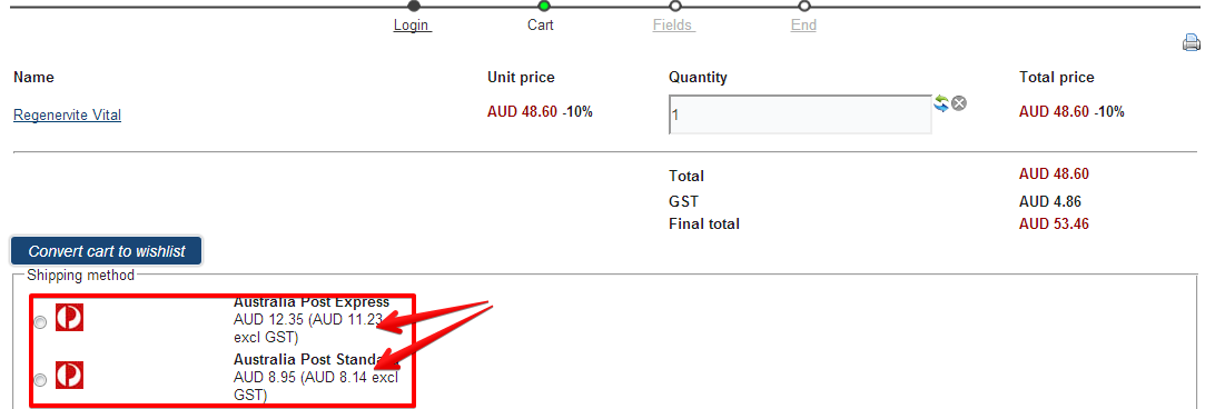

On checkout there is no option to use Australia Post to ship these products when the zone and postcode are clearly Australia. I have checked for database errors and looked at which tables are called and it appears to be correct (not an expert). I have attached a screen dump of the Aupost plugin for reference.

Hi, I tried a test profile and got the excess volume warning for Australia Post. I then noticed I had dimensions in meters and not mm, all working now and sorry for wasting your time.
