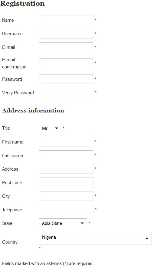

hello,
thanks. i will really appreciate it if you can assist without me having to install again.
hope this is what you meant by screenshots of the configuration for my registration form.
  • Posts: 86095
  • Thank you received: 14199
12 years 10 months ago #129148
Installing again doesn't mean that you loose any setting/data. It just mean that you get the latest version of the files of HikaShop.
This is a screenshot of the registration page, Mohamed was asking for a screenshot of the settings of the Registration section of the Checkout tab of the HikaShop configuration page.

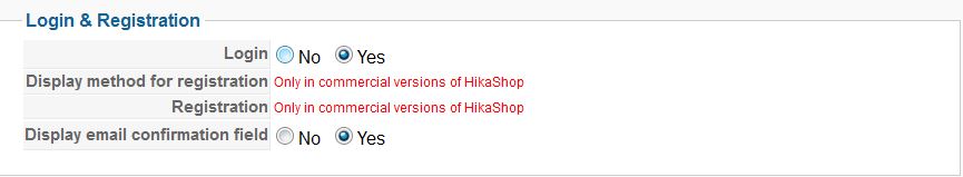

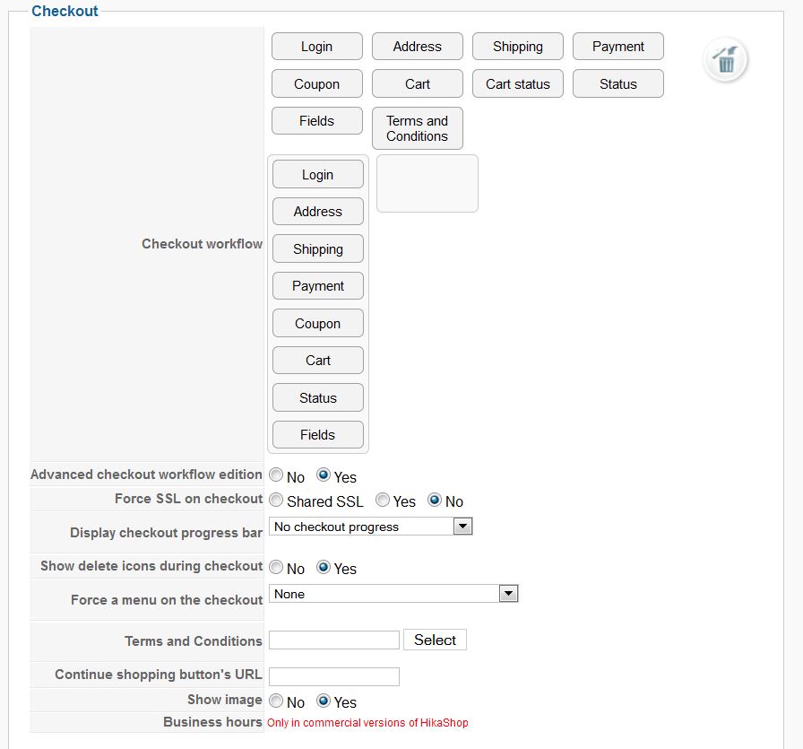

  • Posts: 7
12 years 10 months ago #129197
thank you for the clarification. i am new to this and appreciate you for taking time to explain. please check this out
12 years 10 months ago #129237
You'll find the "the Registration section of the Checkout tab of the HikaShop configuration page" through "Hikashop->System->Configuration->Checkout->'Login & Registration section'", can you show me through a screenshot how did you configured it ?

  • Posts: 7
12 years 10 months ago #129241
hi Mohamed,
thanks. this is the screenshot and link- organandmusic.com/subscription.html

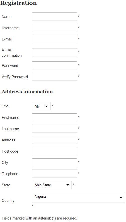

12 years 10 months ago #129265
This error message don't seem to come from HikaShop.
It looks like a ReCaptcha error message, if you don't write the same code than the one displayed in the picture.
Thanks to disable any ReCaptcha module present on your website and try again.

12 years 10 months ago #130449
As you can see, there is no "ReCaptcha" in your registration form, so it is logical that the plugin can't validate anything because the user can't enter anything.
We don't which version of HikaShop you are using, which precise version of Joomla you are using or which "System ReCaptcha" plugin you are talkng about.
But for most I can see, you have du disable it if you what that the registration works good.

  • Posts: 86095
12 years 10 months ago #130712
The default recaptcha plugin of joomla is not compatible with hikashop's registration form. You need to use instead the plugin that we provide here:
www.hikashop.com/support/documentation/7...-with-recaptcha.html
If you don't see the catpcha on the registration, it means that either you didn't enable that plugin (maybe you enabled the wrong one) or you didn't configure it properly, or you have some cache on your website preventing you from seeing the change. So please check that the recaptcha plugin that we provide is correctly installed and configured and that you disabled the cache of your website and that should definitely work.
Regarding the currency display, simply edit your currency via the menu System>Currencies and change the format option as explained in the documentation (I invite you to click on the "help" button when you edit your currency in order to understand what to put there.
