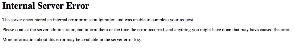

Thanks... I installed the plugin and when I tested it with a purchase... I got an error message (see attached)
Second question... where and how do I replace the order_creation_notification by order_administrator_notification ?

That message doesn't give the exact error. Please look in the php error log of your server for the fatal error message so that we can understand why you have that error.

This is not a php error log. Please ask your hosting company if you don't know where to access it.

I talked to my web host folks and no PHP error was generated... what you see is the error message that was generated.
I don't know if this helps...but the TEST purchase went through and the PDF attachment was just right... unfortunately the customers sees the error message. I have disabled the plugin until this gets sorted out.

How come no error is logged when the server itself says that there is an error ? I've never seen that.
What you posted is a default error message generated by apache (your web server) saying that an error occurred during the php processing. But was we need is the php error message (which should be logged) which is generated by the php engine when a problem happens when it processes the page.
Without the PHP error, I don't know why this happens and thus I can't say what to do.

UPDATE - All is working now. It was an issue with my server. The web host said...
"I have increased the PHP memory limit to maximum at .... Now you will be able to checkout the products without any issues"
