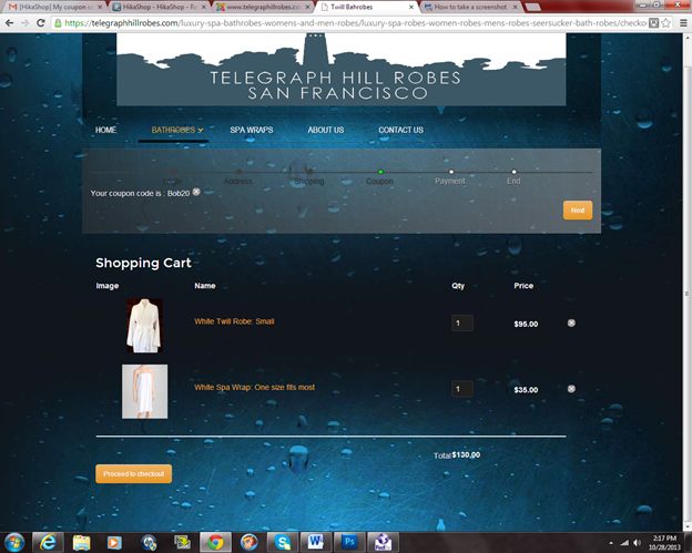

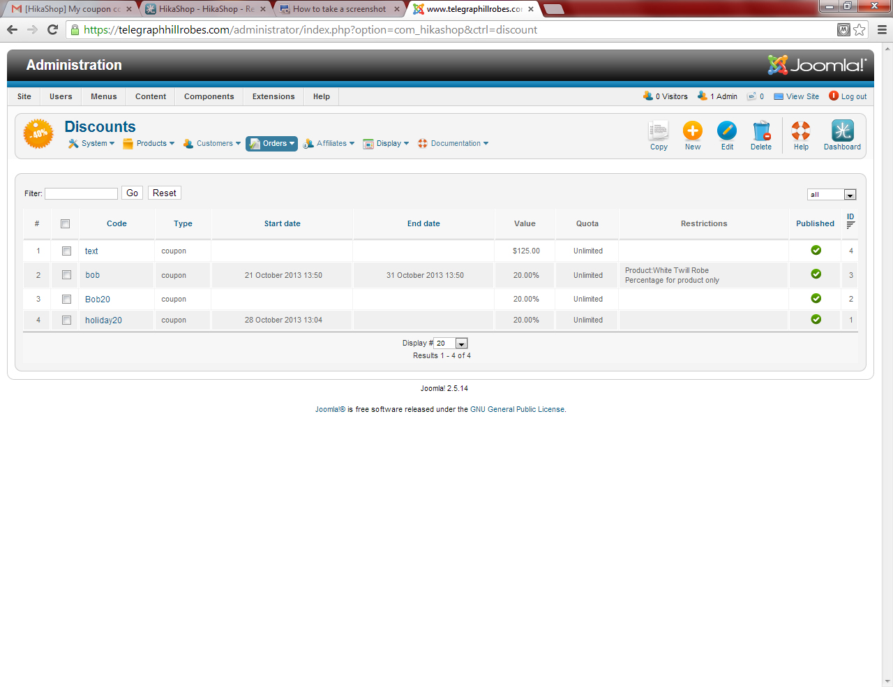

Please do a screenshot of the options of your coupon.
  • Posts: 50
12 years 10 months ago #129956
I have done many coupons and at checkout when I input the code, I get no coupon discount displayed.

The coupon value will only display in the cart view of the checkout, not in the cart module. Your screenshot shows the cart module, not the cart view of the checkout, so it's normal that you don't see it there. You should display instead the cart view of the checkout on the checkout, and not the cart module.

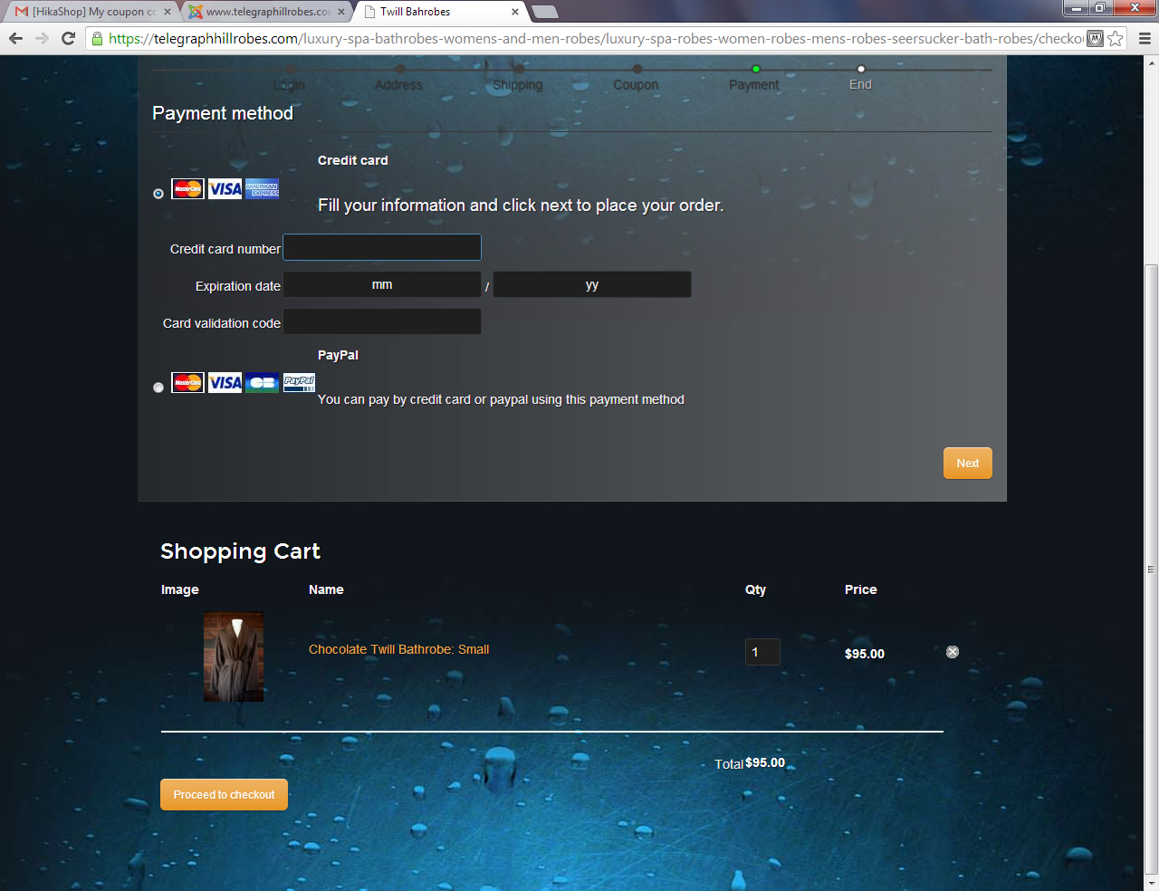

Hello, this is another problem. when I try to pay with the credit card, I do not see the coupon effect and do not see the tax applied to the product either
What module do I have to enable ? all the products have tax properties and the coupon and tax do not show in the end
12 years 10 months ago #130106
The Joomla cart module which is displayed under your checkout page is not the checkout cart.
Please add the element "cart" in your checkout workflow.
