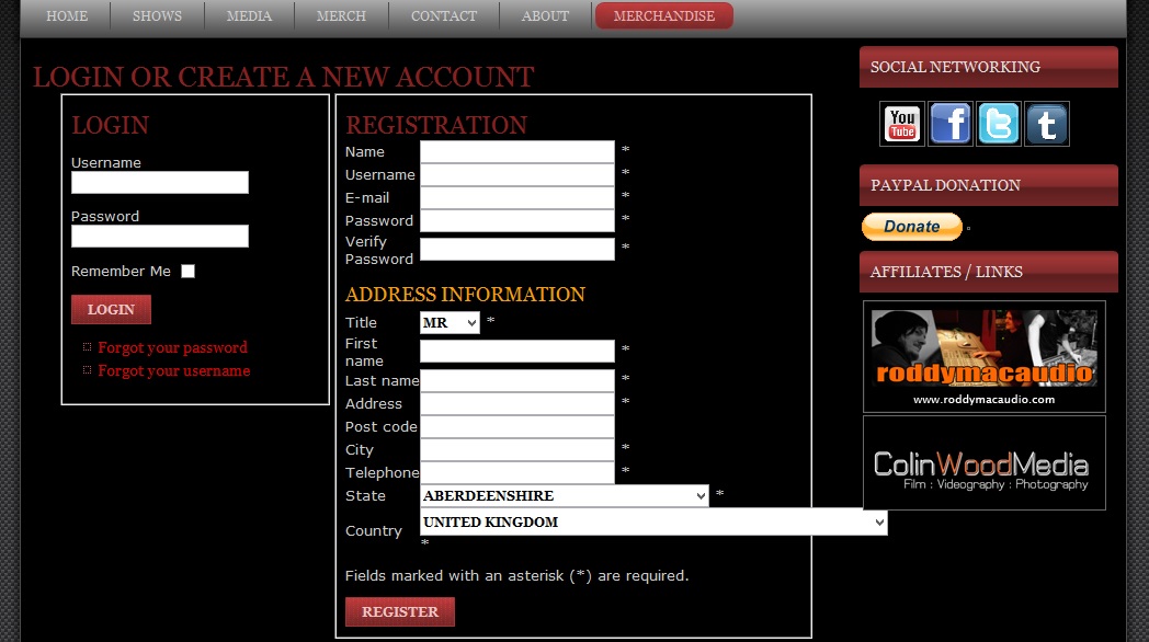

I've just started using HikaShop and I am currently having problems with the address country width field. It is too long for my page and it ends up over the top of my side bar. Here is what it looks like.
I understand this has to be changed in the CSS file but I am having trouble finding the line that relates to it. Any help would be appreciated.

12 years 3 months ago #155436
That's quite easy:
#address_country{ width: 100px !important; }
