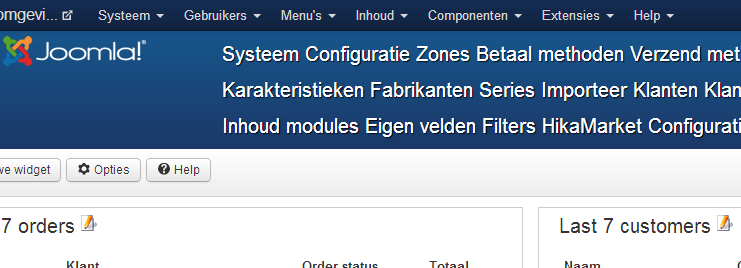

I upgraded my joomla 2.5 to joomla 3.1.5 and now the hikashop menu in administrator is not working.
Please have a look at the screenshot.

You have a problem with your menu, you need to change the option "menu position" of the Display tab of the configuration to "above the content" as it is by default on Joomla 3.

Thank you. It works.
