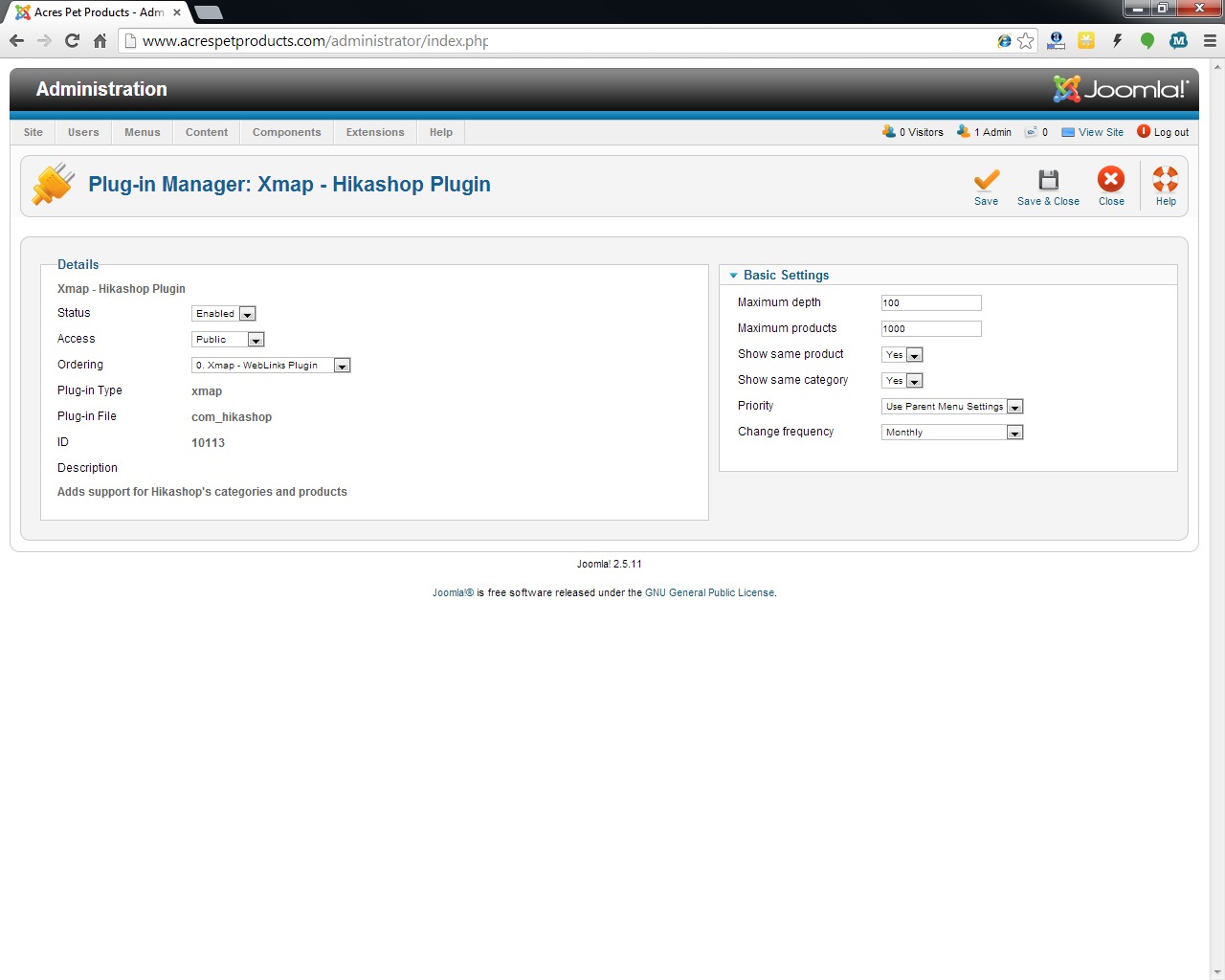

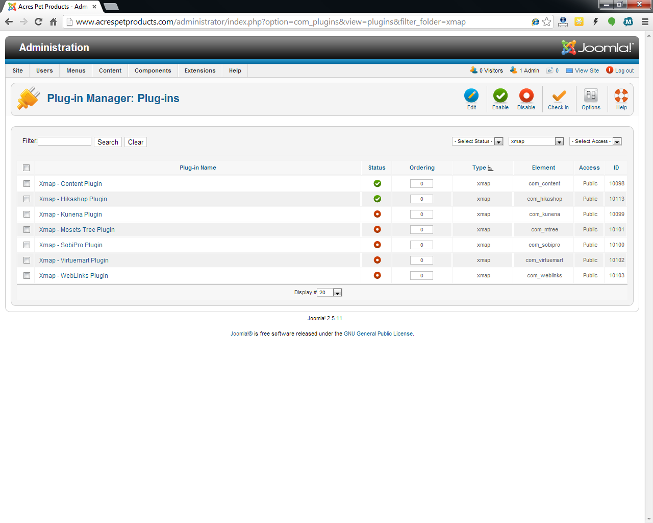

The Xmap - Hikashop Plugin is enabled and the Basic Settings are:
Maximum depth: was blank have set it to 100 - no change
Maximum products: was blank have set it to 1000 - no change
Show same product: Yes
Show same category: Yes
Priority: Use Parent Menu Settings
Change frequency: Monthly and have tried Weekly

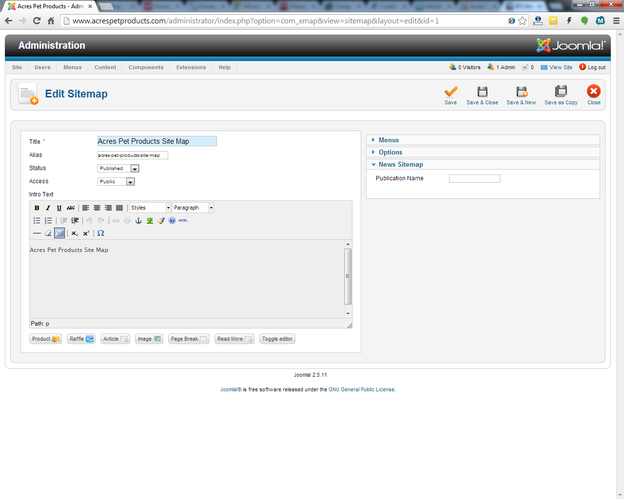

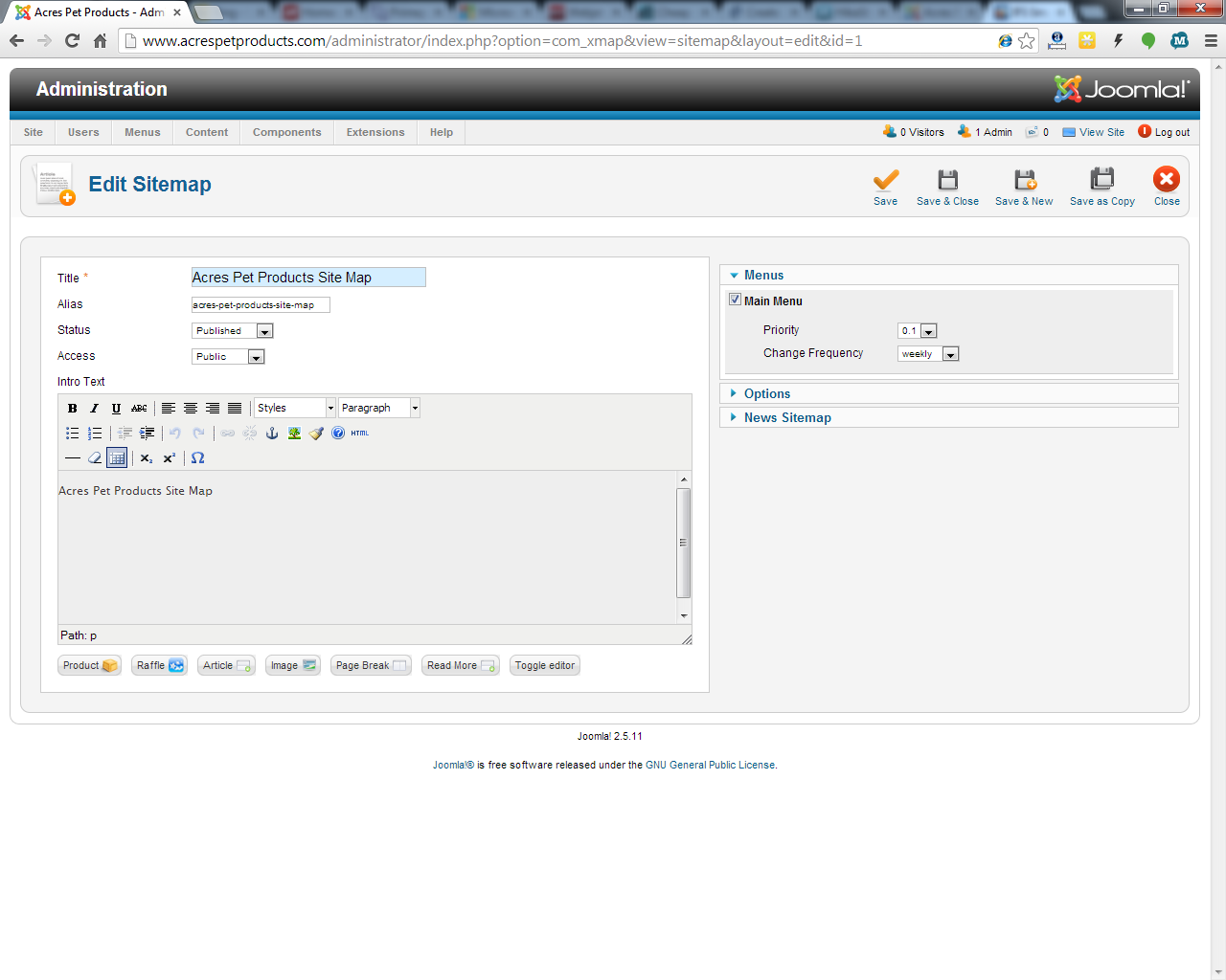

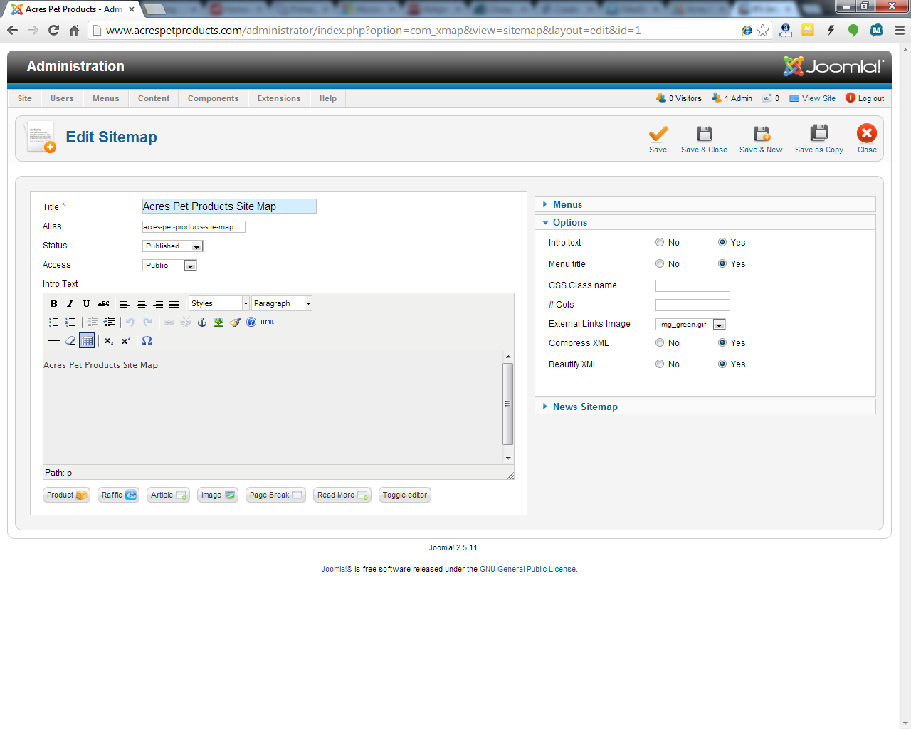

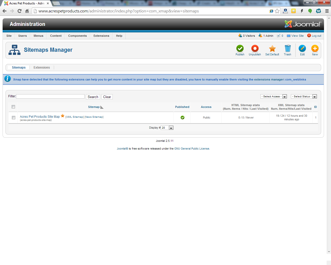

12 years 10 months ago #130803
In your XMAP component options, do you have selected the HikaShop menus for the display ?
Thanks to give us a screenshot of that configuration, the screenshot of the menus tree and the screenshopt of your plugin configuration.
  • Posts: 20
12 years 10 months ago #130872
Hi Xavier
Hopefully I have got it all for you here.
All the best

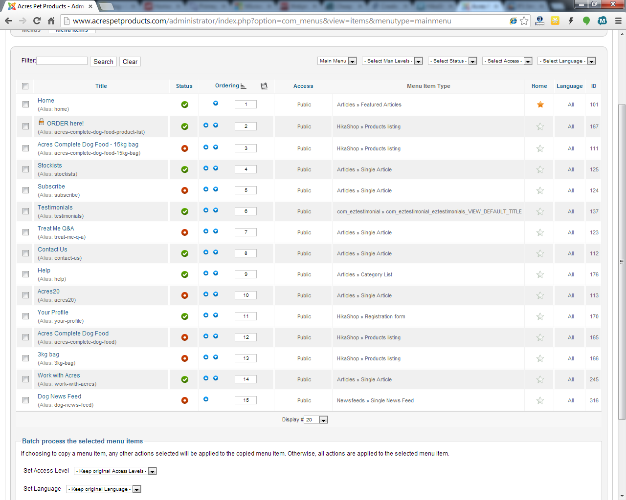

12 years 10 months ago #130933
Thanks for the plugin configuration, now I need you menu tree in the Joomla > Menus option and the configuration of the menus in Components > XMap > Menus
  • Posts: 20
12 years 10 months ago #130996
Hopefully this is what you need :)
All the best
