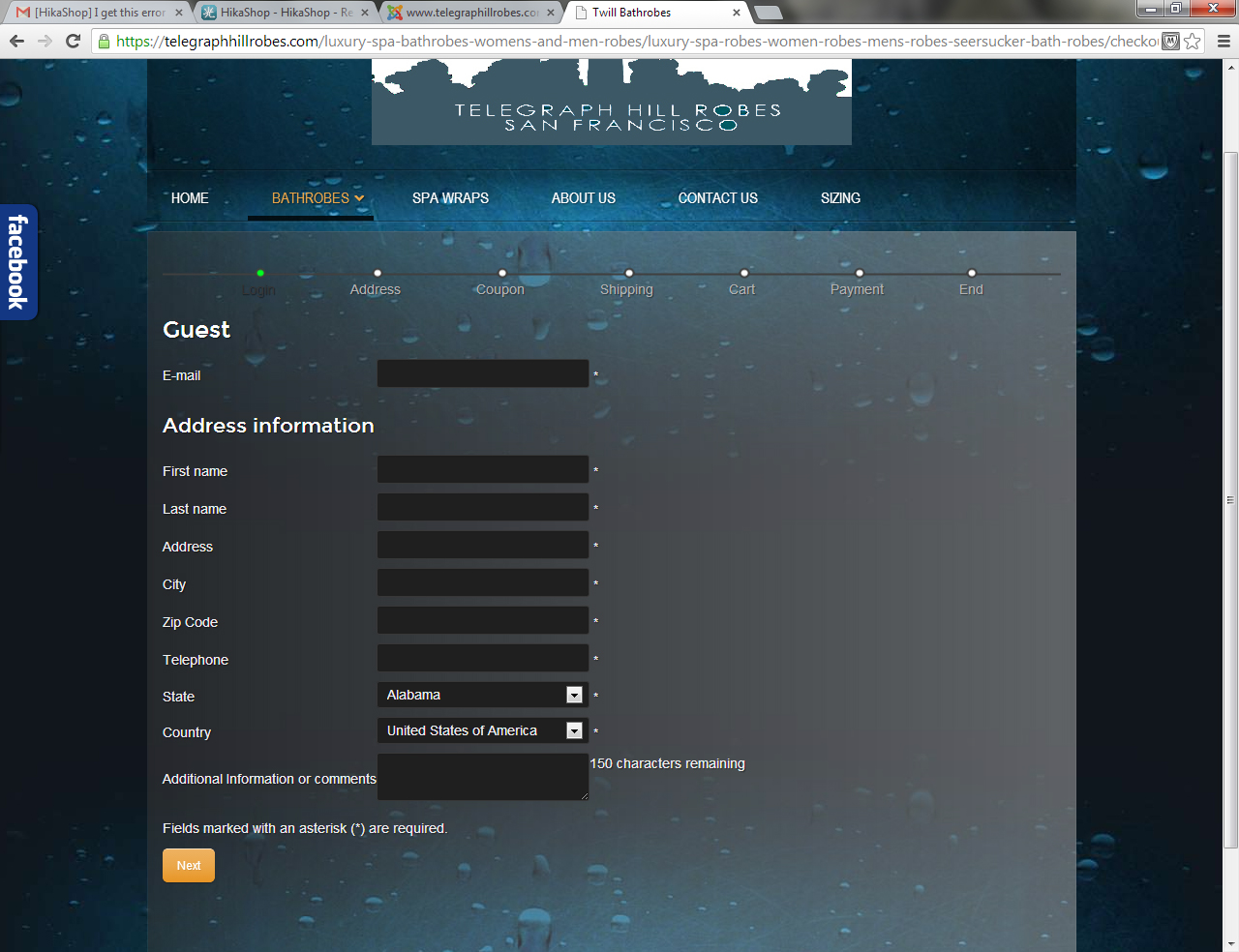

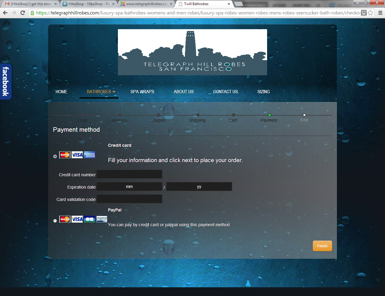

Thank you very much. I just upgraded it and it work fine, but now I guest this text at the end
I need to remove the word "Guest"
and need to replace the word "finish" with "Place Order"
I went to the language file and can not find these word to replace
I attached the pictures for you to see

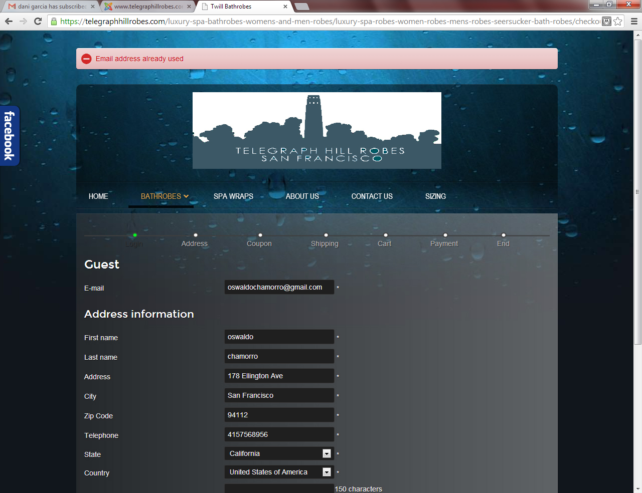

Ok, so I have my check out as Guest. and when I want to place an order I get this email that says
email already in use. I am sending you a picture. Why did i upgrade it ? just to get more bugs
12 years 10 months ago #130988
You have this error because you already have a Joomla account with this email.
It is logical that you can't use an email which already have a joomla account in your website.

You can use a translation override to change any text in HikaShop, including this one:
The "Guest" word is near the end of the translation file.
