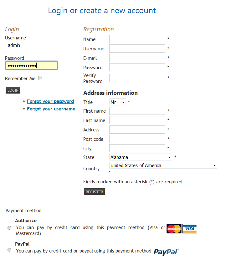

Mohamed, thank you for your reply and your will to help me. Here are the steps I take and screenshots attached for each step.
Step 1. I go to checkout and log into existing account.

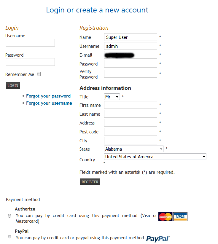

Step 2. After I hit "login" button, the checkout page is refreshed with no error message, but looks like I am not logged in. As you can see on the screenshot, it inserted my username into the registration controls.

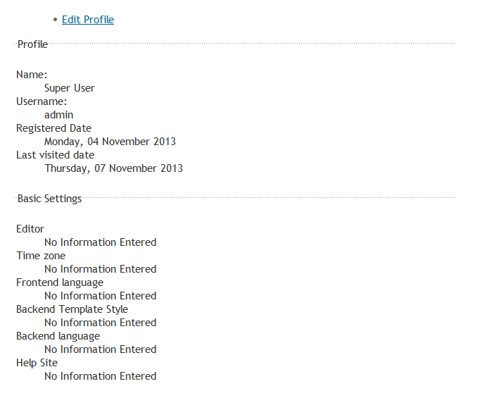

Step 4: I go to my Joomla profile /component/users/?view=profile - it shows my info there proving that I AM logged in.
