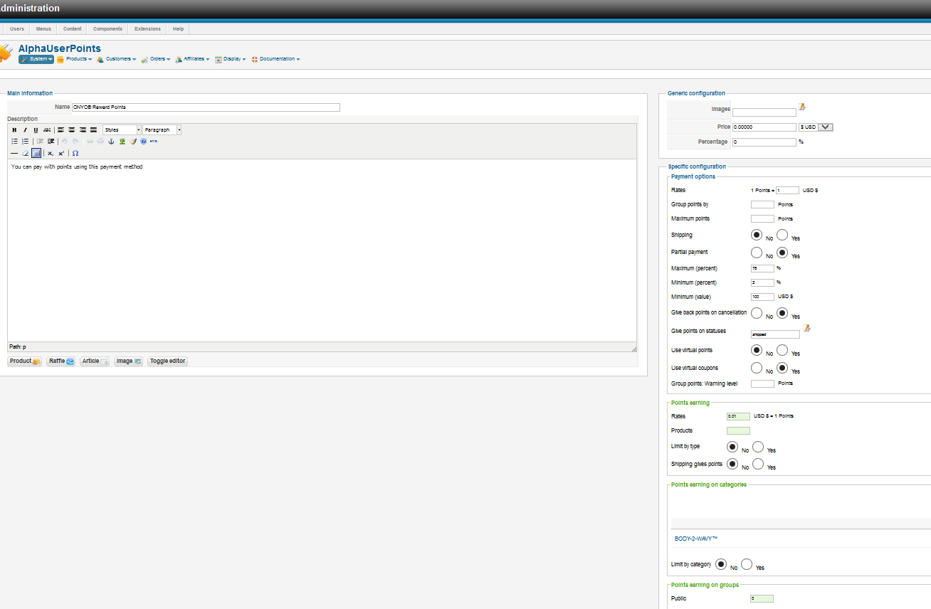

I need to set this up so that point to ratio will be 1:1, this means a customer spends $100, they will get 100 points. I am not sure what I am doing wrong because it gives customer 1000 points instead of 100 points.
Any suggestion including image if necessary will be helpful.

Could you produce a screenshot of the options of your user points plugin so that we can see how you set it up ?

I need only one screenshot. One from the pages where you have the options of the plugin.

I have this.
12 years 9 months ago #131772
You have configured:
1 point => $1
$0.01 => 1 point
I don't think that it is what you really want.
Please set "1" for the "point earning" part, so you will have your 1:1 ratio.
