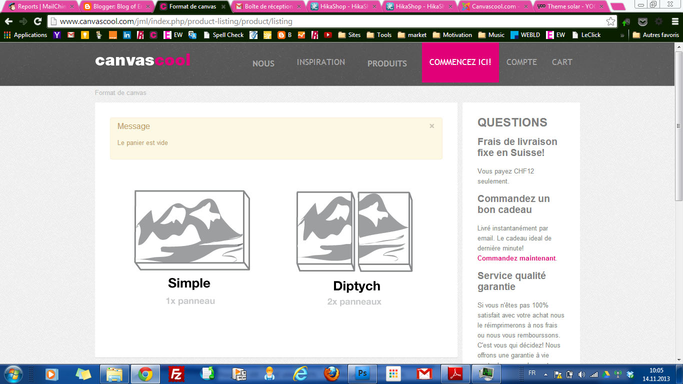

In "system/clear" cache I cleared the cache / template and cleared the expired cache
After I selected a product and loaded a picture and clicked "add to cart" here attached is the message I get instead of the checkout page with the listing of the product,options, and picture I selected.
