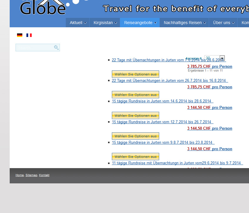

I have attached a picture how currently a list of all my products are displayed. There are mainly three problems
1. How can I get rid of this "Anzeige #20"
2. What needs to be done, that the whole list is displyayed on the screen
3. Is ist possible to manipulate a little bit more on Div display beside the parameters within Shop module?
Basically I would like to keep a kind of list, but more nicely.

1. You can turn off the "show pagination" option of the configuration.
2. I'm getting the whole listing on the page on my end with Chrome but you can always use a CSS margin-bottom on the listing in order to increase the margin area at the bottom.
3. Besides the options in the menu/module, you can edit the view files of the view "product" via the menu Display>Views for your frontend template and change the PHP/HTML code there to really display it like you want.

Some changes i was capable to do, but mainly not. Maybe there is another way, because I'm not at all skillfull in php programming.
Is there a possibility to display the categories/products within an article maybe throug a modul with {loadposition xy}
Thank you very much

If you add it in the description and that you set your listing to the item box layout "image and description" you will get the module displayed for each element of your listing.
