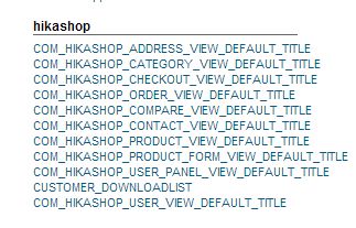

I've an issue because of the creation of Hika shop menus in the backend,(Joomla 2.5)
If I want to create a menu of the hika shop there are strange descriptions showing
in the list an there are less than in your demo shop.
see picture.
Can sombody explan to me plaese?
Tom
12 years 9 months ago #133303
Hi Tom,
1. Can you check if these translation words are translated through your translation file ("Hikashop->System->Configuration->Languages->YourLanguageFile")
2. if these words are already translated,can you turn on the language debug option of the Joomla configuration and display your website. At the bottom of the page, you will have a red area telling you which lines of the translation files are not correct.
Then, you'll just need to fix them
  • Posts: 26
12 years 9 months ago #133315
I've checked the language file and there's no problem (everything is translated fine)
But also if I swich on language debug in joomla there is no error shown at the button of the page . All translation are correct.
Only If I create a menu there are wrong translations shown in the lightbox of joomla :huh:
  • Posts: 86095
  • Thank you received: 14199
12 years 9 months ago #133413
Then it means that HikaShop couldn't write the menu translation file in the folder administrator/languages/en-GB of your website.
Make sure that the folder is writable and save your language in the configuration and HikaShop will try again to create the file en-GB.com_hikashop.sys.ini in it which contains all the menu item types translations for HikaShop.

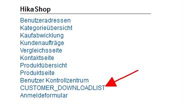

12 years 9 months ago #133448
Hi nicolas,
The rights to that folder where 755 ( ok, I think) .
But what is a part of the solutution is: to save the language file again. (I don't know why)
So it looks like (picture)
There only one entry left to translate (after saving methode) I don't know really how to do that because in the language file it's translates as well.
Now it's not a big issue for me but to be honest I don't understand the reason of that behavior.
Tom

12 years 9 months ago #133566
It basically means that you don't have that translation key in your translation file so you need to add it in the translation file textarea itself, not the override.
