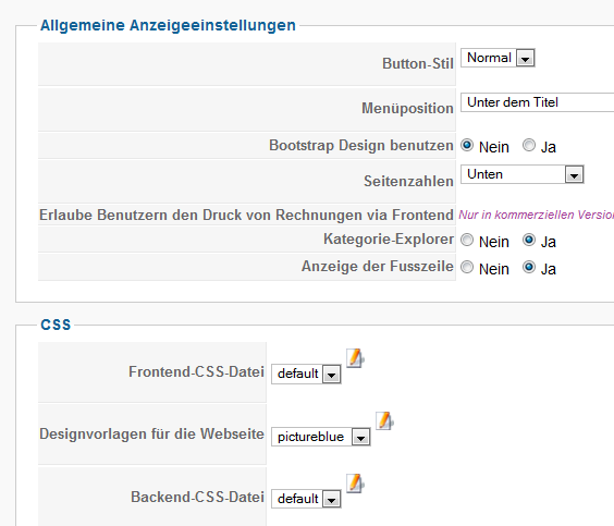

I made some pictures to explain the problems:

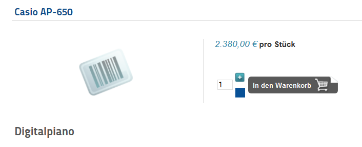

Settings of my Hikashop see (picture 6)

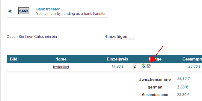

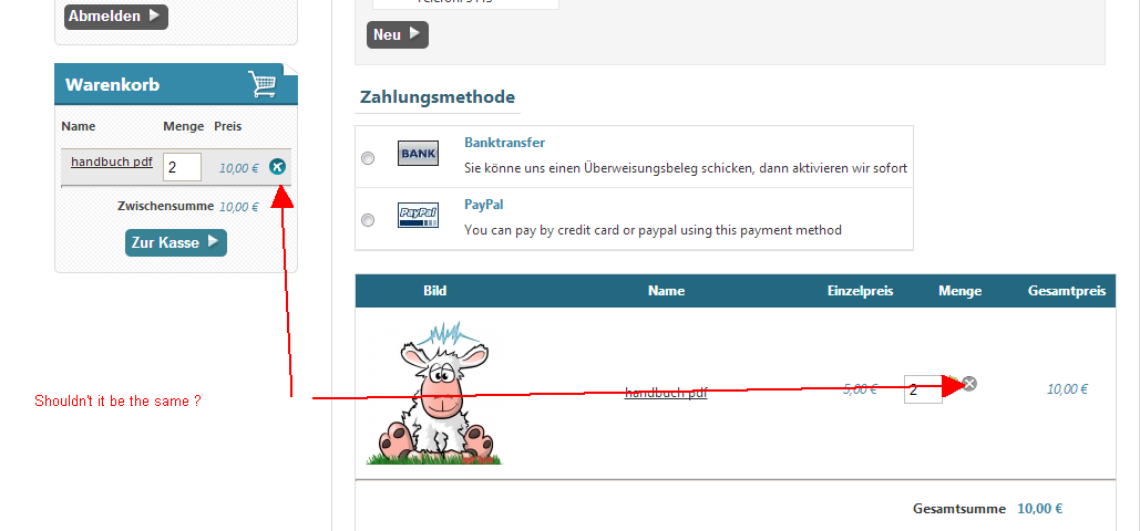

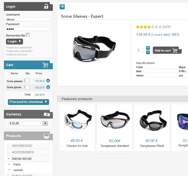

1. Buttons should look like (picure 3, shown on your demo site). On my site they are looking like (picture 4)

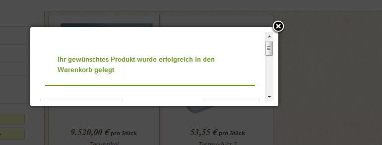

2. If I click one time on plus or minus button it looks like (picture 5) It only looks normal if I refresh the page again

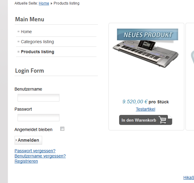

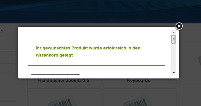

Other question: is it possible to show the whole content of the light box if it is enabled (see picture2)

I've also another question to the templates delivered by hikashop.
I thought that I get the same view like it is shown in your template preview (see pic3)
but I get only the view (see pic2) What do I have to do to change it like it looks on your site ? Especially the menus on the left doesn't change her views after installing your template (I'm a little bit confused about the handlind of the templates. :blush:
(You can see it also on my link (see last reply)
Tom

Please try to put one content of my site into the card, you will see (pic10)
It looks strange doesn't it ( this is a problem of the template??) You have to scroll to see what is insite the popup.

First, regarding the buttons, you have two choices:
1. You decide to use the HikaShop button style and thus you remove the CSS of the buttons in your template.
So you would have to remove the code:
input.button, button.button, button.validate {
background: #FFFFFF url(../images/nature/arrow1.gif) no-repeat left top;
border: 1px solid #DDDDDD;
color: #444444;
in www.it-xservice.de/joomla2/templates/beez_20/css/personal.css
or you decide to use your template's buttons and thus you remove the CSS of the buttons in the style file.
Regarding the popup buttons not being displayed, that's just because the message is on two lines in German while it's on one line in most of the other languages. Because of that, the buttons of the popup get a bit pushed down and you don't see them without scrolling. So the simple solution will be to change the text: www.hikashop.com/download/languages.html#modify

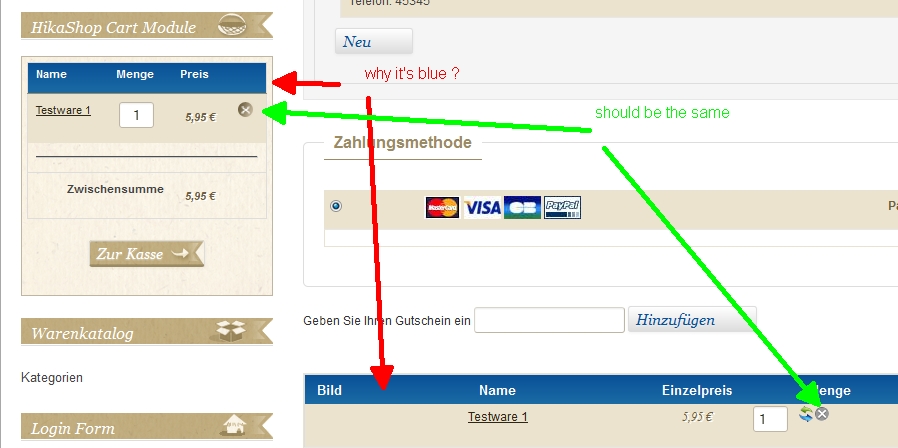

I Speak about the delete2.png file. Used as the delete button for the card module.
If I you take look at the picture on the left you see the module on position-7 with the card displayed . There's a delete button comming from your style "picture_blue". On the right you see the content of the card if the user changes to the billing process. There is also a delete button and in my oppinion it should be the same file (delete2.png) . Is that right??
Second point:
So there's no way to change the size of the popup in any of your configuration files?
Tom
Last edit: 12 years 9 months ago by tommy64.
  • Posts: 86095
  • Thank you received: 14199
12 years 9 months ago #134373
1. I'm not seeing the same page on your website www.it-xservice.de/joomla2 so I can't comment on the issue since we don't have it on our end. Please provide a link to the shop with that delete icon issue and we'll be able to tell you what to do.
2. There is a way of course. you would have to edit the file administrator/components/com_hikashop/helpers/cart.php and change the code {x:480, y: 140} with the size you want. Next version of HikaShop will have options to configure that directly in the configuration.
The following user(s) said Thank You: tommy64
  • Posts: 11
12 years 9 months ago #134396
Many Thanks!! That's what I wanted to know !
The issue with the delete button I found already so it's solved.

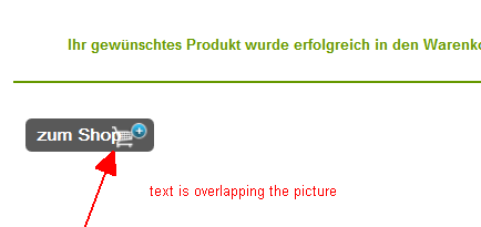

  • Posts: 11
12 years 9 months ago #134444
I hope this will be the last question regarding the card module :blush:
Where can I put more space beween the text an the icon in the lightbox?
Doesn't matter how long the text is ...it's alwys overwriting the icon and this looks bad.
(see piture)
Tom
12 years 9 months ago #134478
I don't know where come from your screenshot so I can't give you a precise answer.
But you have to increase the "margin-right" of this button so the image which is in background won't be over some text.

12 years 9 months ago #134563
Please use this in your style file
#hikashop_add_to_cart_continue_div .hikashop_cart_input_button{
	background:url(../images/style_pictureblue/continue.png) right no-repeat #595959;
	padding-right: 40px !important;
  • Posts: 11
12 years 9 months ago #134568
That's the solution ! :woohoo:
