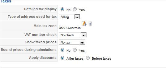

Hello guys thank you for wondreful component
at this moment testing standard.
Anyhow, I hope you can help me with my ignorance. Some product emails calculate with VAT some without. I don't want Vat and my settings were no tax so I have must missed something.

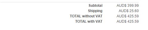

I think that you'll be able to do what you want by editing your translation file :
TOTAL_WITHOUT_VAT="TOTAL without VAT : %s"
TOTAL_WITH_VAT="TOTAL with VAT : %s"

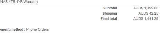

I found out where bug is. Once I put weight lower than 1kg then display on emails is different than for over 1 Strange:) but worked out.
So for example unit was 1kg it display total:$xxx
If unit was .4 kg then display on emails was Before VAT and after VAT
Never would thought that is related. I thought I let you know in case if someone has the same problem.
