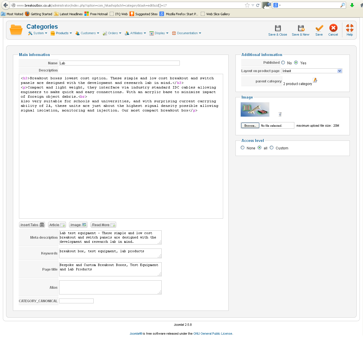

12 years 8 months ago #135474
Hi Mohammed,
I've not actually got the product in the category as far as I can tell, I've attached a print screen to make sure I'm looking in the right place. The image is large and could do with being resized, but I can't see why it should be displaying at all?
12 years 8 months ago #135487
Ok, so it was your category image, the solution will just be to edit the content menu which have the ID number 110 through "Hikashop->Display->Content menus" and set the "Show image" option to NO.
