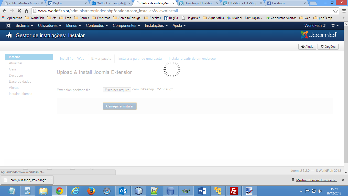

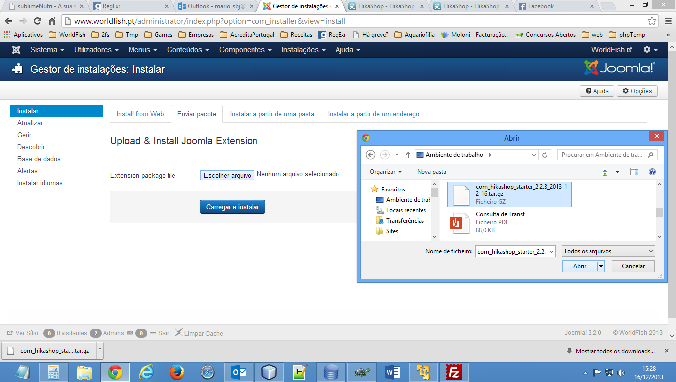

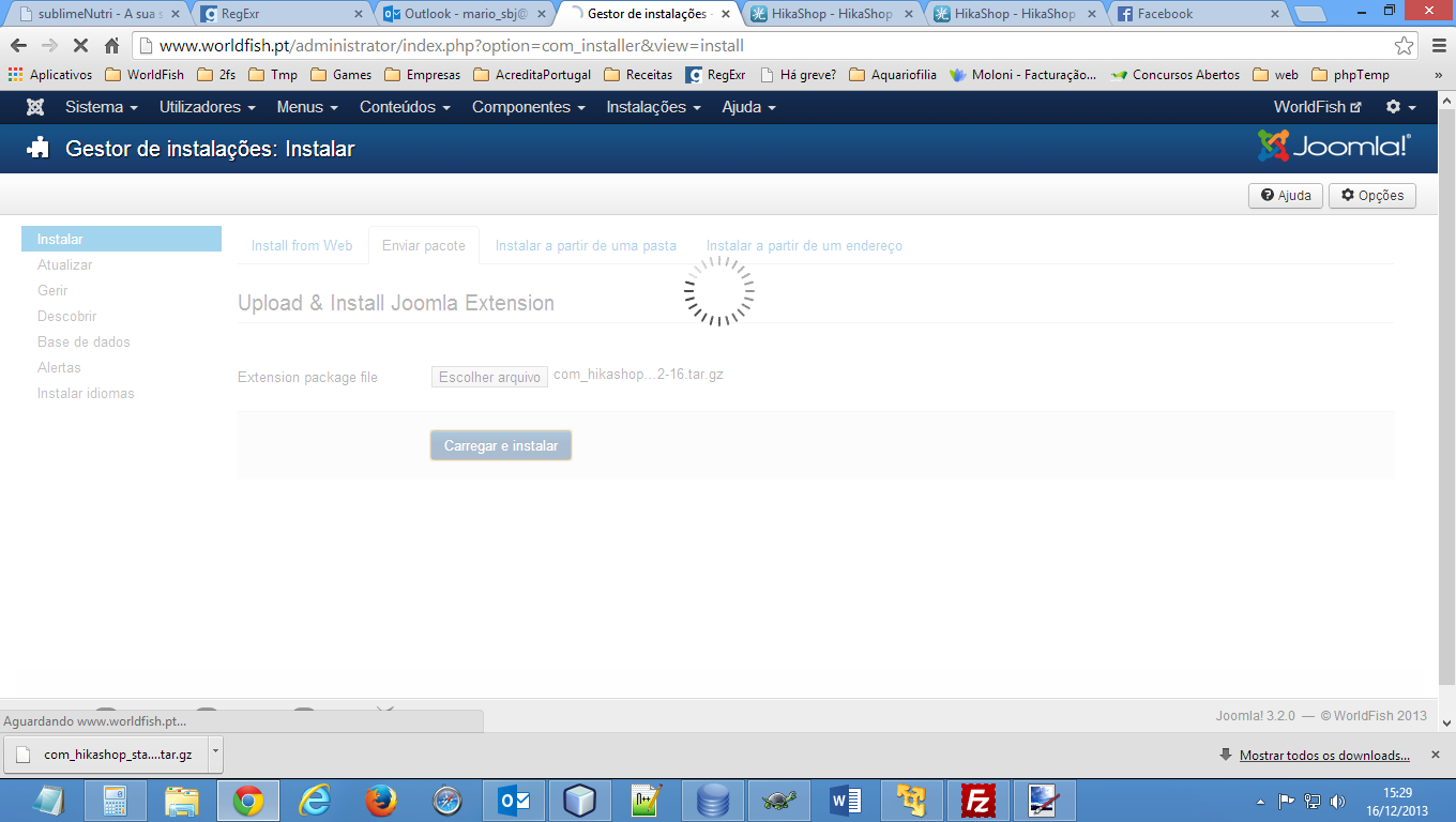

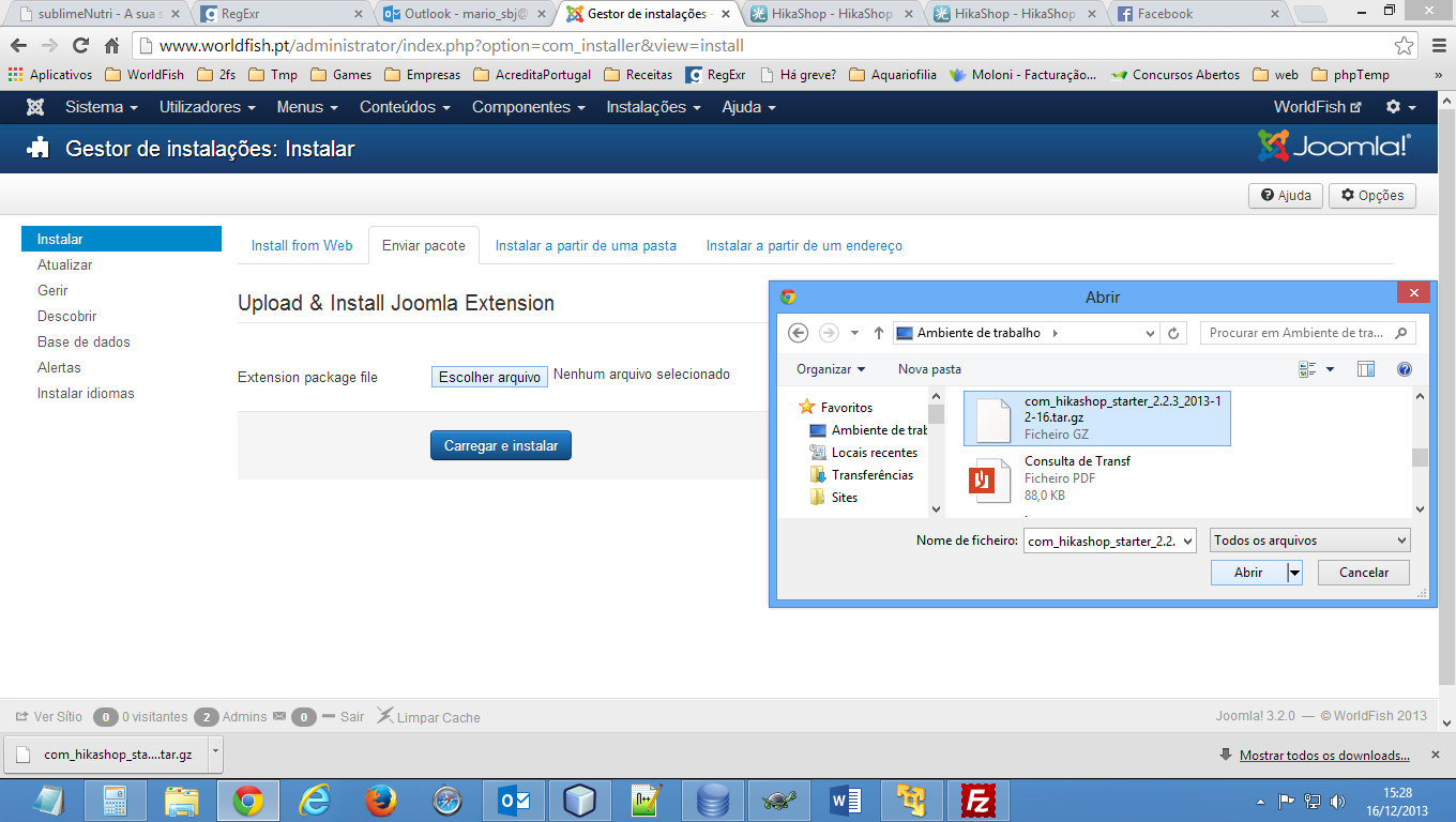

I can't update hikashop 2.2.2 to 2.2.3. I downloaded it, and then instaled.

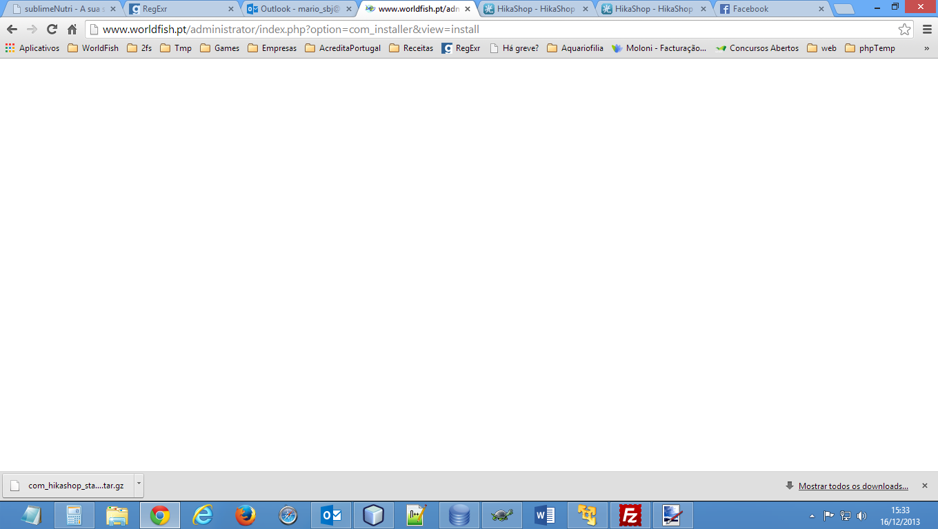

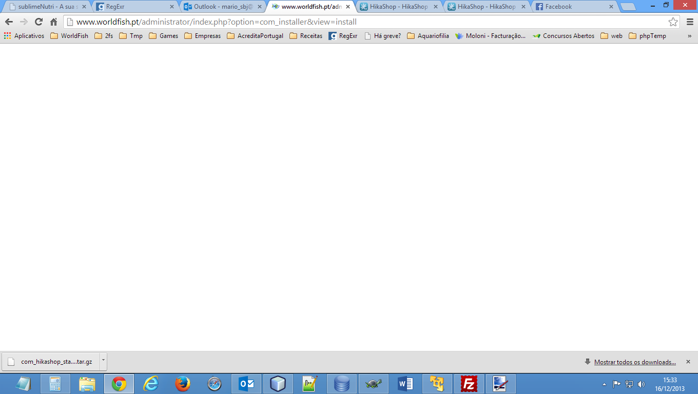

It stays about 2 minutes instaling and then goes to the page www.worldfish.pt/administrator/index.php...staller&view=install but all blank. Just white. (the favicon is the same as the front end, not the joomla favicon).
I tried from the "Instal from web" and tried from the download. It does allways the same.

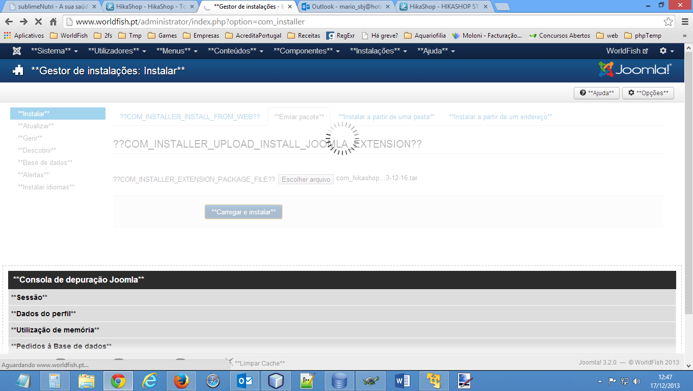

nope.. it's in debug mode and it does the same. there is no user logged, I believe the folders permissions is correct.
it looks like a time out. it's always the same time waiting.

It's probably because the Hikashop package is too big for the limitations on your web server.
Do an install via FTP in order to circumvent the limitation and that will work:
www.hikashop.com/support/documentation/5...-to-install.html#ftp
