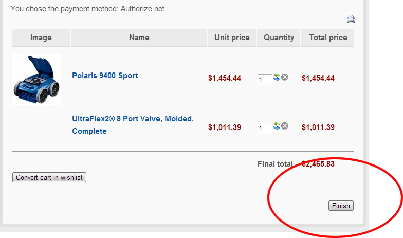

I am trying to finish the site with the checkout process and having some issues getting to the payment section. Once the customer places their information in the fields they are taken to the screen shot provided.
When we hit the finish button the screen seems to just refresh and show exactly the same information. No matter how many times you hit the finish button it still just shows the same page over and over again. Please help!

12 years 6 months ago #137304
You should see an error message in that case. If you don't, it means that your template is not displaying them:
www.hikashop.com/support/documentation/6...tibility-issues.html
  • Posts: 15
12 years 6 months ago #137425
OK, I have placed the template to the default template and can see the error message:
No shipping methods available for your location.
I have been reading threads nearly all day changing things back and forth and cannot find a solution to get rid of this error. Any help would be appreciated.
Thanks,
Jeremy Lee

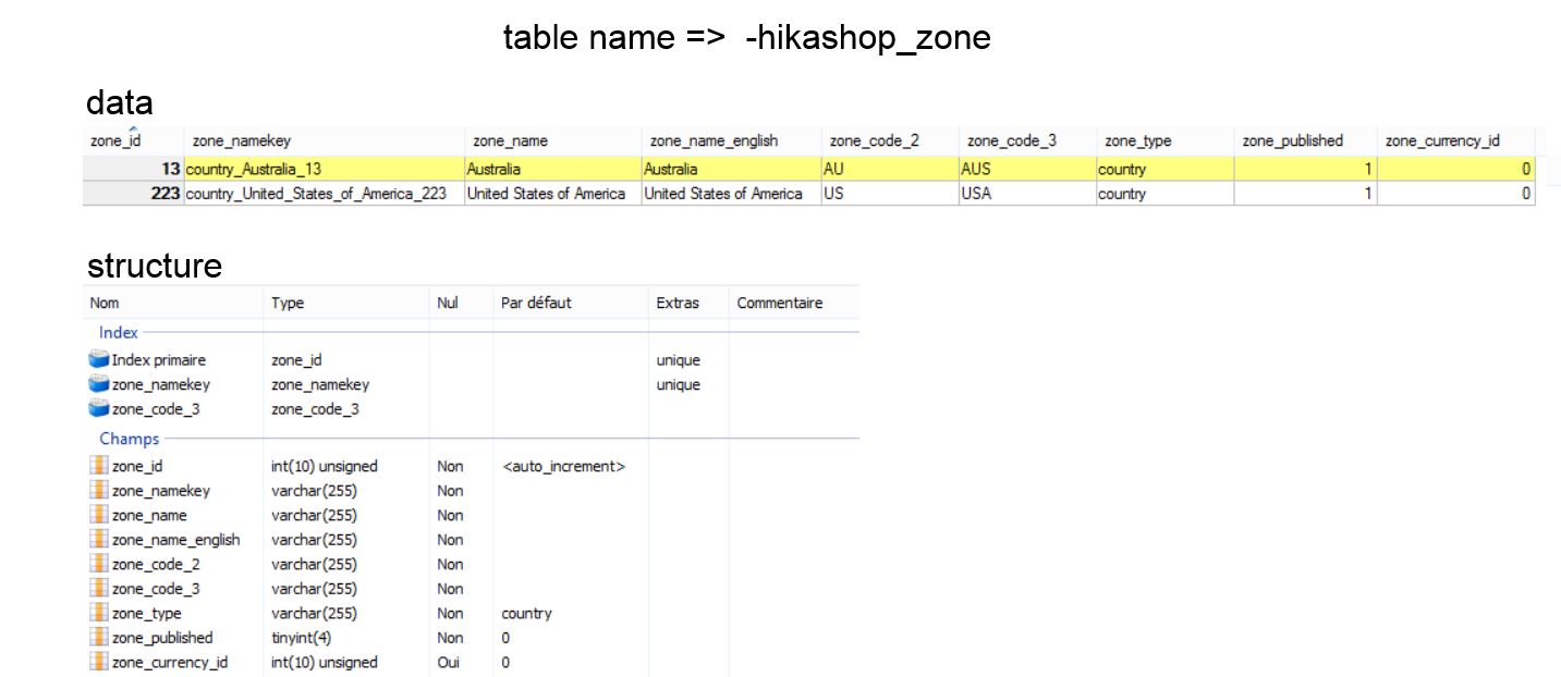

12 years 6 months ago #137458
This sentence is a variable of name NO_SHIPPING_TO_YOUR_ZONE in \language\en-GB\en-GB.com_hikashop.ini
NO_SHIPPING_TO_YOUR_ZONE appear only once in usps.php and aupost.php and shipping.php
Cette variable est appelé dans 2 plugins et 3 components administrator
en fait 2 fichiers ( usps.php aupost.php ) dont chacun se retrouve a deux endroitx différents ( soit 4 fichiers)
/plugins/hikashopshipping/usps.php
/plugins/hikashopshipping/aupostaupost.php
/administrator/component/com/hikashop/extension/plg_hikashopshipping_usps/usps.php
/administrator/component/com/hikashop/extension/plg_hikashopshipping_aupost/aupost.php
( hikashopshipping_* *= aupost | canadapost | fedex |manual | ups | usps)
et un fichier situé dans
/administrator/component/com/hikashop/classes/shipping.php
usps.php & aupost.php
le code qui rejette le pays est ad/compo.../com.../ext.. /plg.../usps.php
apparait une fois seulement
if($zone->zone_code_3!='USA'){
$messages = JText::_('NO_SHIPPING_TO_YOUR_ZONE');
continue;
le code qui rejette le pays est ad/compo.../com.../ext.. /plg..../aupost.php
if($currentShippingZone->zone_code_3 != 'AUS') {
continue;
why restrict zone for USA and AUS inside this php file
shipping.php
the logic in php is inside function &getShippings(&$order, $reset = false) { }
the php code is
if(empty($rates)) {
if(hikashop_loadUser())
$errors = JText::_('NO_SHIPPING_TO_YOUR_ZONE');
$this->errors = $errors;
return $usable_methods;
the hikashop_loadUser is define in \administrator\components\com_hikashop\helpers\helper.php line 391
function hikashop_loadUser($full=false,$reset=false)
user come from
getUserState docs.joomla.org/API17:JApplication::getUserState
getUser docs.joomla.org/JFactory/getUser
hikashop_get('class.user')->getID($userCMS->get('id')
So why the message error is not more specific to this logic since not only rates is test but also user ?
version
Does the joomla version 1.5.26 or php 5. something you use could be the problem ?
since i open mind i write version question .....even i think hikashop must test all way to test user/rate refer to joomla API version !!!
Is there a hikashop API with the same layout that the one we can find for joomla ( information about all object type : data / function ) ?
docs.joomla.org/Accessing_the_current_user_object
docs.joomla.org/Category:Frameworks_and_Platforms
regard's
Last edit: 12 years 6 months ago by lionel75.
  • Posts: 85761
  • Thank you received: 14068
12 years 5 months ago #137506
The error "No shipping methods available for your location." means that your shipping methods restrictions are not setup properly and that based on the restrictions of your shipping methods and the content of the cart/address of the user, the system couldn't find a suitable shipping method.
An easy solution is to just remove the restrictions in your shipping methods. You'll then see them. Then, you can start from there and make sure that you cover all the possible cases (all the conbinations of weight ranges for all the countries in the world for example) with your shipping methods.
