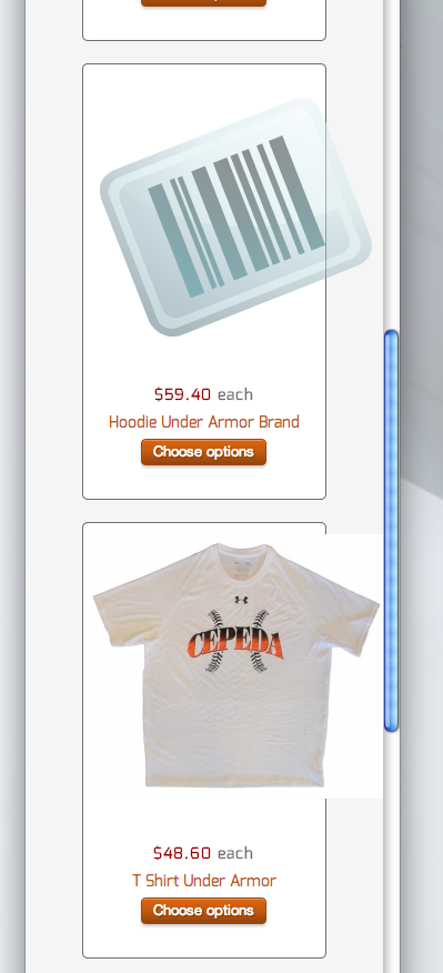

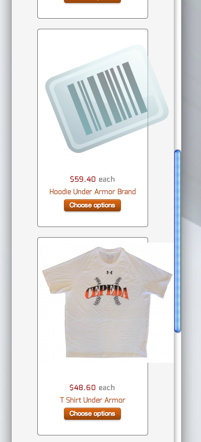

The template I am using is by rockettheme called Rt_chapelco, and it is responsive and using bootstrap. The images throughout the site change size automatically at the brows changes size but not in the hikashop store. I have enabled the Use bootstrap design radio button in the display tab of the configuration, is there something else I am missing? Why don't the images change size in the store section of the site?

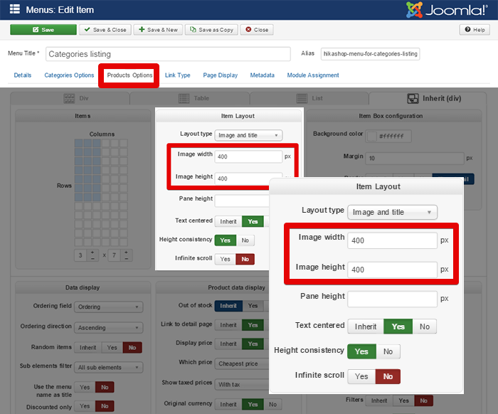

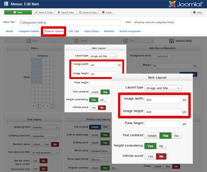

So, can you check in your Item Menu configuration, if you have some image size configuration ?
In Menus => Main Menu, and select your concerned listing, then go in Products Options tab :
Here, if you have some size configuration that will "break" HikaShop responsiveness, and so maybe add Css order won't be required.
Awaiting news from you.

Thanks so much for your detailed response. Both of those size boxes are empty. I have noticed, though, that there is an element style applied to the image which is setting the width manually - I must have missed that before. I'll track that down, get rid of it and get back to you.
Thanks.
